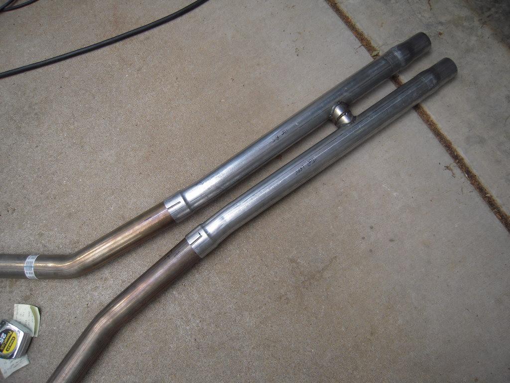

UPS just dropped off the mild steel CJPP H-pipe. Shipping was fast and dealing with CJPP was great, but upon inspection wanted to give a heads-up to anyone on the fence about buying one of these. Looks like a very nice piece externally - crossover welds look very nice.

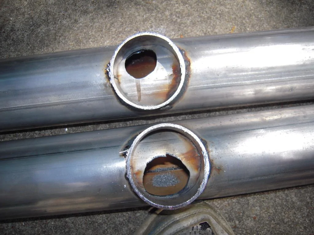

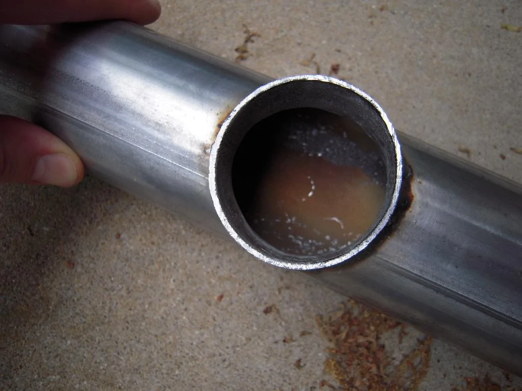

Now the bad - the crossover holes made inside the long pipes appear to be roughly cut via plasma cutter and only about the diameter of a quarter or so. (Kind of hard to tell exactly looking down into the pipes with a flashlight.) There's also some welding slag inside one pipe I'll have to grind out. I'm thinking the benefit of the "H" will be minimal over just running 2 independent pipes with no crossover due to the restrictive hole sizes.
I'll probably cut the H in half, grind out the holes to the diameter of the crossover, then weld it all back together. Sigh, the point of paying $100+ for this piece was to avoid having to fab up something from say the Summit $45 kit, but my OCD is going to get the best of me here.

That's the one. No, other than the minor slag that's in the flow, the H-pipe will be basically like have 2 separate straight pipes. i.e. maximum flow. The question is how much sound benefit the tiny crossover holes provide. In theory, the H is supposed to balance the two exhaust paths and cancel a lot of the sound, deepening it in the process. My point is that with the small holes, the quietening benefit will be minimized, but the flow will not be harmed. Make sense?
Now that I've thought about it a bit, I'd still recommend this piece - it's the cheapest bolt-in I could find, but know that the sound benefit of the H crossover is mimimal. If the steeda one, for instance has a cleaner cut through, it might be the better buy although a bit more expensive. The stainless one CJPP sells might be manufactured differently as well, so that might be a worthy upgrade. Not having the benefit of examining these things in person, it's hard to say.

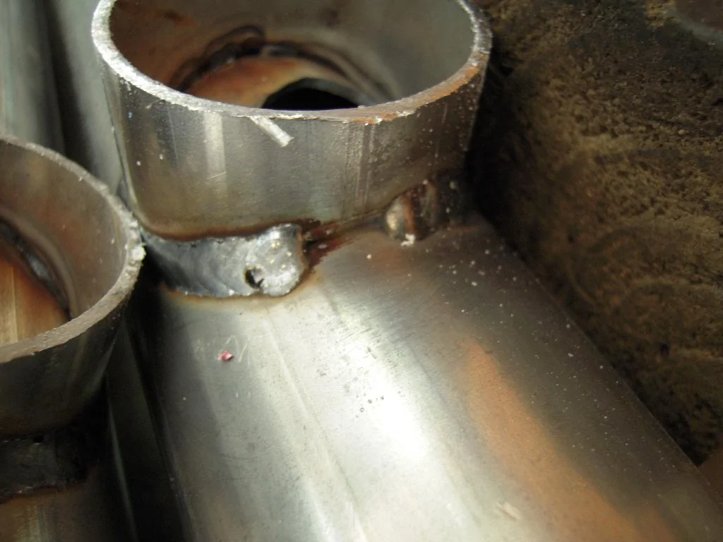

Tore into this thing today and definitely would not buy this part again. I hadn't noticed, but one of the welds didn't even go all the way around the pipe - this thing would have had a whistle of an exhaust leak. What a mess. Anyway, we split it in half, ported out the crossover then welded it back together. Spend a little more money and get a nicer one.
BTW, I weighed the H-pipe and the stock suitcase - the H with the clamps only saves *6* measly pounds over the suitcase, not the 15 advertised. As others have pointed out, the suitcase is straight through... looks like 2 glasspacks tied together.
