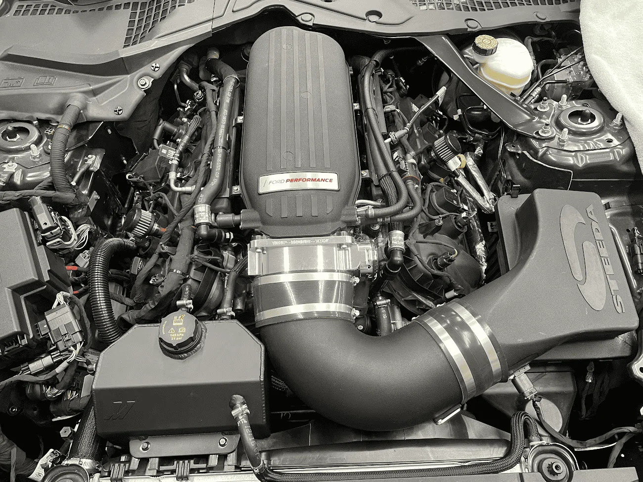

I have what you seek... also a 2019 except I use the stock injectors. No reason to put 1050X until you go boost. You will have to upgrade your whole fuel system anyway and installing injectors is super easy compared to what it takes to install the cams.
