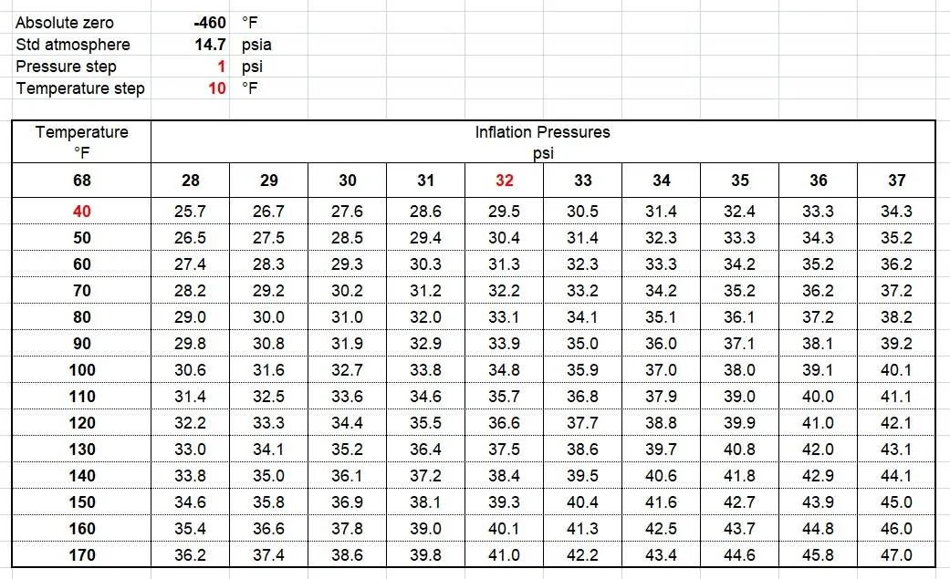

Both this table and the Wiki article discuss PSI vs. outside temperature, not internal tire temperature. That’s why I asked about the importance of internal temperature.
Those are internal temperatures, because it's the temperature of the contained fluid that matters, not the outside ambient. The tables are based on pressures measured at 68°F and heated/cooled from there. What is being assumed is that the outside atmosphere remains at 14.7 psia (a good enough assumption for us but perhaps not for Formula 1).
