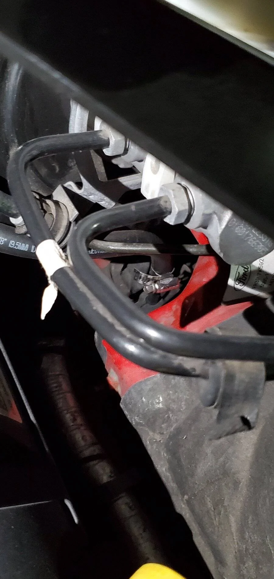

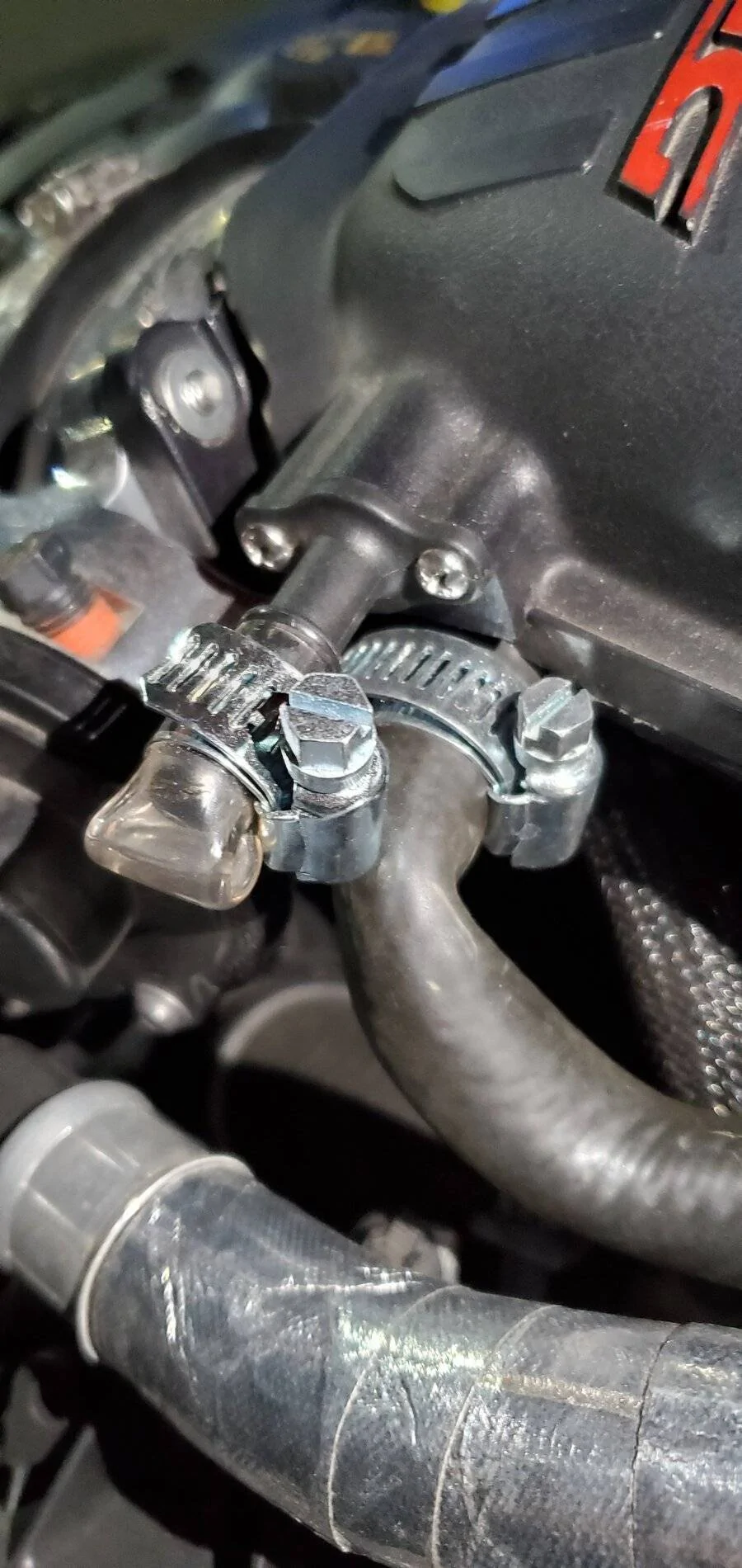

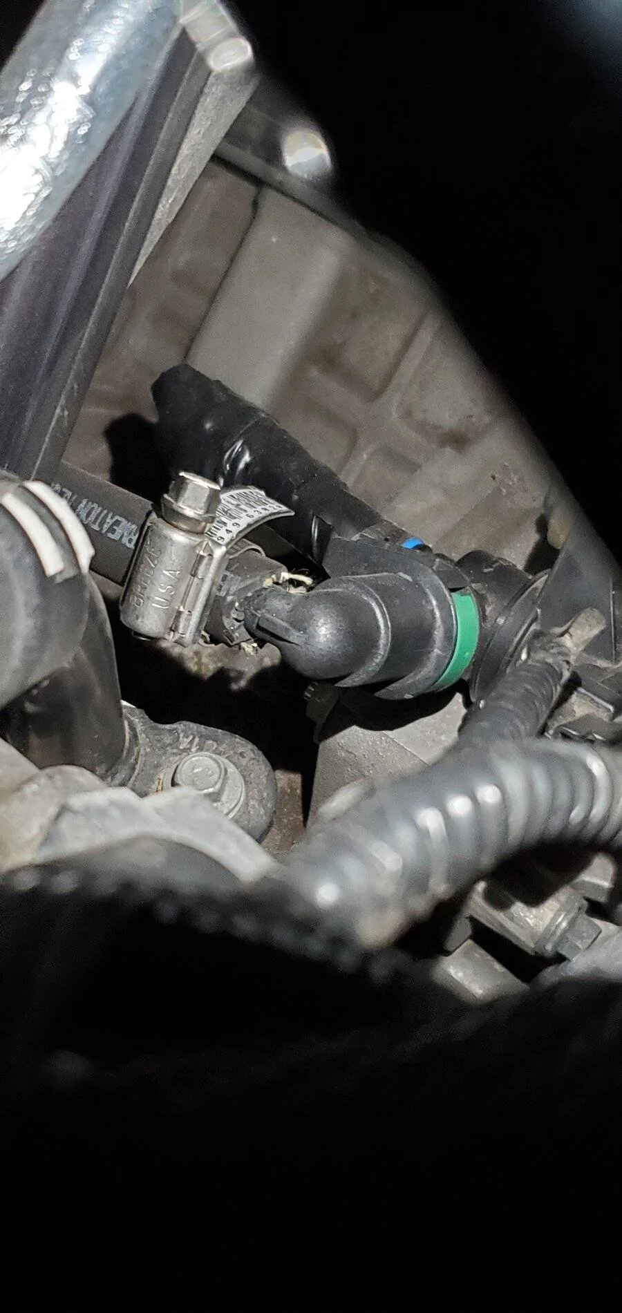

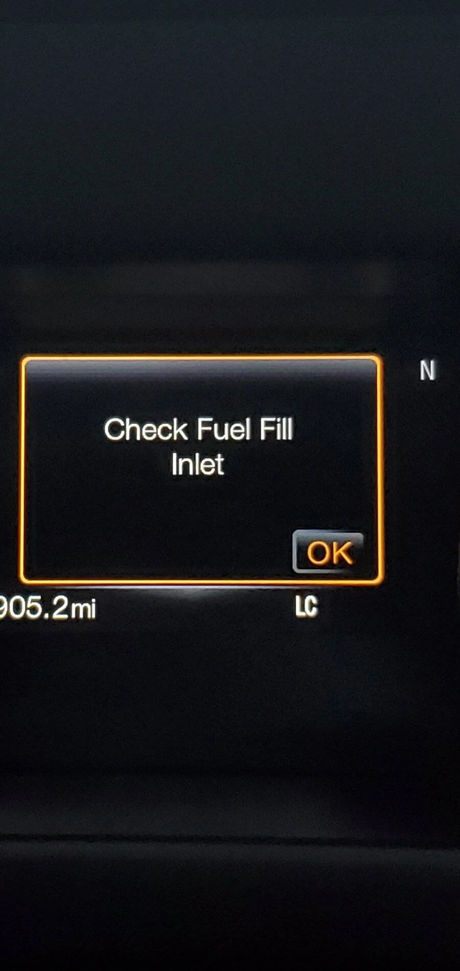

Hi guys,
I've been having this problem for a while now, Ever since I installed my cobra jet manifold and been on E85 , I've been getting this message pop up every 3-4 weeks, since I clear it by getting seafoam and putting on the funnel cup tip that comes with mustangs and sticking it in the gas inlet (where you pump gas) rapidly to clean it and then remove the battery since im not getting a CEL or codes thrown and it goes away for about 3 weeks and comes back but im getting annoyed of doing this, anytips?

Did you do a EVAP delete ?

That EVAP purge solenoid needs a vacuum source.

Well.. How'd it turn out ?
Einstein_nikola
Einstein_nikola
Jun 20, 2020
46
320
89
Chicago IL
Sir Galahad
2015 Mustang GT PP

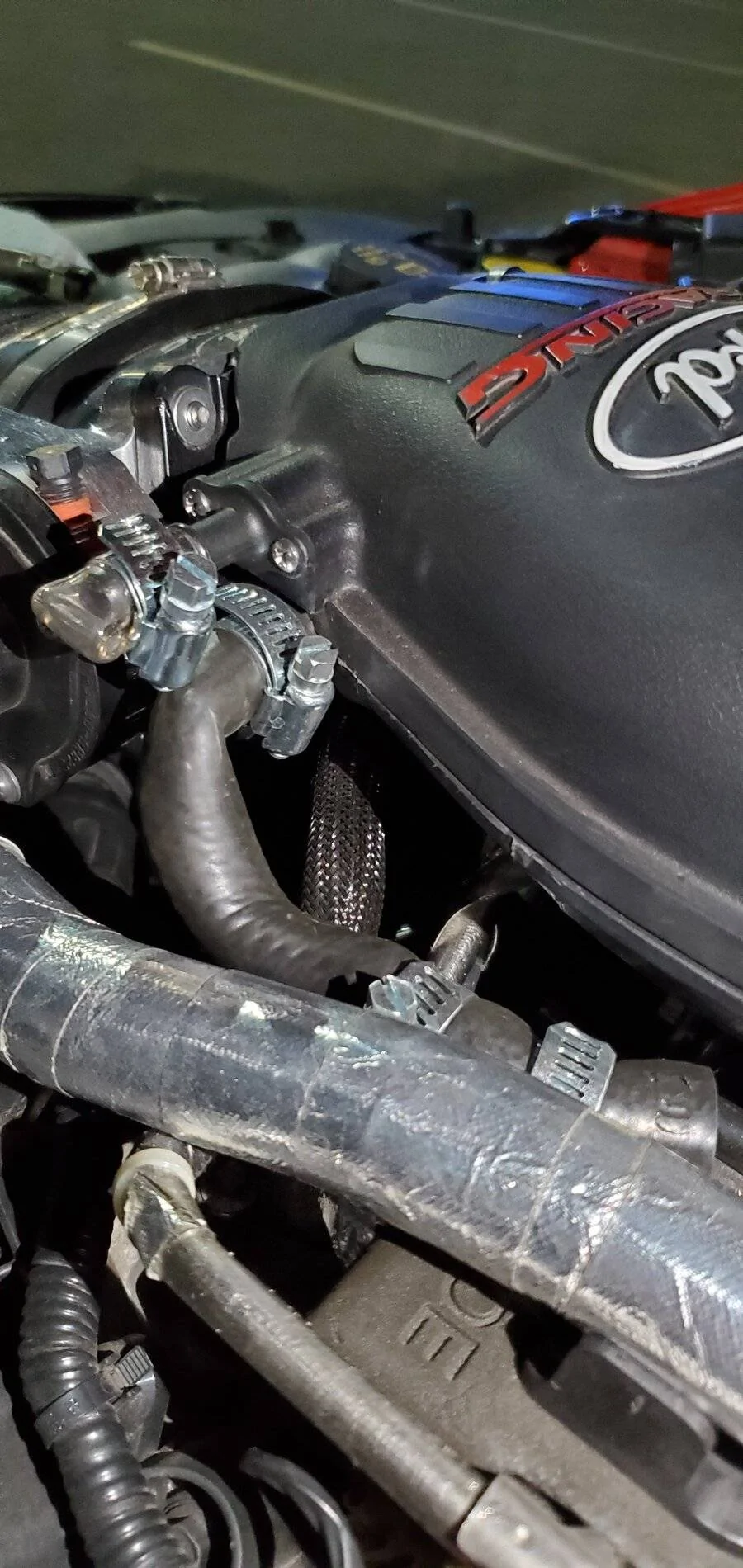

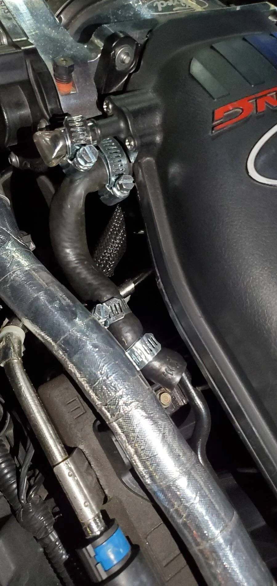

I got a 3/8 hose and i gotta wait for like 2 weeks to see if it will come back or not, so far it has not but typically it takes 2-3 weeks for it to show up but ill keep you posted😎
