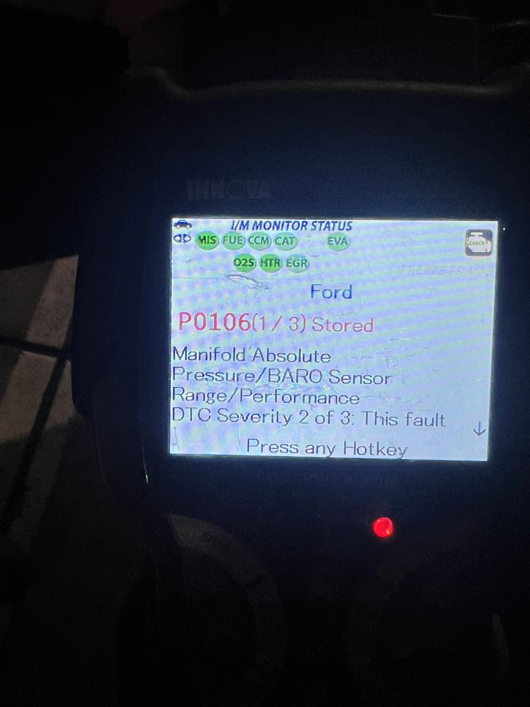

I have a 2020 gt500 and the wrench light come on once in a while when I gas it a bit due to the check engine light being on just wanted to know if anyone else has ever got this code and what was causing the problem I honestly don’t have time to take it to the dealership maybe someone can help me. I changed the map sensor that is next to the intake still feels the same nothing changed car lacks on power it’s almost as if the supercharger isn’t even working maybe it’s the sensor on the back of the sc I need to change ??

Check the supercharger pulley for excessive dust/dirt build-up on/around the pulley. I suspect that the clutch on the pulley may have failed. It’s common. It’s a warranty item.
