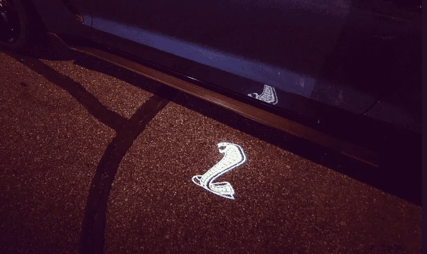

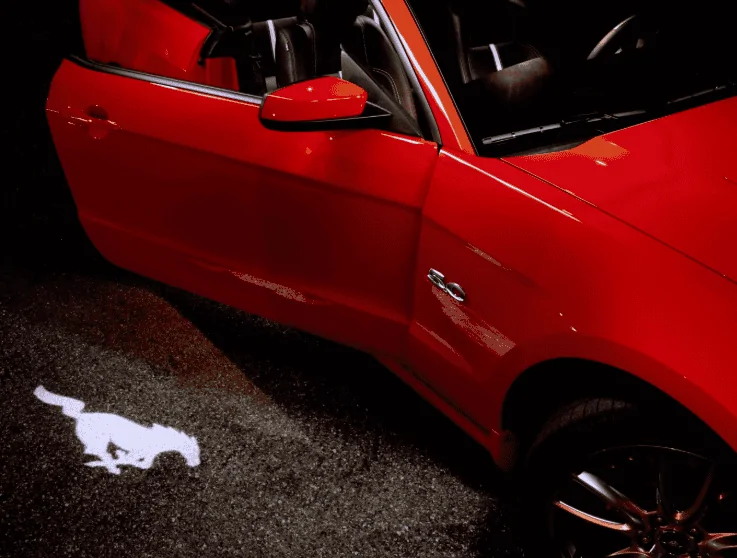

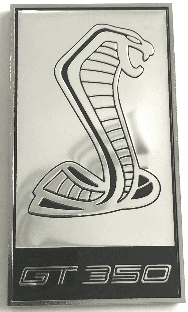

Hello,
I there any way to change the Pony to the Cobra/Shelby Design?
I don't mind changing the side mirrors if necessary?
Like this for example;
If the design like this; even BETTER;

yes, just swap out the puddle lamps for the gt350 ones
Just seen the post above after my post. Guess not - but I would think it would swap

The cobra projection lamps are. KR3Z-13B374-A (right) and KR3Z-13B375-A (left)

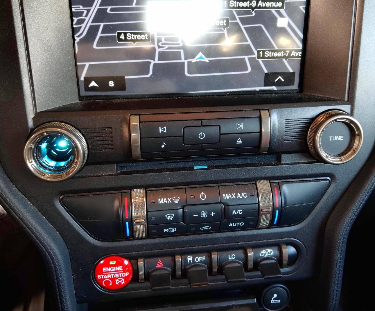

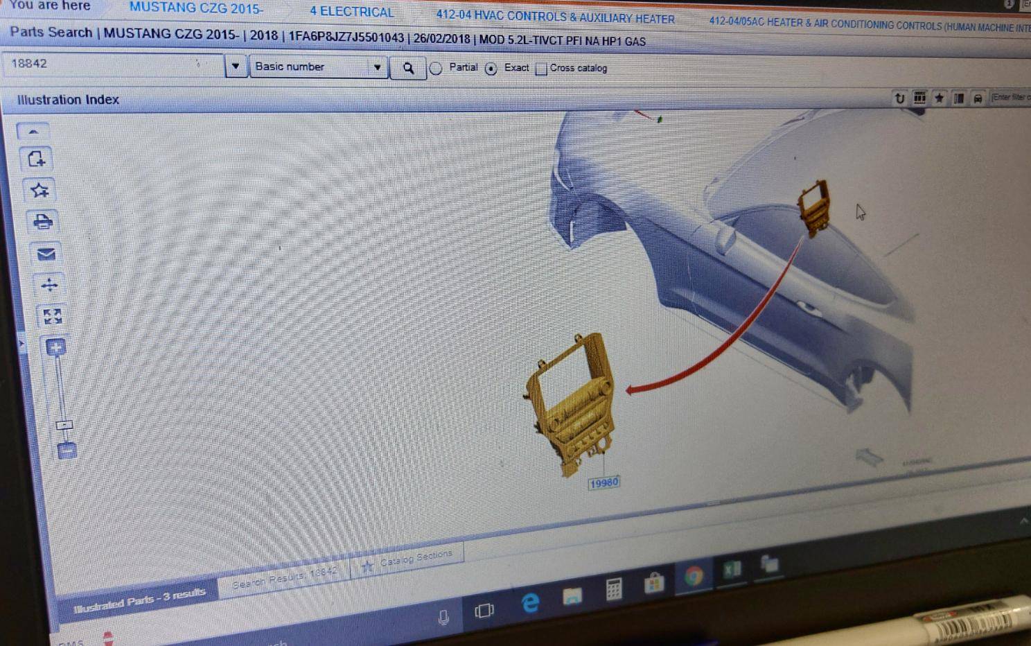

Call ANWBL back and ask about the knob...
Any reason to replace the whole panel?
Sorry for the ignorance, but what is ANWBL?
I asked about the panel no. because of "Ford Parts" in my country only sell the whole panel, & it's out of stock!
