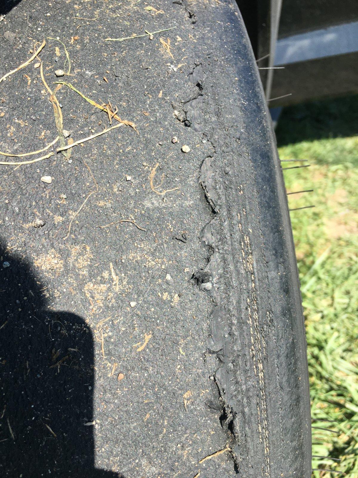

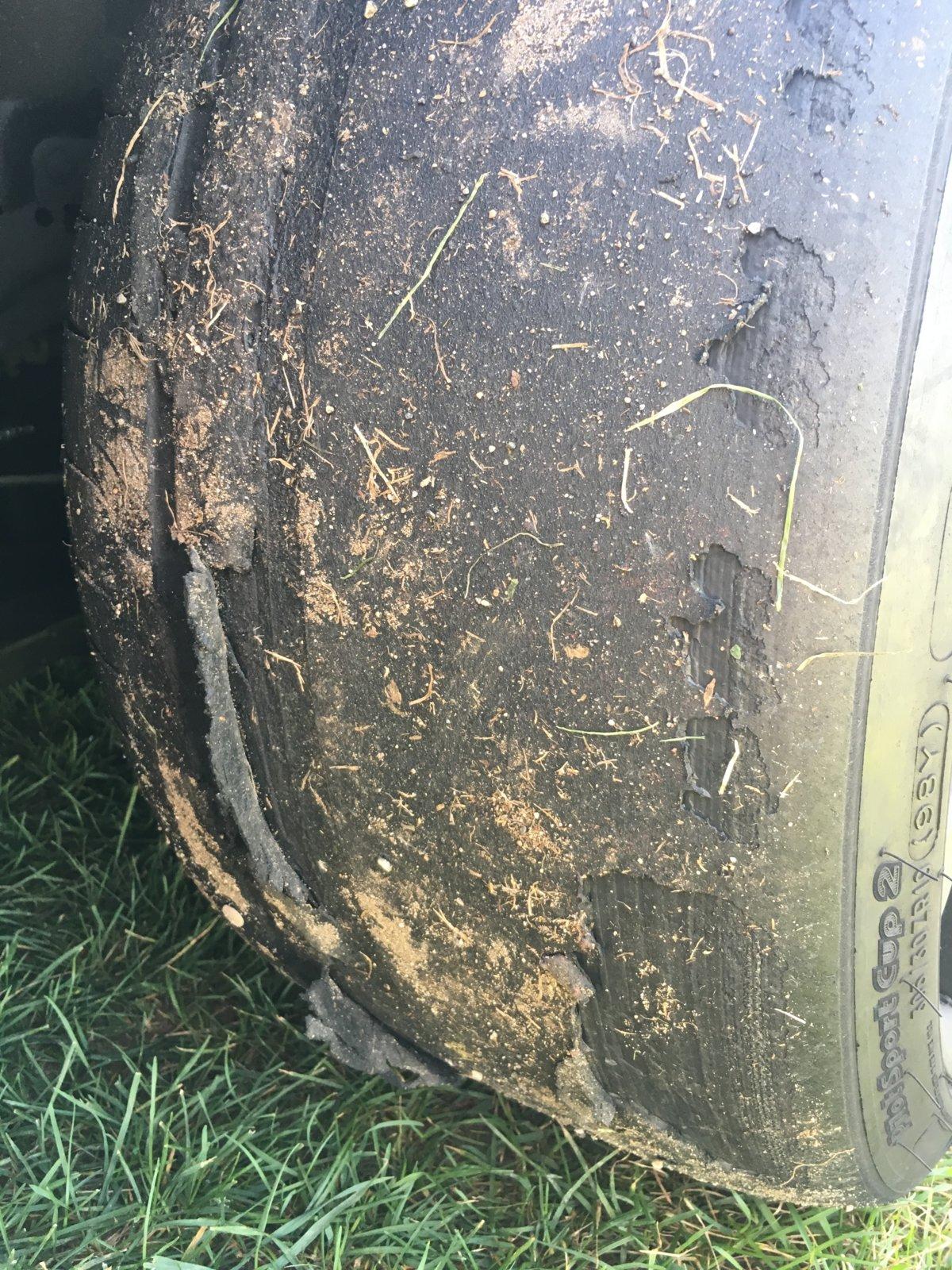

My fronts both chunked half way through the fifth session, albiet one was 2/3 in the rain and the final was at Waterford hills which was the last day before they repaved it and it was Very rough with concrete apex’s is why I figured they chunked. However, as I swapped left to right they both chunked and chorded at the same time and 4 full aggressive track days (5 20 min sessions) seems all we can expect out of oem cup 2 is my thought.
As for turn in, I was just curious if it’s a big deal. I’m not timing myself and don’t know how much it will improve things. As it is, I’m generally too fast as is and constantly on peoples ass waiting for passing zones to the effect I really don’t like doing non full open passing events anymore.
Pics are front left and right. I’m just still on the fence if I want to deal with the pita to diy for $250 or probably cost $500+ for a dealer to install these bc im too lazy! The car is damn good stock!

Based on the wear of those tires, I'd bet you'd get at least another full day out of the fronts. Lots of inside tread available! Benefit of turn-in is hard to gauge without seeing your driving style and the types of tracks you drive.
I have done that in one day :)
