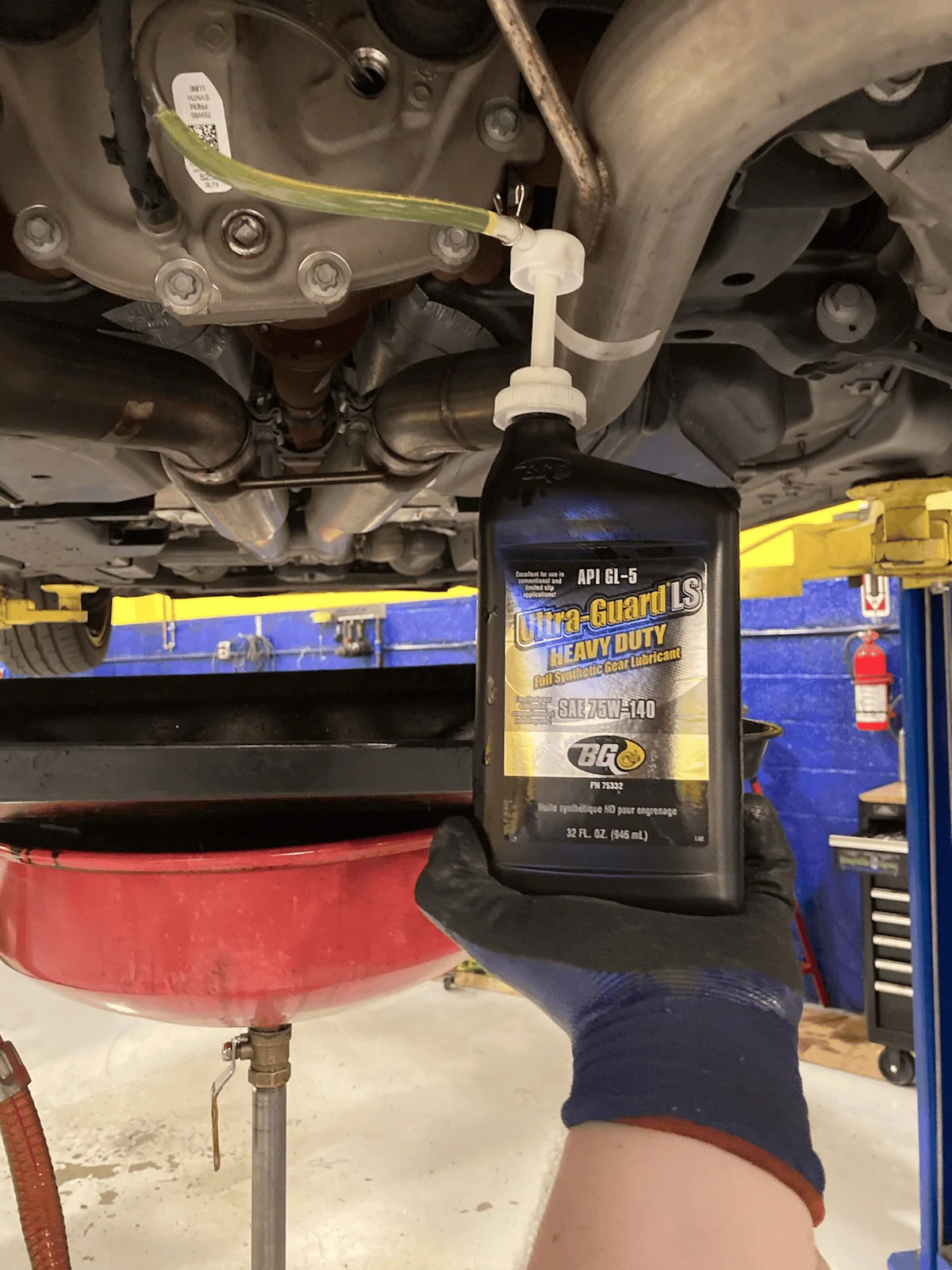

After a lot of research on here, I settled on the BG Sychro Shift II/LS Guard differential fluid. I did email BG directly to confirm the Synchro Shift II fluid met Ford spec, in case it ever came into question. I went with the 75w140 due to the hot Florida summers and the fact the exhaust is constantly baking the rear diff.

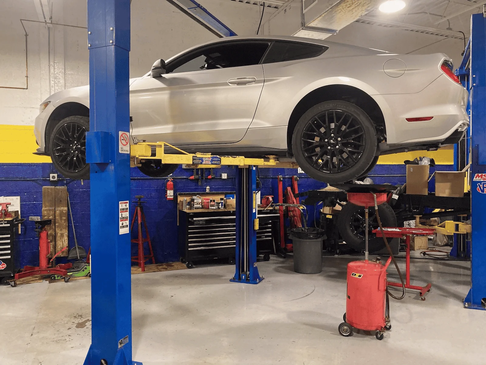

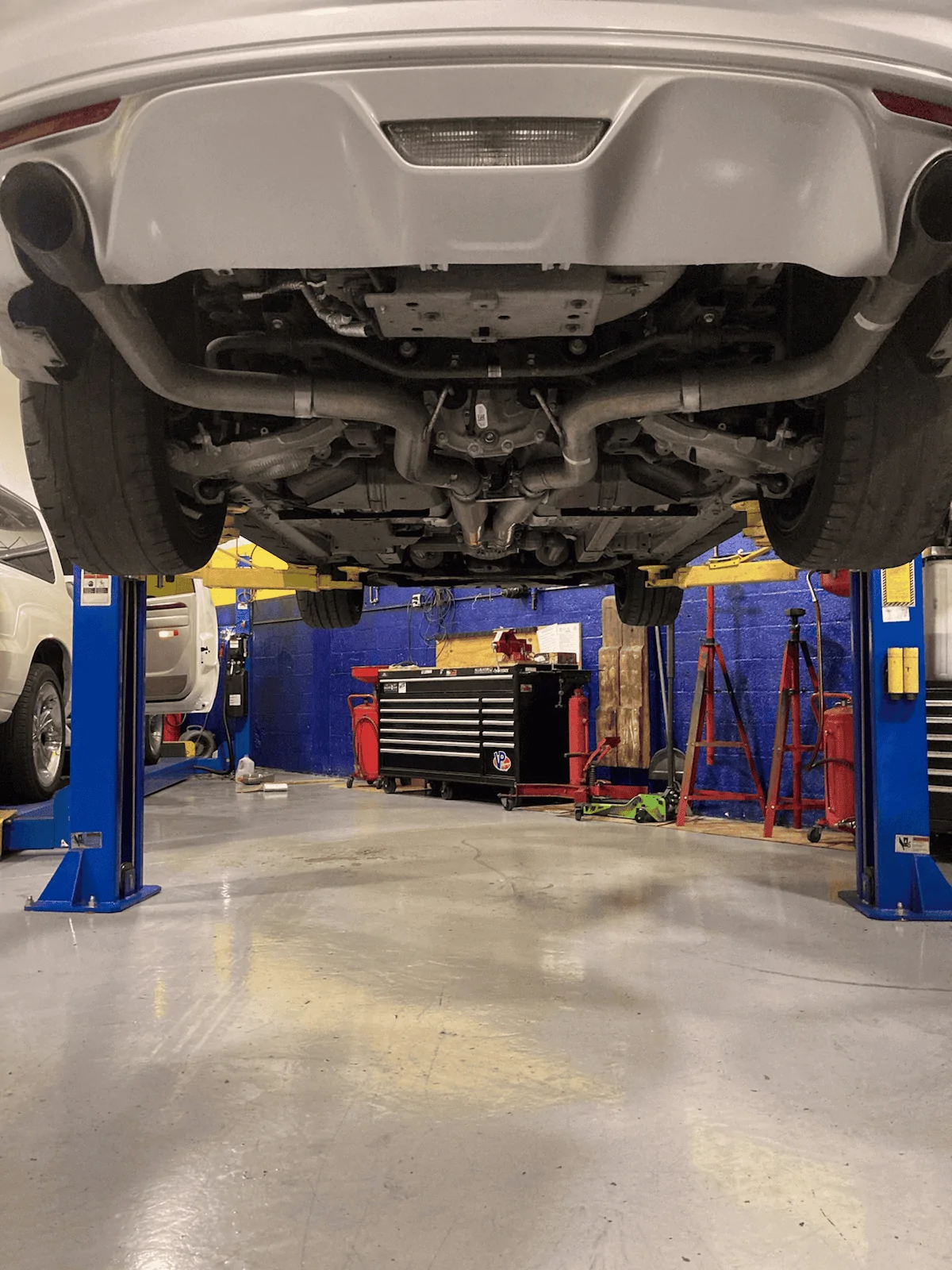

I rented a lift at a local garage to do the dirty work, which was a pretty sweet experience. The kit OP puts together has instructions for both the trans and diff, pumps/hoses for the trans and diff, thread tape for the diff drain/fill plugs and is packaged meticulously. The shop owner was equally impressed.

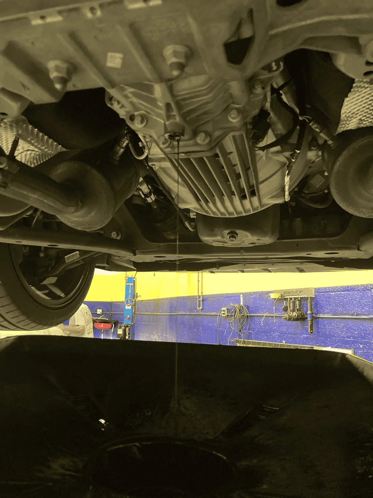

The service itself was super easy with the car in the air. I was surprised by the fact that both fluids looked pretty good coming out (40k, original fluid). The trans fluid was a little dark and man that stuff is thin.

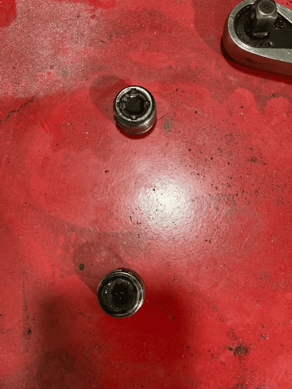

Remove fill plug, 3/8 ratchet
Wipe debris from plug/magnet
Remove drain plug, 3/8 ratchet, allow fluid to drain for 5-10min
Use 2-3 wraps of thread tape (per instructions) on drain plug, wipe plug area clean, install plug. Torque to 25 ft lbs.
Fill fluid to capacity - you'll want a pump/hose for this, there's no way to get the bottle anywhere near level do let gravity do the work.
Use 2-3 wraps of thread tape on fill plug, wipe area clean, install plug. Torque to 25 ft lbs.

Remove fill plug with 8mm allen key - space is tight, there's only one way to fit it. Prepare for a little dribble of fluid depending on how full the factory fill was.
Remove drain plug (8mm allen), allow fluid drain for 5-10min
Wipe excess fluid/debris from plug area, re-install drain plug (no thread tape).

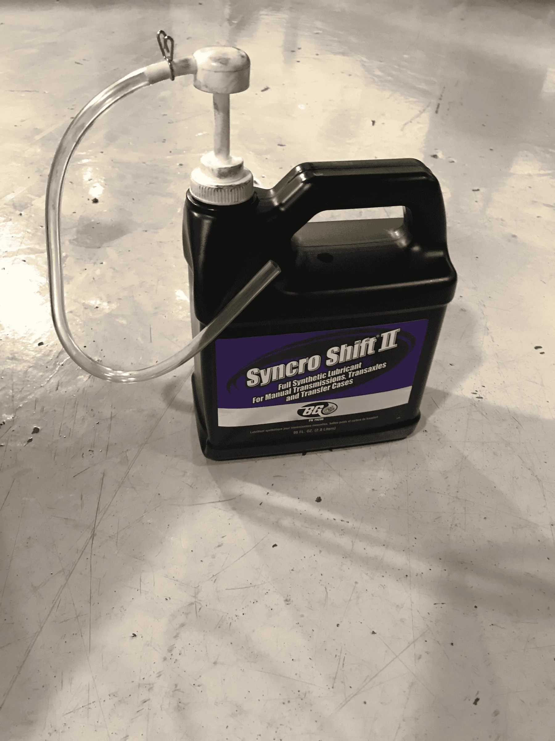

Using pump/hose fill transmission to capacity.

200 pumps on the trans fluid bottle to get it full.
I counted.........
I counted.........
LOL yeah there was a lot of pumping involved. The diff fluid was way worse just because of the viscosity. Got a good bicep workout in lol.
