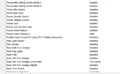

I want to change the power timeout on the front power points below the infotainment center. I have Forscan and I know the module/line to look for....
12v Powerpoint Timeout (Default)BCM726-39-01 : 1194 xxxx xxxxEnable (Default-74 minutes 44 seconds)
I know that if you change the 1194 to "0001" they shut off when you turn the car off, but I'd like to set it for something like 15 minutes. All the sheets I can find reference another calculator sheet... but it looks like that's been deleted from Google Docs.
I tried converting 1194 (hex) to decimal (4500), and that is close but isn't exactly the same as the 74 minute, 14 second default time (4454 seconds). Anybody know the correct way to set a new value?

open the BCM config (not the as built version), human readable with a newer version of forscan

i happened to find a recording i took, i'm assuming this timeout has predefined values.
