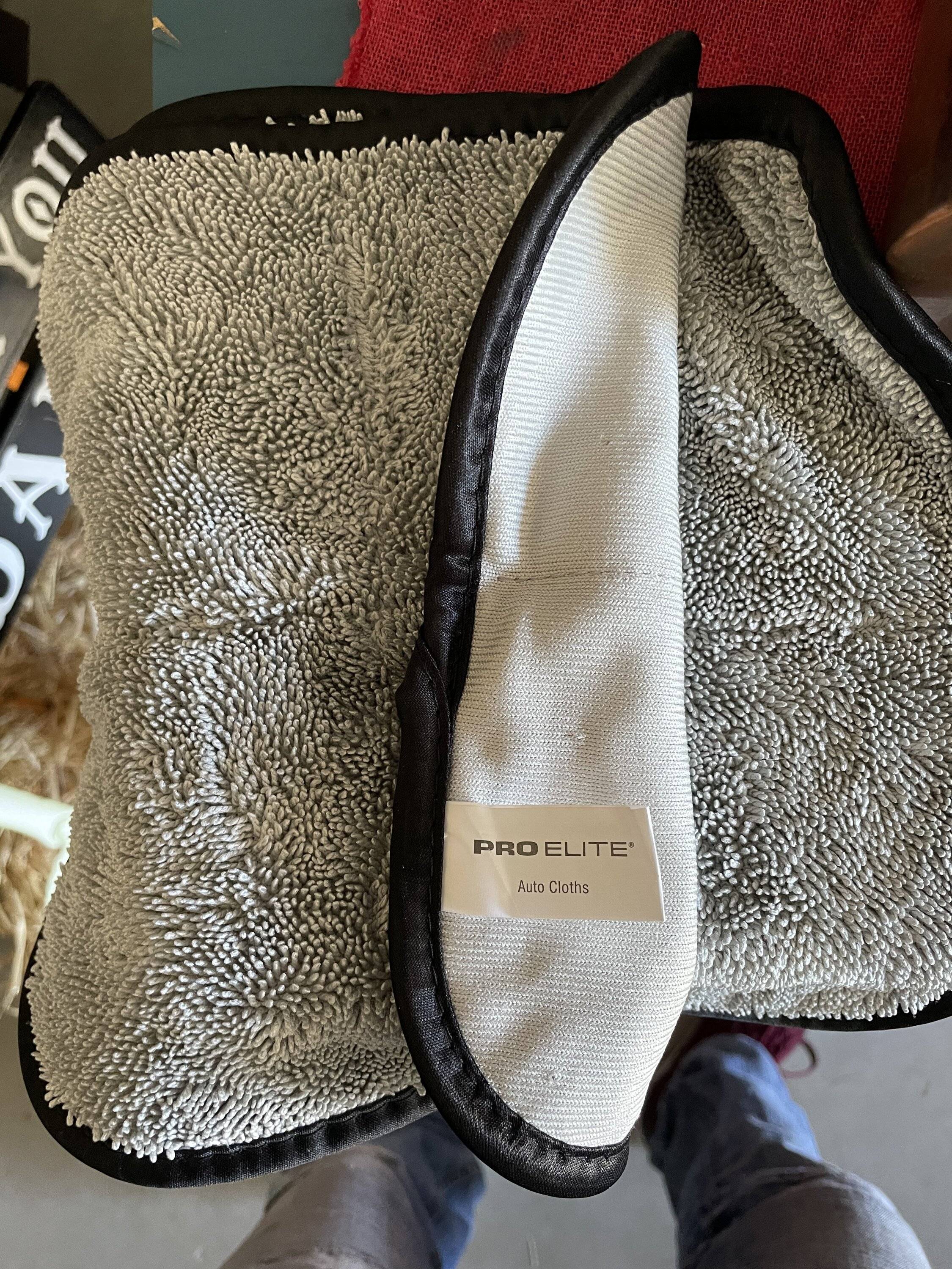

you are winner winner chicken dinner! I used isopropyl alcohol and a Pro Elite windshield cleaning cloth… 3 minutes later… all gone
thanks to all that responded and helped
