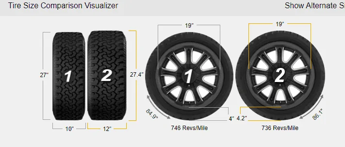

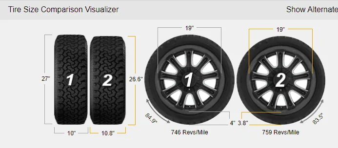

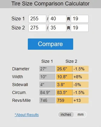

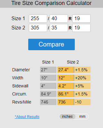

/me SMH
I should have looked for this. Thanks guys!!
FRONT TIRES (OLD and NEW)
REAR TIRES (OLD AND NEW)

So basically the distance between the bottom of the front bumper and the road (with the 0.5" Steeda drop + the new tires) should be just a smidgen below 1" lower than the stock.
Time to bug the guys with the GT500 front bumpers on their GT Premiums (who are not lowered) and see what the distance is. Need to still be able to drive this thing around town without hitting the front end every time I go over a bump.
