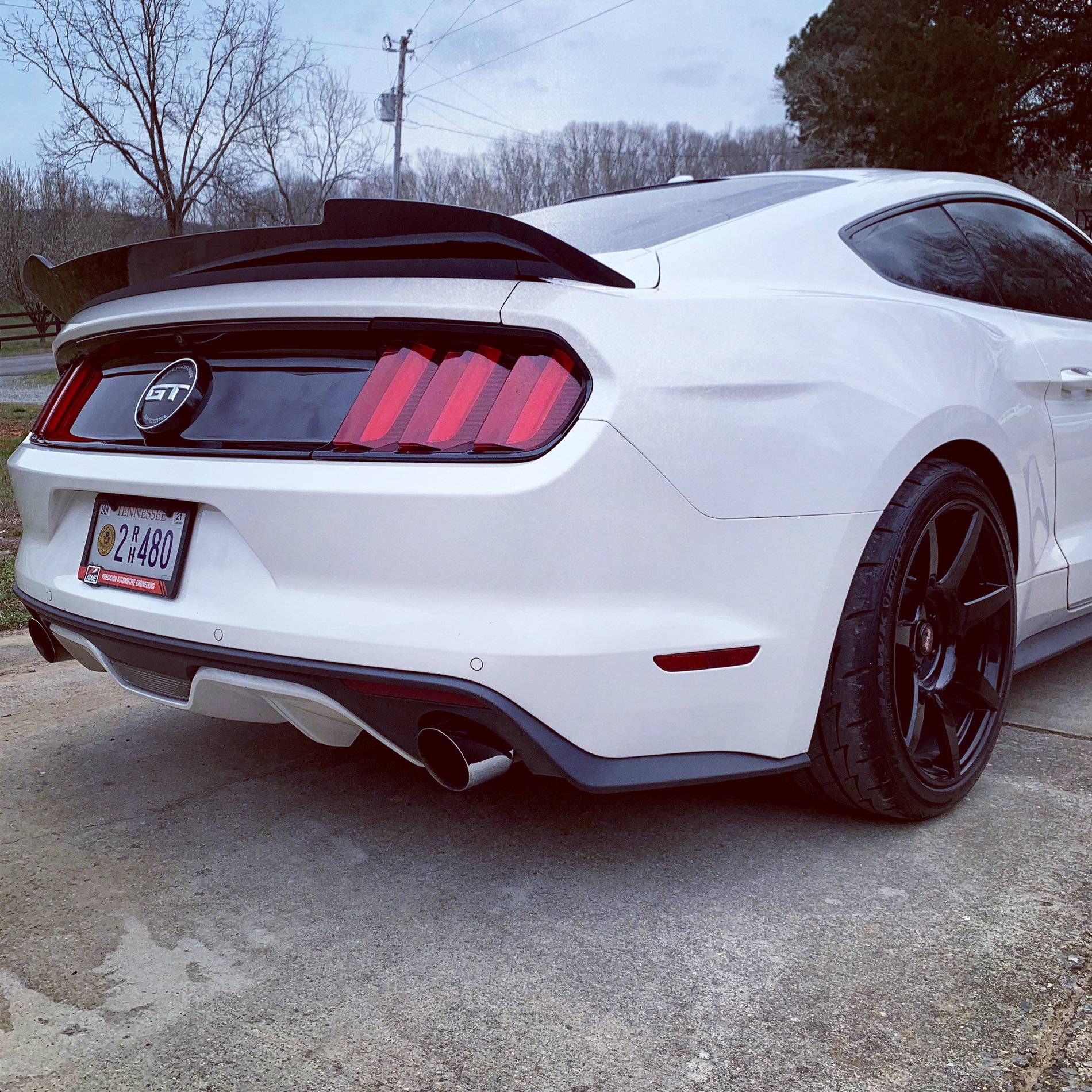

So I just replaced my CS Spoiler with the MMD Vseries. No holes show, but there are holes that are uncovered underneath the spoiler you can plug off, but they won’t show. Looks great. Recommend 110%.

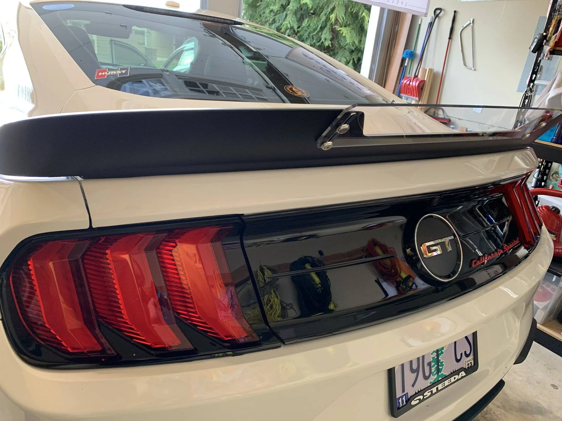

Was just helping out on GT/CS alternatives. The issue is the GT/CS is an odd drilled pattern which leaves different hole pattern than the rest of mustangs that come with factory spoilers, the GT/CS unfortunately has two higher up screws on each side and several aftermarket spoilers end up not covering the holes and they are left exposed. Only expensive option is get a spoiler delete trunk and start from scratch or a non GT/CS factory spoiler trunk too use the common pattern, or pay extra to plug it in as nicely as you can. However some have enough foot print on the trunk flat area to extend over the top side holes, thus eliminating any worry of changing spoiler or covering exposed holes outside new spoiler area. Some want something else over the GT/CS spoiler that came on our GT/CS trunks.
Yes. The spoiler I installed covered the 2 odd outer holes
