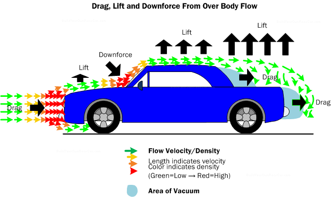

This is a simple image I found of pressure zones around a vehicle.
The front of the hood is high pressure zone so there would be very little air going on. The grill and the back of the hood by the cowl are low pressure zones where air would go in.
Not saying nothing goes in, but it's hardly what I would call "ram air" in that spot.

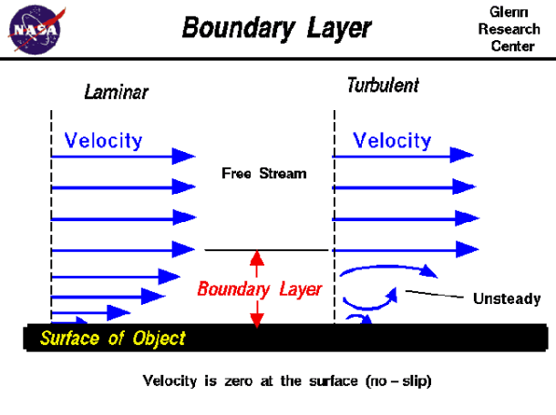

Thanks for that ! But I was specifically talking about the height were the slower moving air hugging the surface of a car gives way to the faster moving air about the car. I remember reading somewhere it was 2-3 inches above the surface ?
