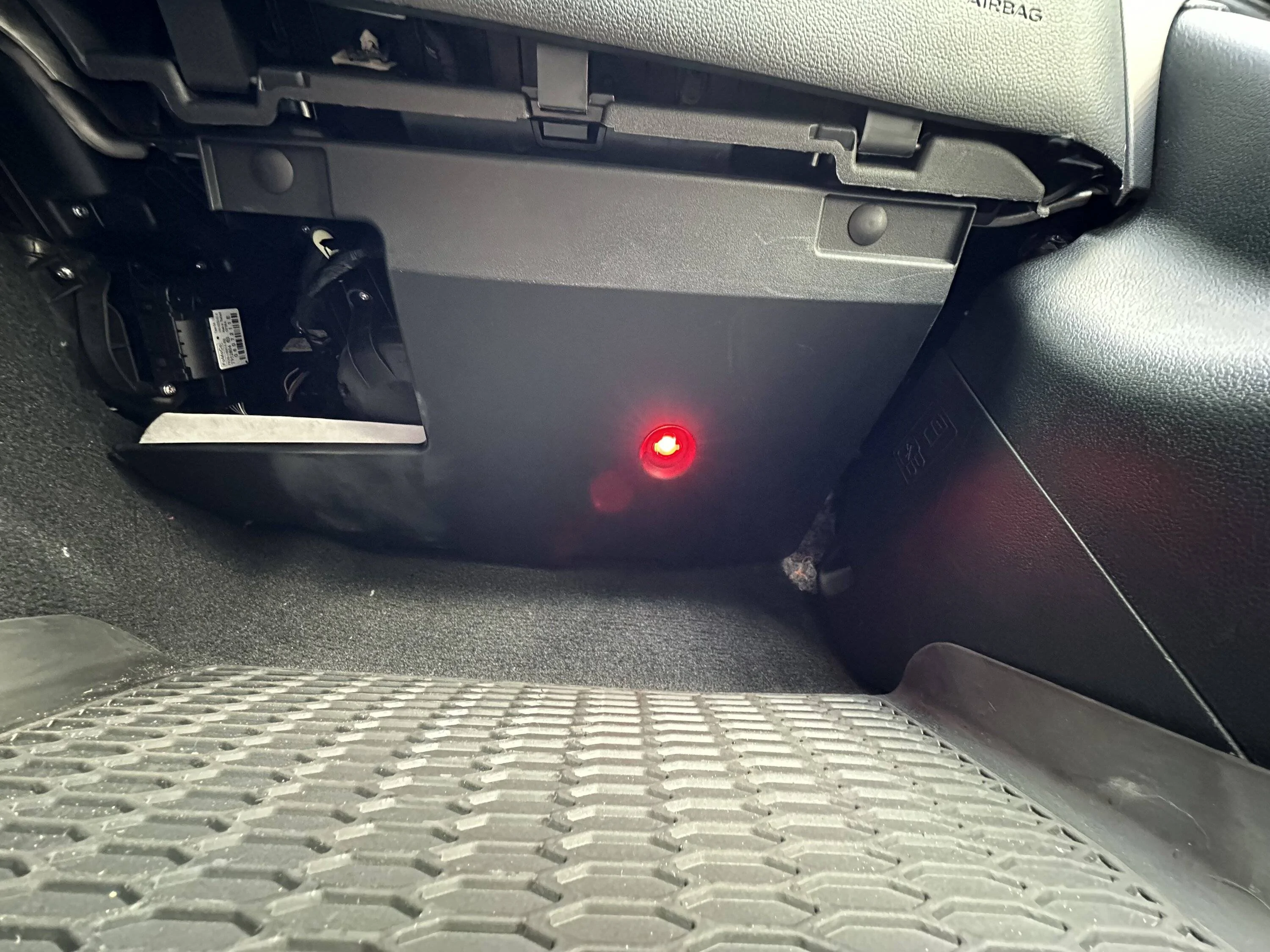

I feel dumb for asking for help with this but in all the videos and instructions I'm able to find, they say after you unhook and lower the glovebox, you can just stick your arm / screwdriver / filter up there from behind the glove box and you go from there. But on my Mustang there is a plastic panel with the ambient light blocking access from the footwell. No video or instructions I've been able to find mention this panel at all or how to remove it and I don't want to fuck it up.

This is the panel I'm talking about that no one in any YouTube video seems to have in their Mustang.

I just watched another video that is no different.
I wonder if there was some sort of mod by Ford. I noticed on your plastic panel there are two zits on the corners. I feel the desire to tug on those, to remove the panel to get past it.
Hard to see another way. The small port on the left isn't big enough for a hand, much less the filter.

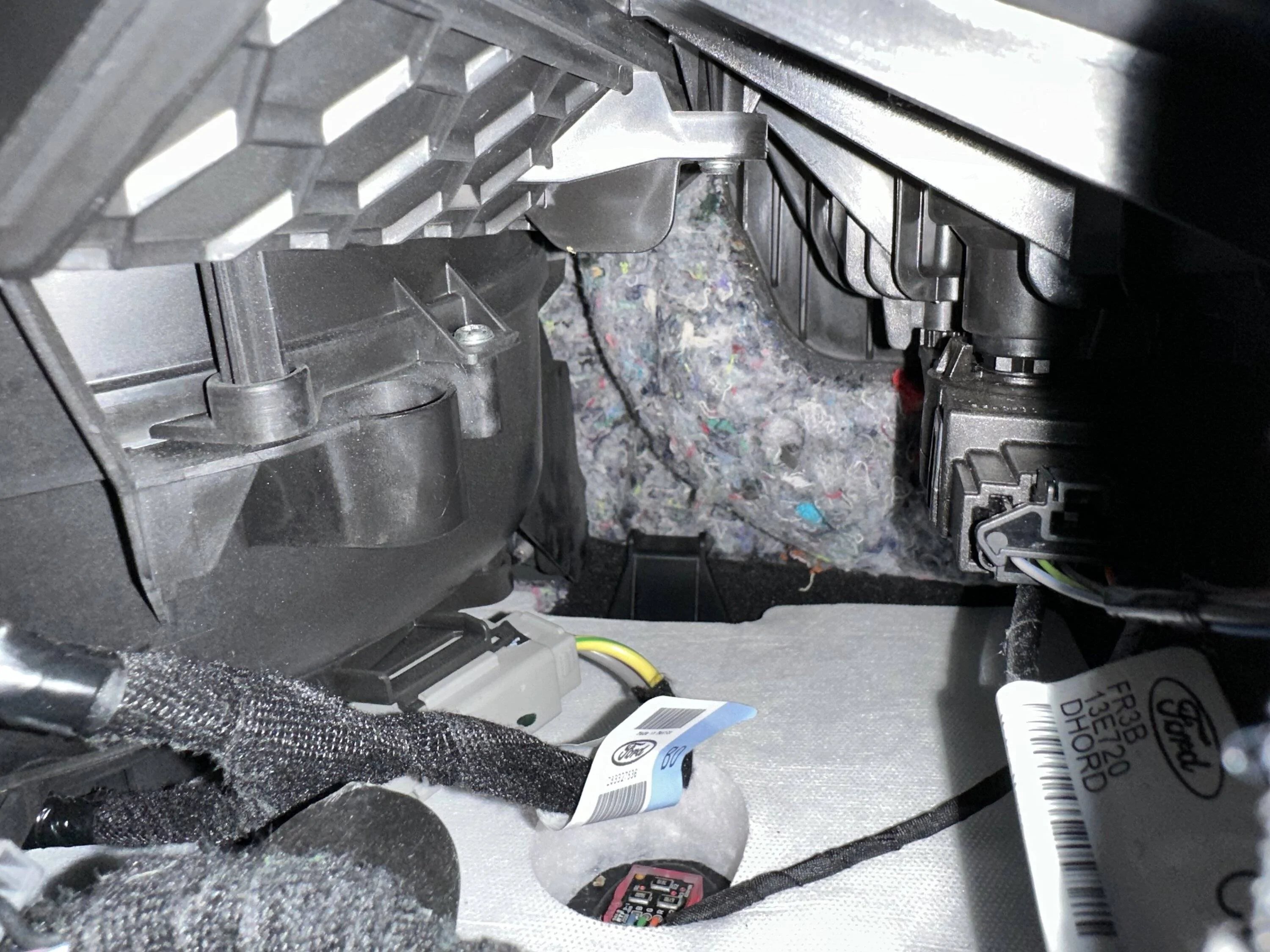

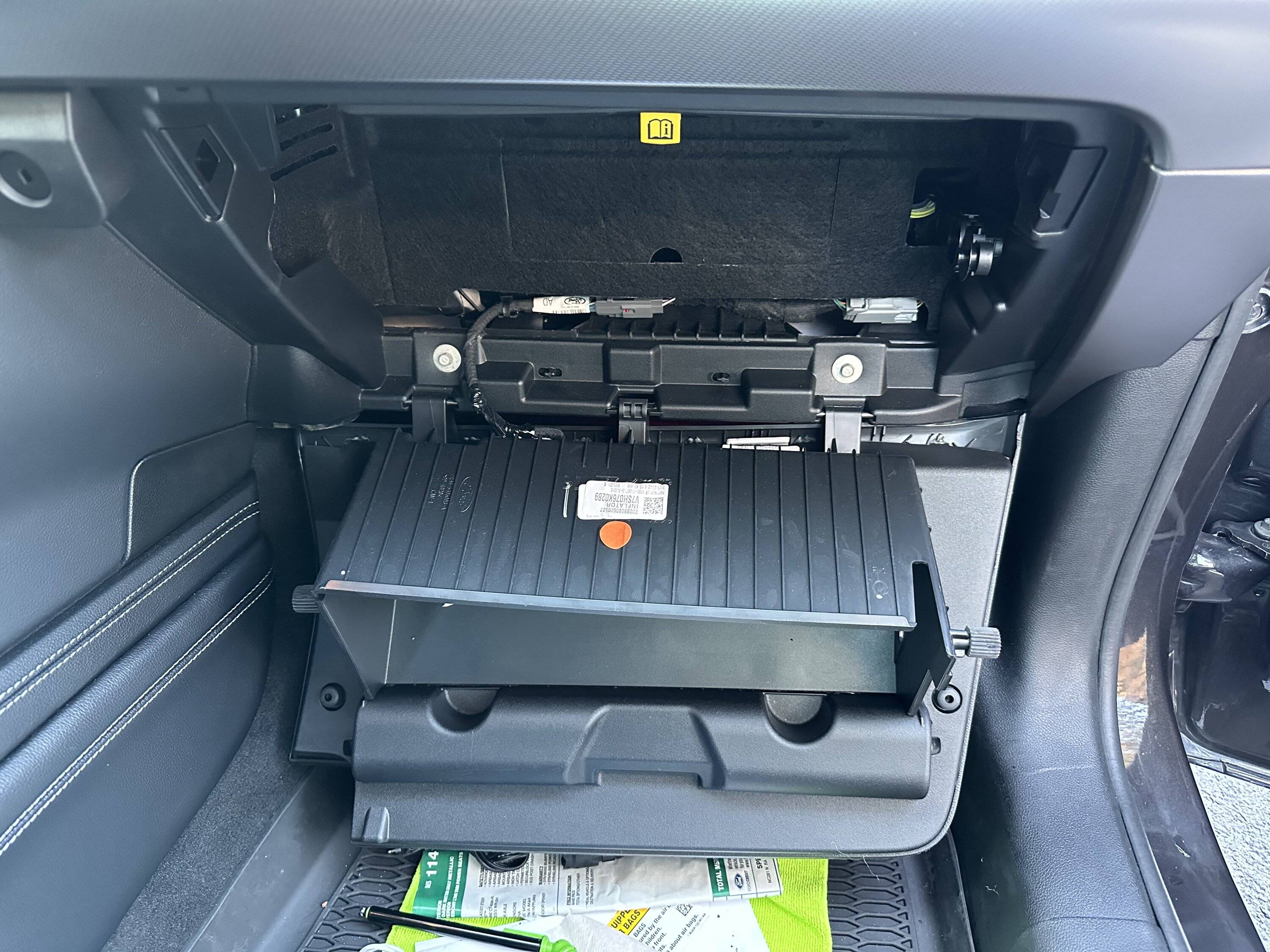

Here’s some photos with the glovebox down and looking though the fabric opening

That part I understand. But I can’t reach from under the dashboard to fit the screwdriver in there or to have enough room to remove the filter or insert the new one up into this space.
Ya, you're right where you need to be.

I understand now. Sorry I wasted your time. Difficult to see the filter making it out without the panel coming out first. FWIW, I'll continue to search.

It turns out you were right about pulling on those tabs. The one on the right needed quite a bit more force than I would have liked, but the panel does come off and I was able to replace the cabin filter.
