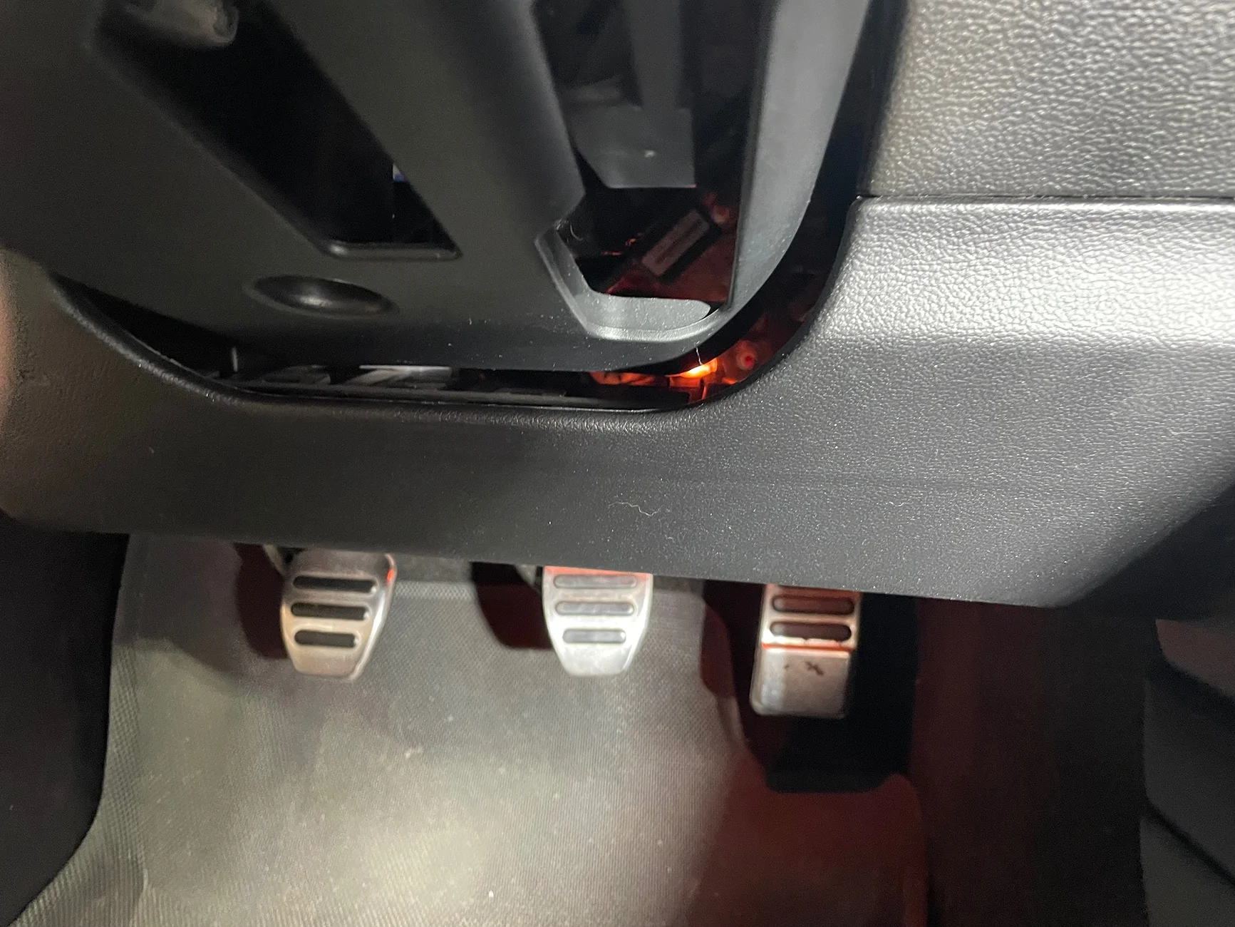

i need to know how to remove the plastic panel below the steering wheel column. I can’t see any screws holding it on but i am reluctant to pull on it too hard in case that are fasteners I can’t see. I’d appreciate any input from anyone who has taken this panel off.

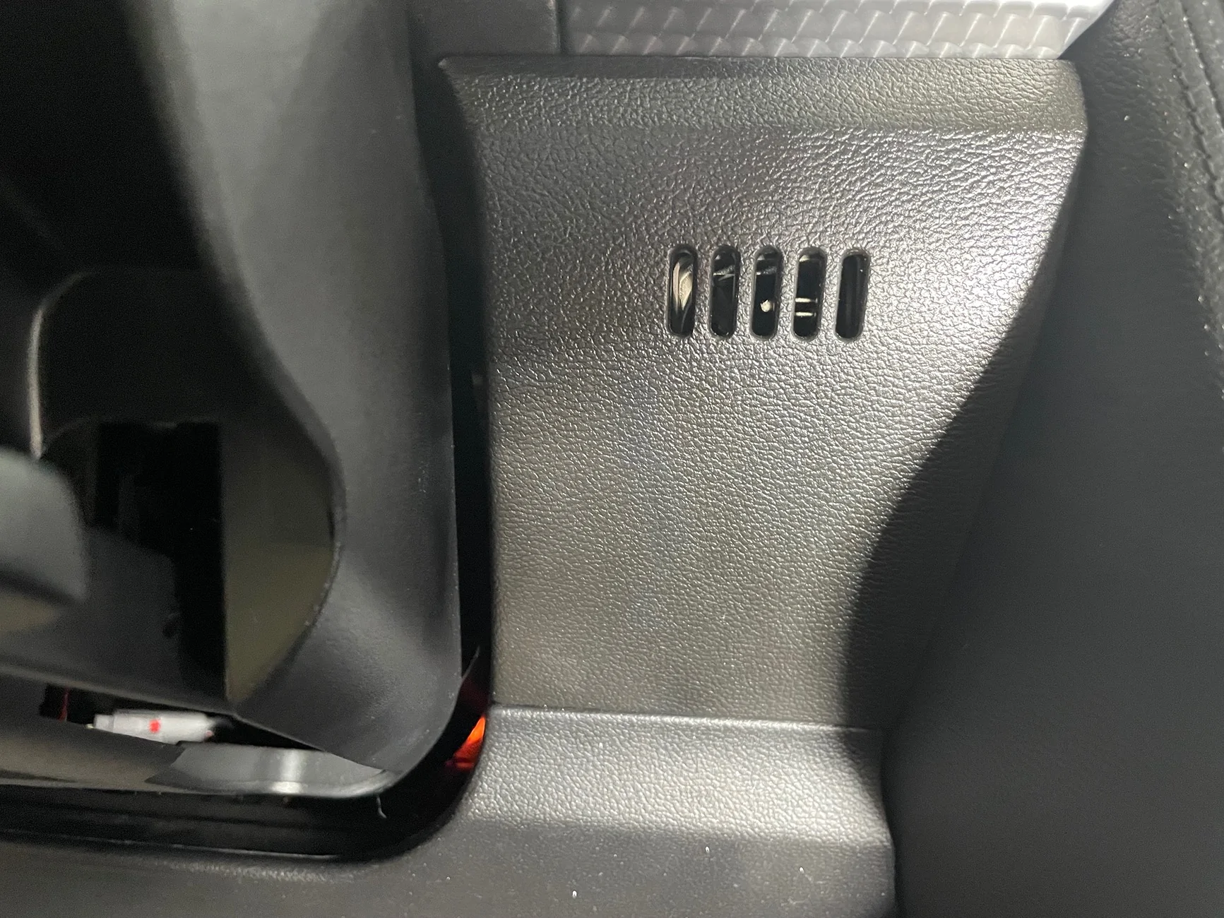

Here are pics of the grille where the sensor resides behind and the panel under the steering wheel column.

Never mind, I didn’t need to take the lower panel off.

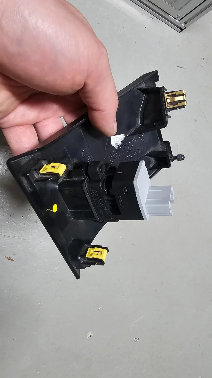

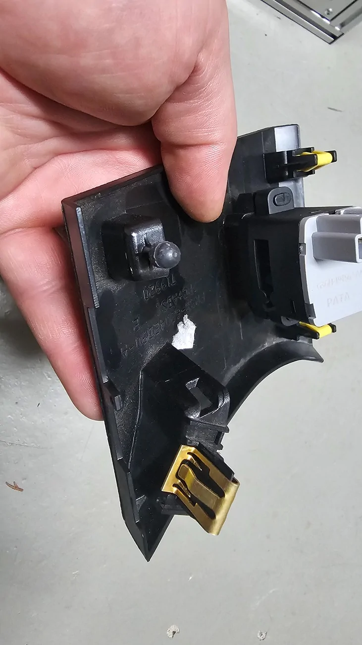

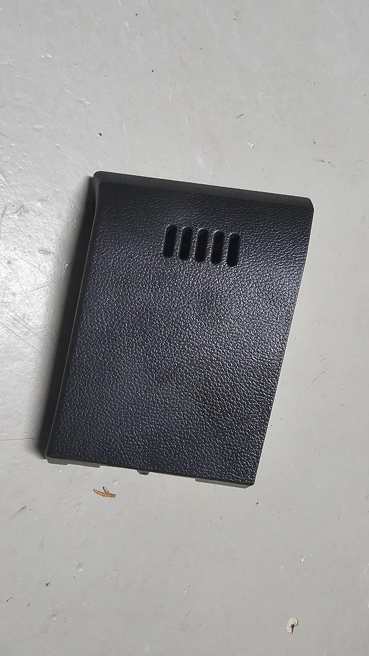

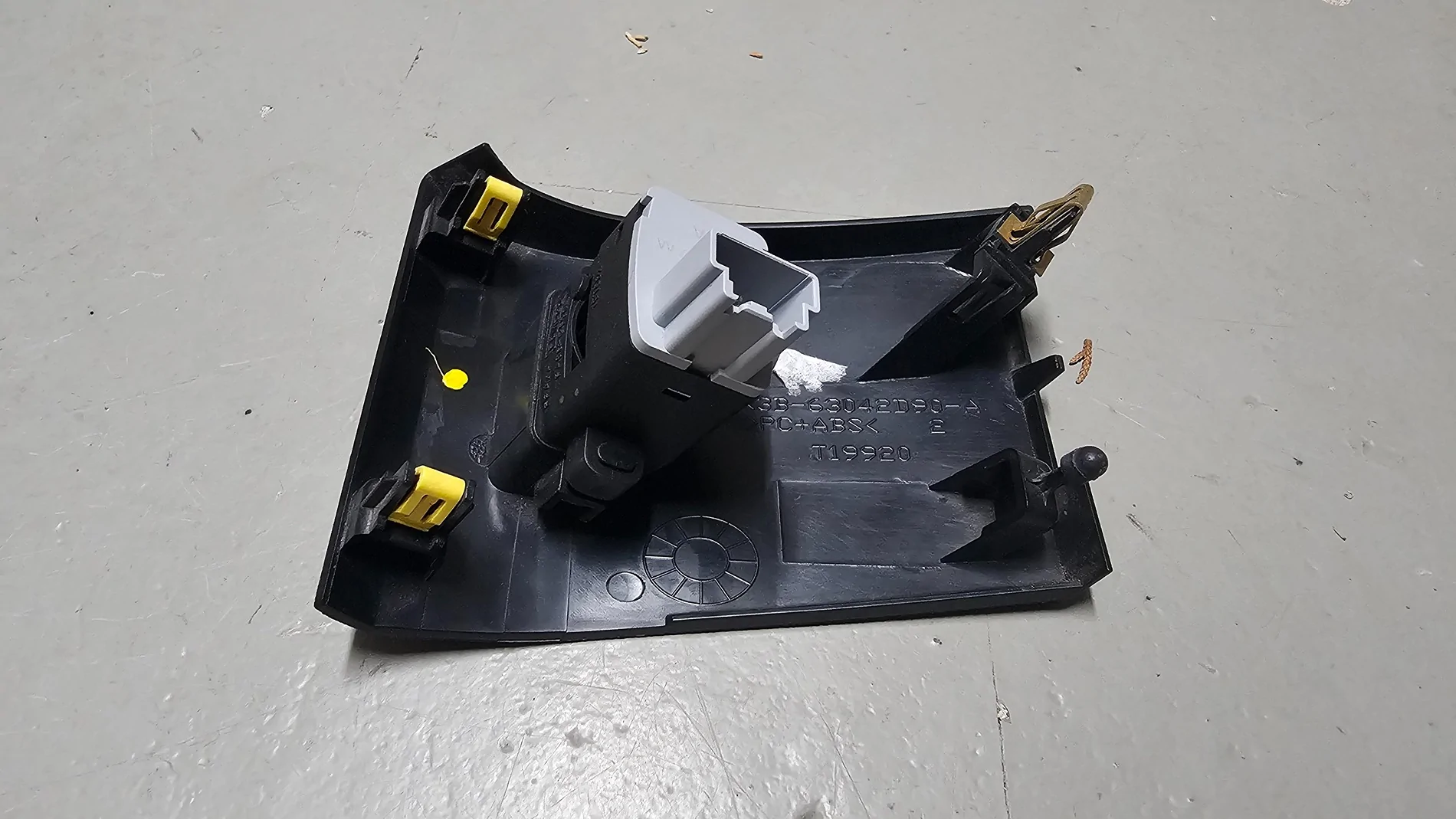

Anyway, see the photos from my sensor. I had to replace mine (...but was not the problem) :-(
This might help you and maybe others in the future!
If you want to remove it, you just need these plastic tools to remove the door trim...
