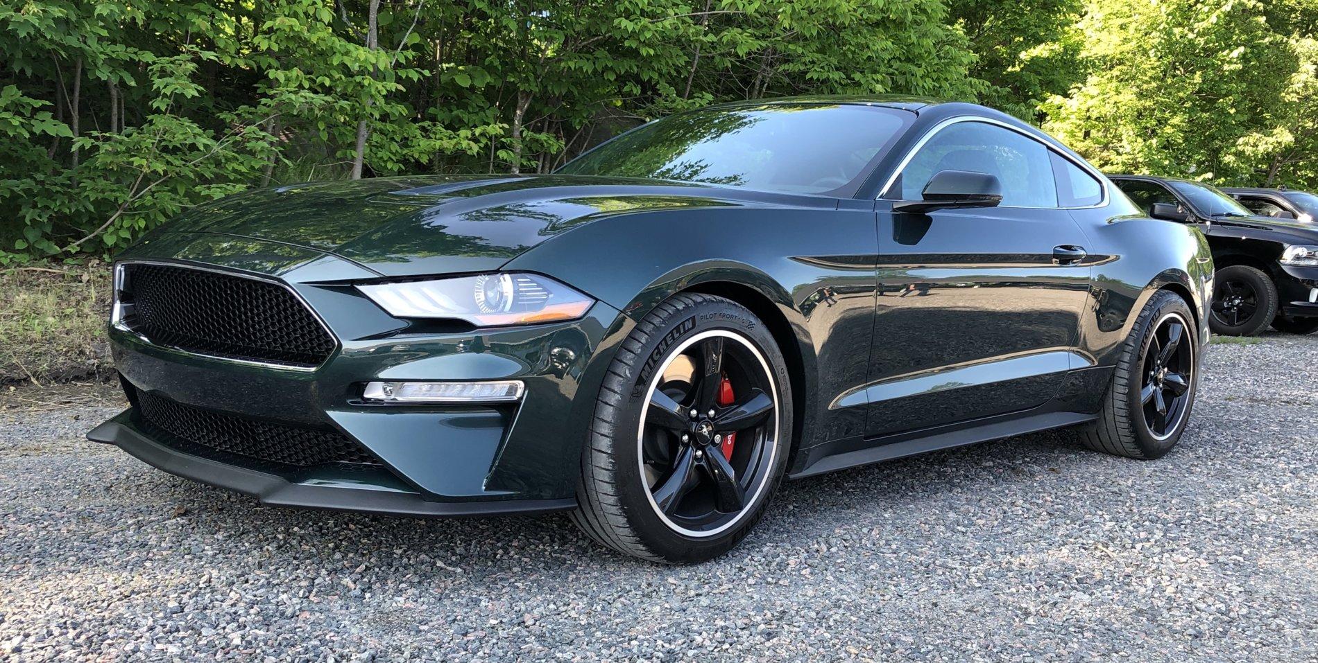

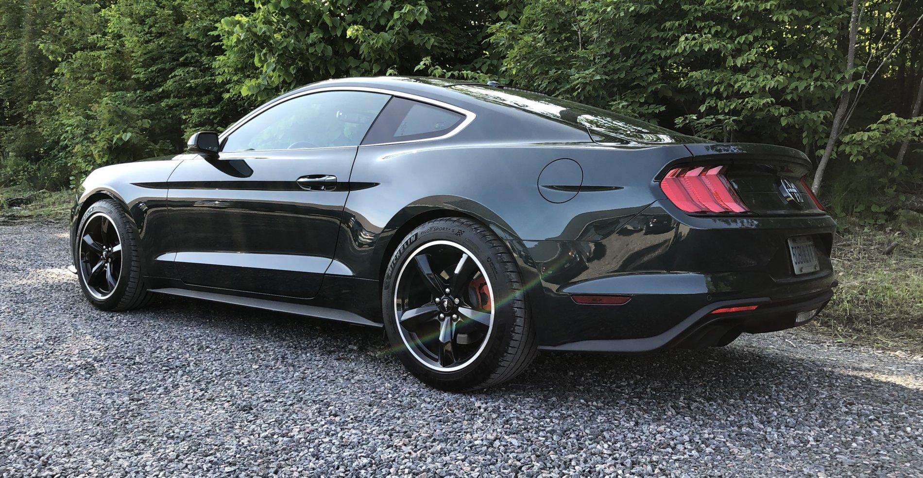

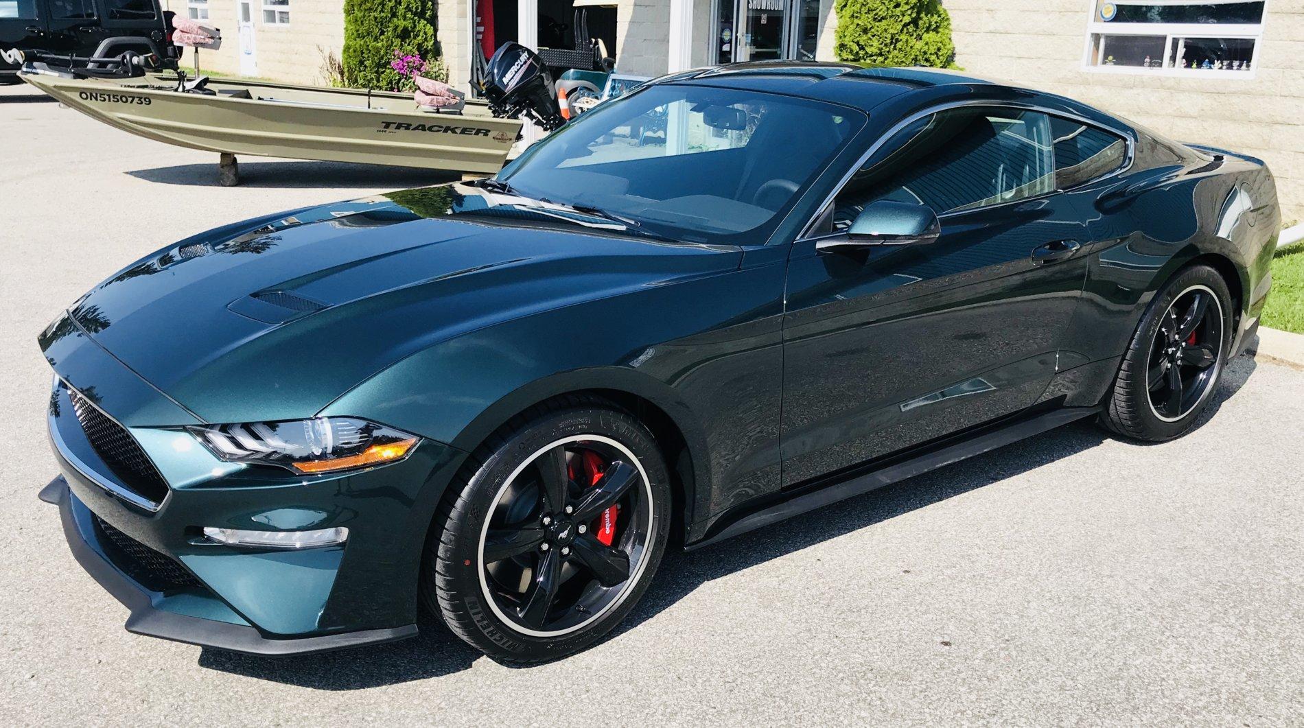

Pics as requested, added a stock pic for comparisons sake
Drove it up to my cottage yesterday, lots of highway + 20kms of an amazing winding/hilly road with fresh asphalt. First impressions were accurate... awesome improvement to the car over the stock setup. No downsides to report. These upgrades should be on everyone’s to do list.
