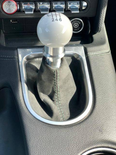

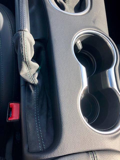

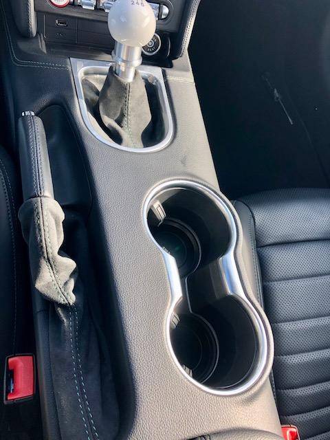

Finally got around to installing my alcantara shift boot and brake boot from RedlineGoods. Went with the dark charcoal and green stitching to match the rest of the stitching. It's also nice to finally have the correct green stitching on the brake boot.
Brake boot was straight forward and easy to install. You definitely need to pickup a can of 3M trim adhesive for this project. Both the shift and brake boots get glued back onto the plastic mounts on the car.
The shift boot is a little more difficult as you have to grind away the tabs for the chrome trim ring as well as the reverse lockout piece. I opted to go ahead and upgrade that to Barton's 1 piece metal version. There was no way it was going to glue back together and be strong enough over time. Plus the Barton one feels so much nicer not being plastic.
