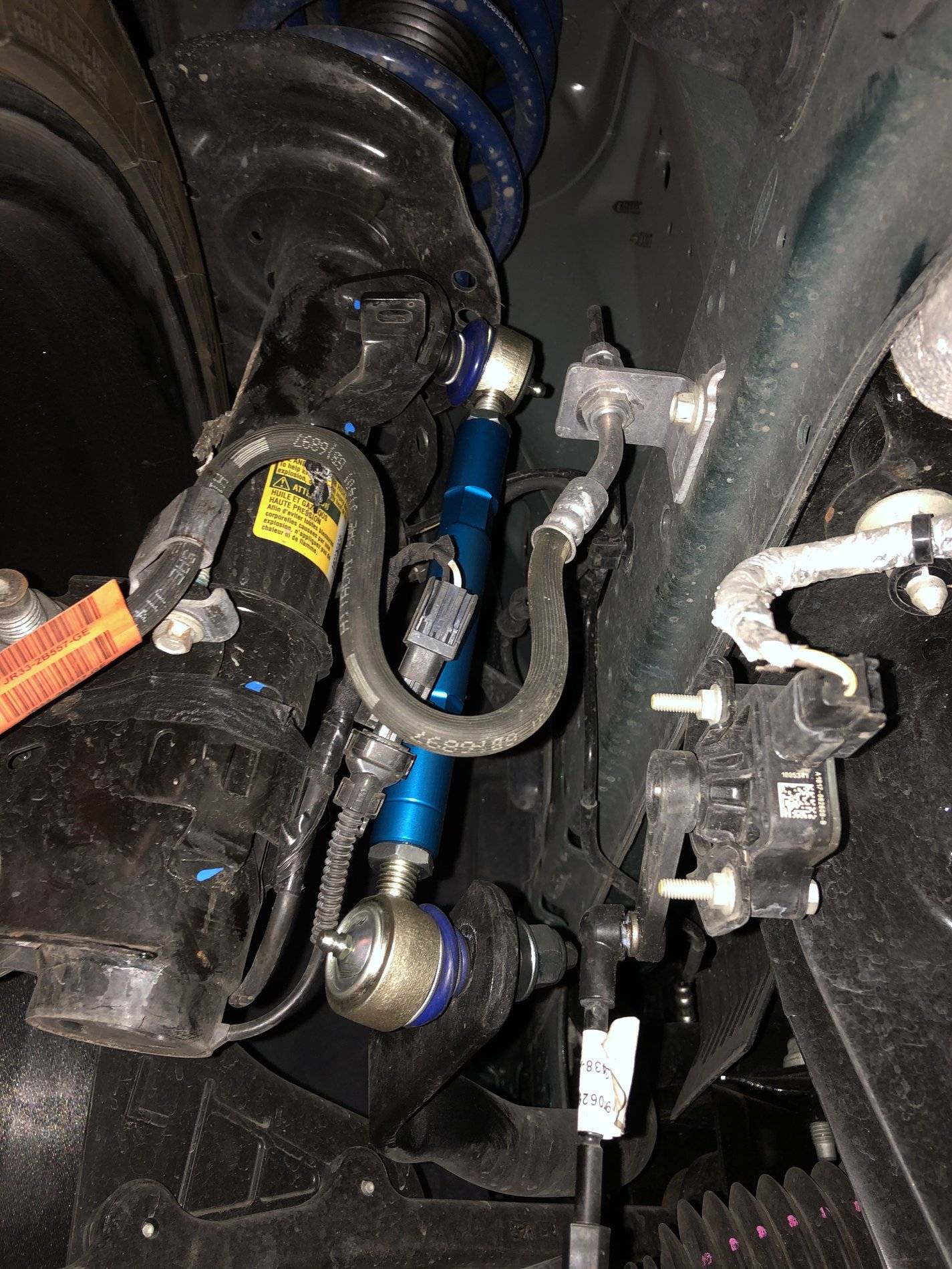

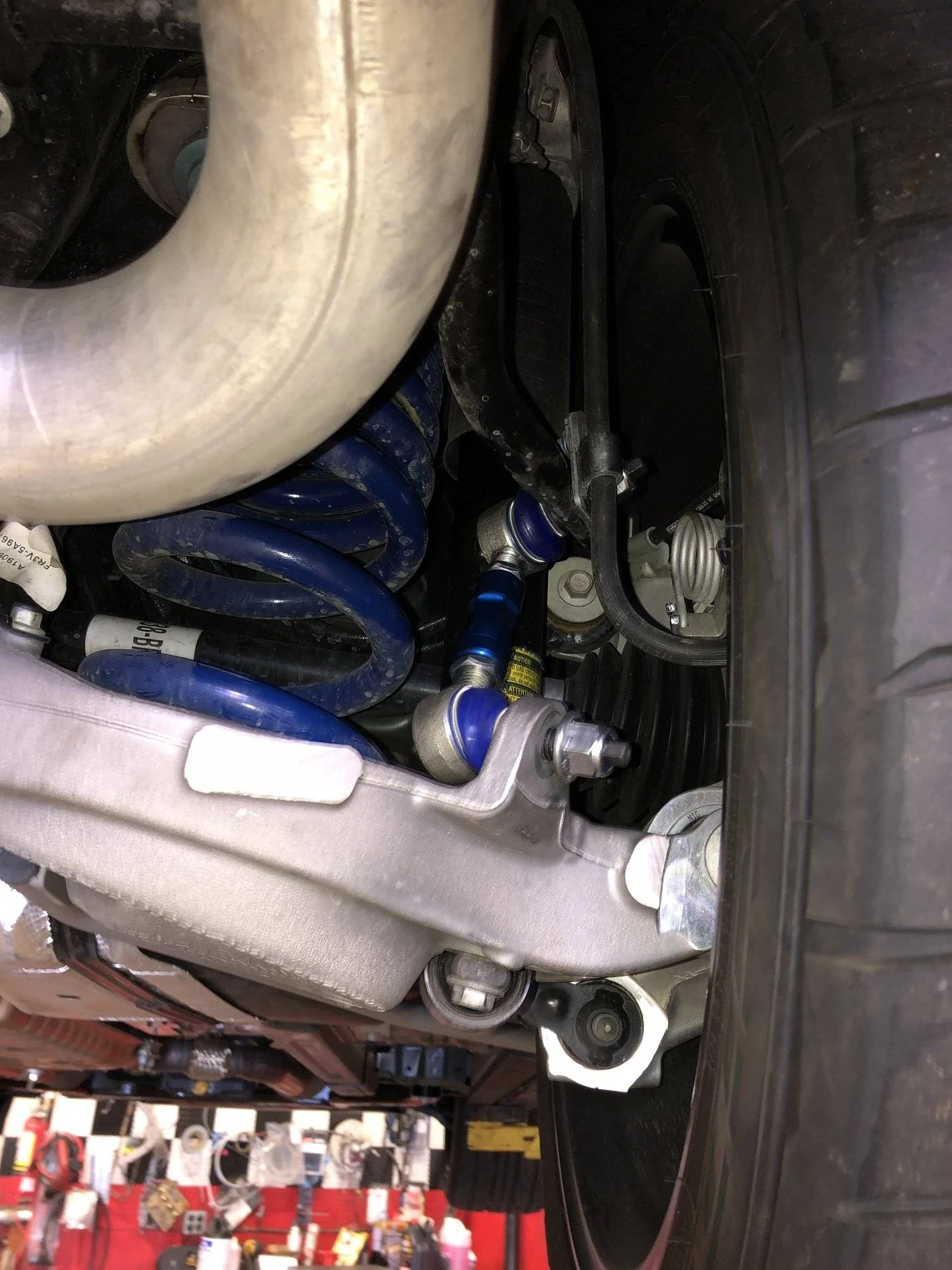

I installed the IRS braces, bushings and shim Kit. ....it literally plants your rear end and feels more like you’re on rails. Have the 2piece cross brace to install!! Tomorrow will install Steeda adjustable sway bar end links... after the Steeda Magnaride lProgressive lowering springs... steeda says to lengthen the fronts by 1/2” to return sway bar to the Facrory neutral position. The rears are a simple swap!
NOTE...after the spring install the front end was stiffer and overall more bumpy! Hoping to get rid of that issue!
you’ll notice the IRS Braces immediately!!!

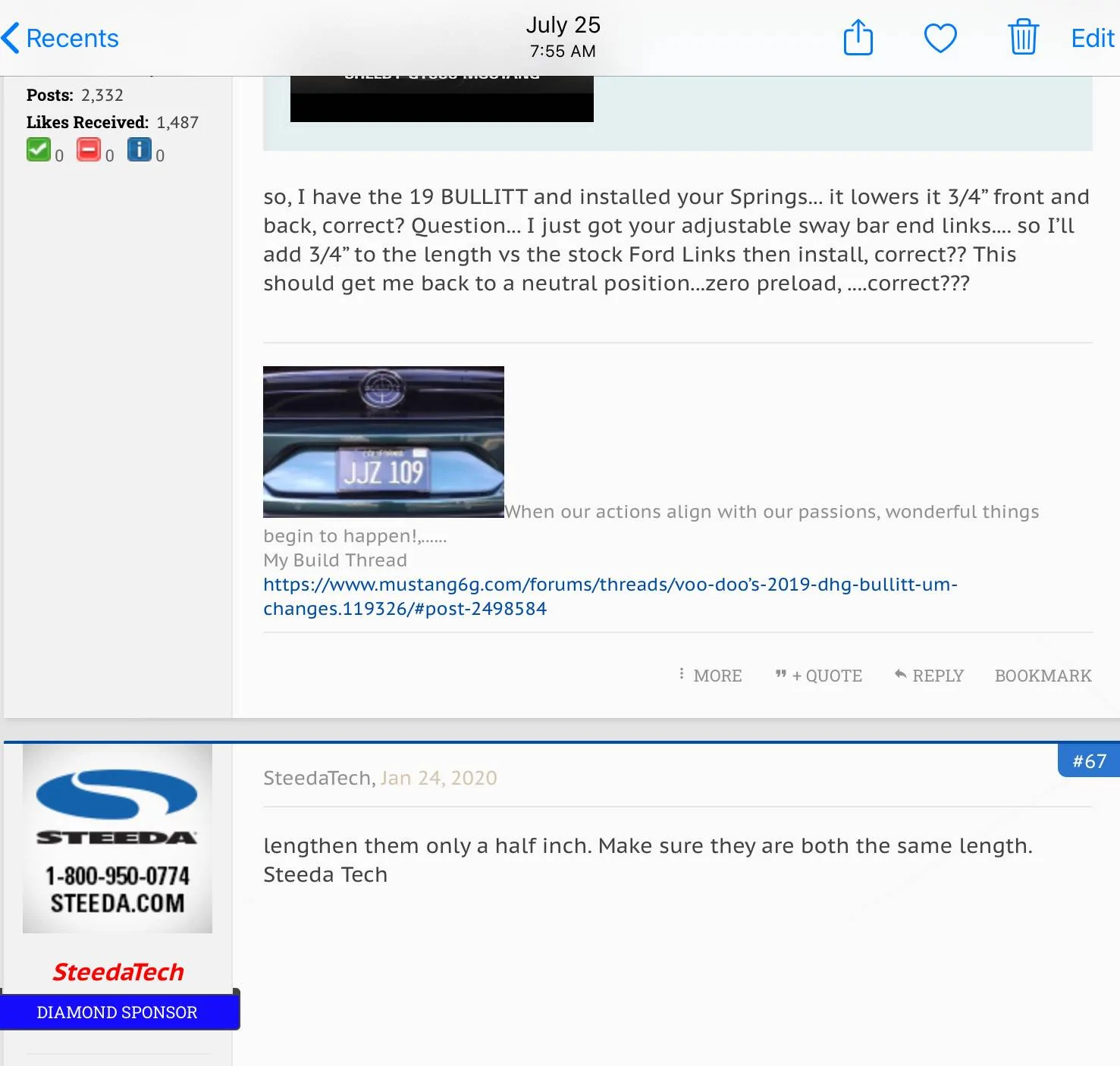

Steeda Progressive lowering springs (Magnaride) and adjustable Sway Bar end links !! As per Steeda Tech!! The install video mentioned the “factory neutral position” !! Steeda advised me to increase the front end links 1/2 “ after the install of their springs with the Magnaride! Immediate change in ride quality for sure! Front end was bumpy and noisy...now it’s back to the way it was!! Bangs, bumpy etc on a 2 mile stretch of road before install.. did the same ride in both directions after install... 100% improved!!!

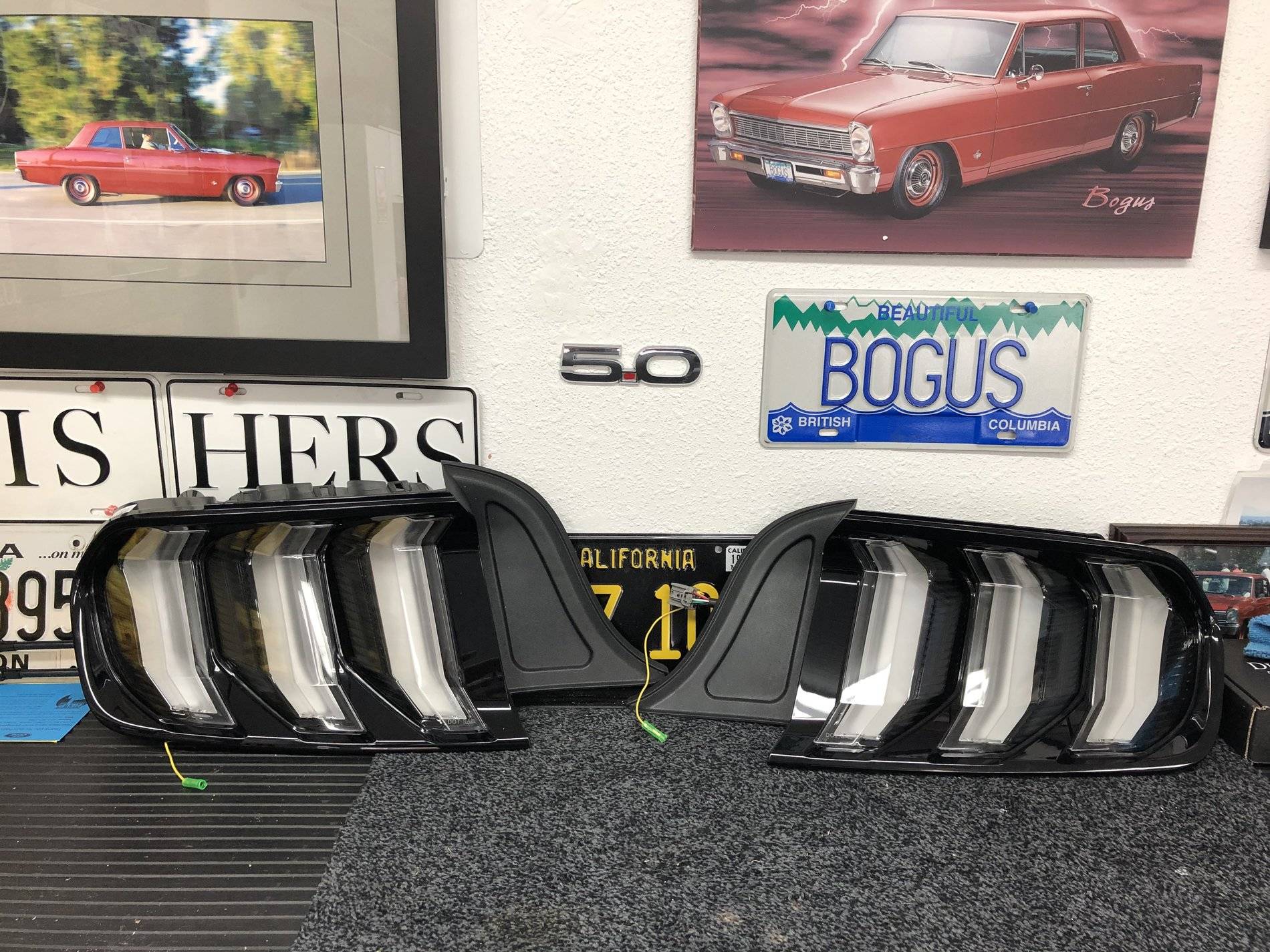

Christmas at my house!!! Time for a new look!!!
im really glad you got those clear lights, been really contemplating them, can’t wait to see them installed.
