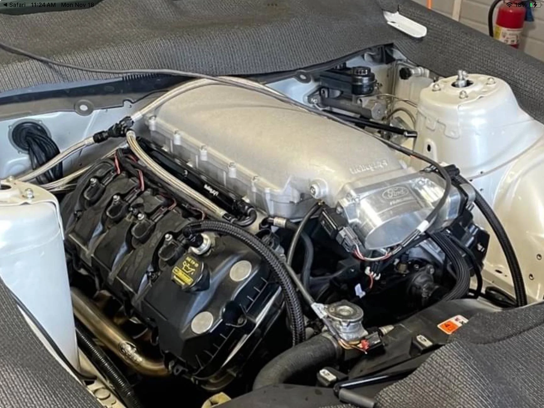

For $850 you can get a Holley Lo-Ram intake manifold (in black or raw aluminum) which has no IMRCs. In addition, you have the option to change the throttle body plate to either the standard round opening or an oval.
You mentioned wanting a tune, so when you buy your tune, just ask your tuner to turn off the IMRCs in the tune and you’ll never have to worry about broken IMRCs again.

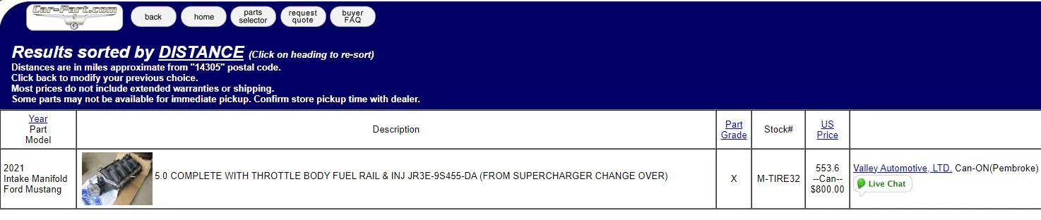

Have you tried car-part.com?
I get this 1 hit when choosing intake manifold for the Bullitt but it's not clear if it is indeed.
