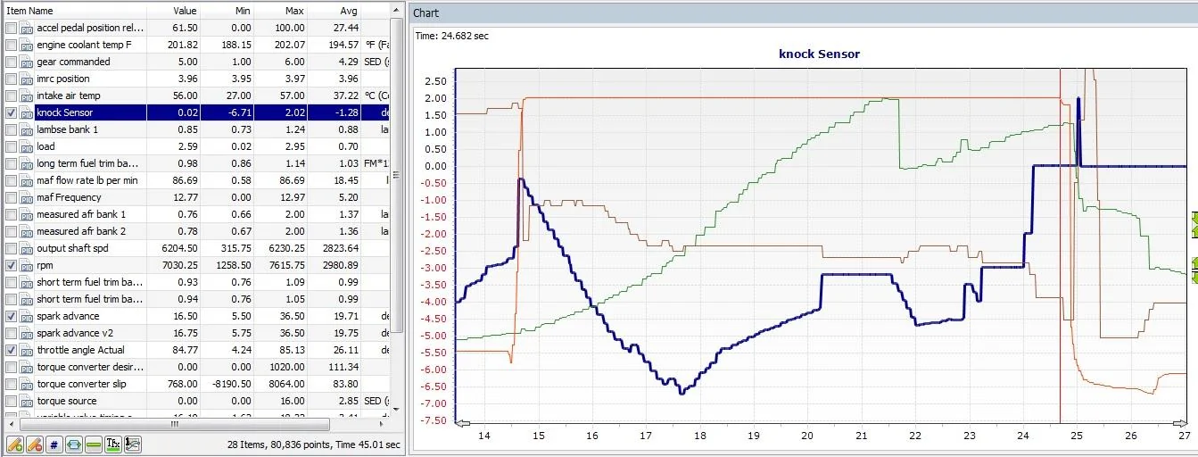

Stock LPF intercooler? IATS would be insane....even on E85. Hopefully tune is pulling timing as IAT increases. 21* with no timing retard and the intense heat from 23lbs sounds like an issue.
Look at IAT on the 20psi log. You should see total timing reduce if you are 200ish or more.

Day before at 20# I had a log,
Started in 3rd at 2500 and IAT was at 83, at 7500 it was at 109. I stayed in it and it shifted to 4th. I got out of it at 7000 in 4th and IAT were at 134. 1.5 seconds after getting out IAT were 123, another 1.5 seconds 116.

Hey man,sorry to.hear this and I know the knot in the stomach something like this causes.U talk to my buddy Ken a good bit and i.seen your log of the 20#boost and can't believe they asked u to.turn it up to 23 pounds with what I seen going on with the knock.sensorsI think u was definitely getting detonation and that takes a lot of heat to do with e85.I hope the builder works with u to.get this figured out and good luck.

Most knock it saw at 20# was 0.02. Is that enough to melt a piston and head casting at 23#?
