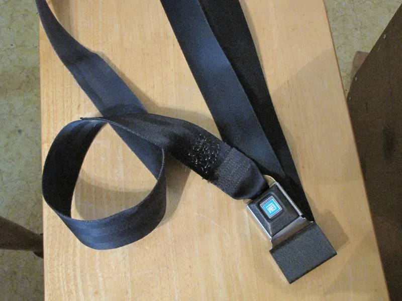

Not a seat replacement comment, but try to relax every muscle that isn't directly involved with pedal or steering inputs. Tensing up other muscles seems to lift some of your weight off of the seat, at least that's what I've found. You'll still use your knees, probably the left one more, but you won't be using it quite as hard. Maybe this gets easier with more hard cornering experience.
You can also make up a supplemental lap belt that doesn't slacken like the OE 3-points do. Doesn't even have to attach to anything if you stitch the free ends together to make it into a loop, just run it around the rear bottom of the seat cushion.
One of the things I saved from a previously owned car, suitably modified. Cheap, portable, and will buy you some time on any seat purchase that you do make. I've datalogged lateral accelerations beyond 1.3g with just these two aids . . . and my knees are old with a couple of repairs each in their history.

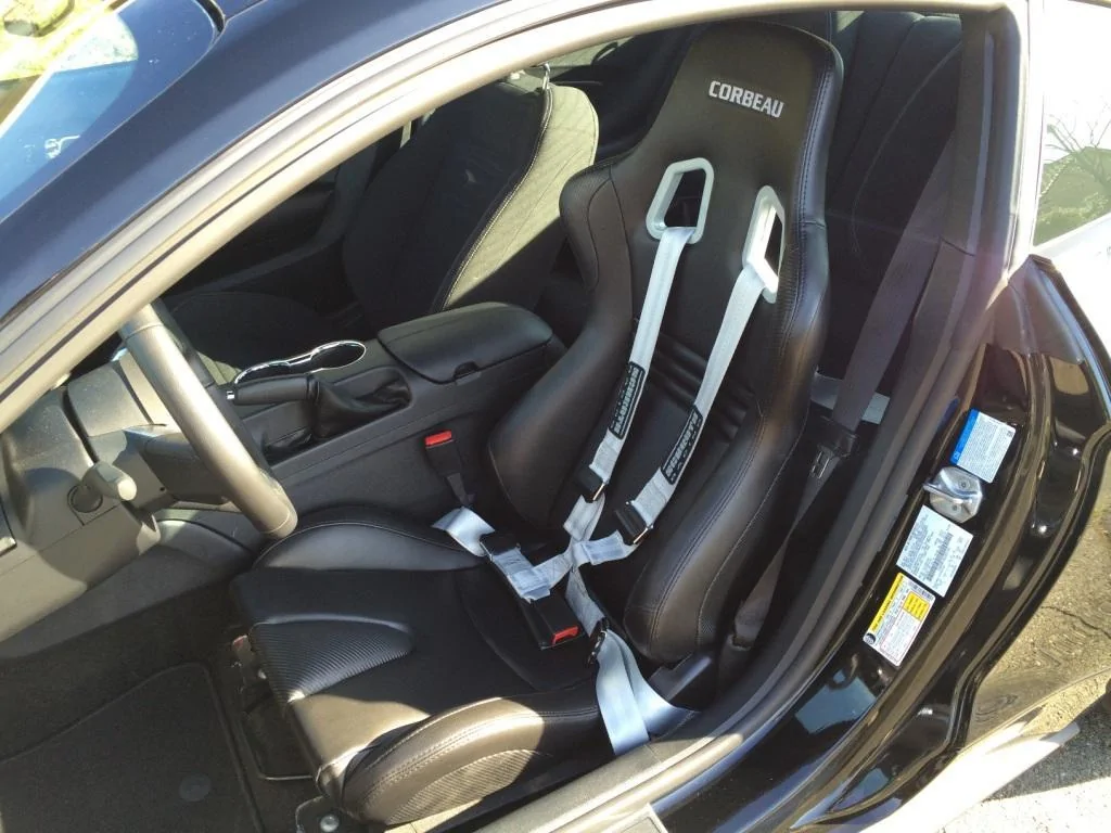

+1 on this. Physical installation of my Corbeau was easy, now lateral support much better, and more importantly I gained ~5in of headroom, so I (6'7") can sit straight up with helmet on and still have 1.5in of room to spare. Haven't found a hack to defeat the airbag light, but I too do not notice it anymore. And no way am I taking my car anywhere near a dealer with my mods / tune on it...
The Schroth 4pt ASM harness is the other very effective mod, keeps you tightly planted - don't go cheap with a non-ASM 4pt because the potential injury of submarining under is pretty ugly...
See https://www.schrothracing.com/tuning/rallye/rallye-4

Do you have any details on how you mounted the seat? The specific bracket? Seat model?
Details would be much appreciated.
My Sportline Evolution was selected for maximum drop in seat height due to how tall I am, but only 34-36in waist, I would not recommend these beyond 38in waist. But there are other wider options if you need, they just tend to be not as low. Seat model 64901B for black stitching, and there are a few dealers that will sell you a single driver's seat, so you don't have to get a pair (like Sinister Mustang). Bracket is E1702 for driver side. Installation is literally almost the simplest thing you could do to the car - four bolts, two front, two rear, just make sure you have the right size Torx bit. Then remove seat and unplug wiring harness, then just leave it unplugged on floor under seat. Install new seat with same bolts, and apply blue Loctite. That's it! There's a good forum writeup already on the Schroth install, but it's easy too.

FYI - traditional Schroth Rallye 4 and Quick Fit are the same belt, but the Quick Fit is intended to click in and out of the factory receptacles easily, so you can remove for daily driver. The original Rallye 4 is a bolt-in that you can still use the factory belt and just leave it there, but I don't do that - I just ignore the factory belt and use the Schroth. But it's also not a daily driver...
