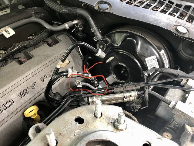

Not sure if you're done but I'll put this here in case someone searches for it later. Put some shop towels under the booster because fluid will spill into the frame channel, on the head, and the headers. Pull the the silver L shaped bracket holding the lines on from the stud on the booster to finally release it. The bracket comes off with force by wiggling it while pulling toward the front of the car. I'ts tight under/back in there and hard to reach but it will come off. The stud is threaded and the bracket hole has little lips holding it onto the threads. Bench bleed the new master if you can before installation. No need to fiddle with the ABS. Reuse the black rubber piece on the clutch nipple to secure the clutch line. As mentioned already, keep the clutch line up and away while doing the swap. It will be messy.
For anyone searching this later, the auto GTPP master does not have the clutch nipple so you can use a remote reservoir for clutch fluid. This can help prevent clutch friction material from coming up the clutch line and negatively affecting the master.
S550 GTPP master swap by MikeD, on Flickr
