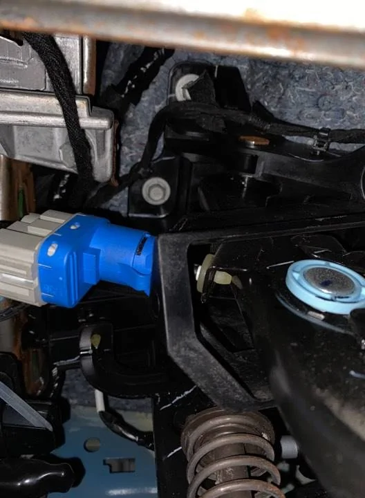

I was just under there a couple hours ago and it didn't look worn or broken to my eye. I'll post a picture up shortly. I did see quite a few people having that issue in other threads.

Look for the brake pedal switch thread in the TSB/Issues sub-forum ... there’s fixes posted there for anyone that needs it.
If that switch fails or comes apart while driving - you better hope you’re in a lane closest to the shoulder .... because others have experienced failure and it’s outright dangerous...

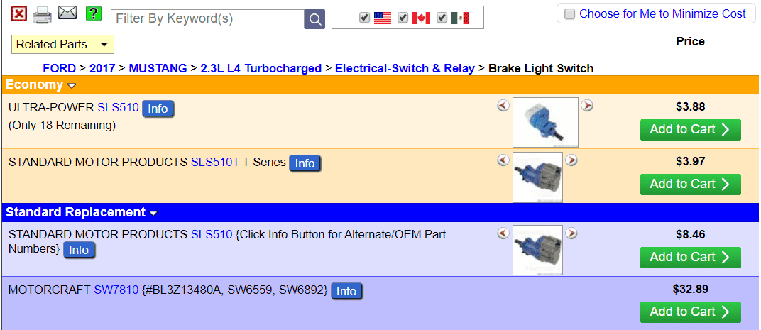

I sure can! There seems to be a gaggle of numbers, so I'll post the ones that seems to make the most sense.
This one seems to be the current Ford #: GL3Z-13480-A
Motorcraft #: SW7810
Standard Motor #(The one I bought): SLS510
It's readily found on Rock Auto as shown below, or at Autozone, O'Reilly's (they had the Standard Motor in stock!), or any of the derivatives. Replacing the switch itself takes no more than FIVE minutes.
1.Twist switch counterclockwise to release it from assembly,
2. Disconnect connect switch from wire.
3. Installation is reverse of removal.
