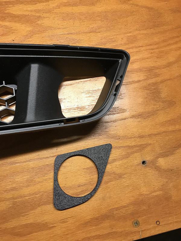

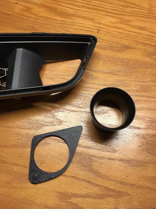

Bezel plate fabricated to fit.
B1F61229-1076-402F-96AC-805B6FA18BC6 by Dave Bridge, on Flickr

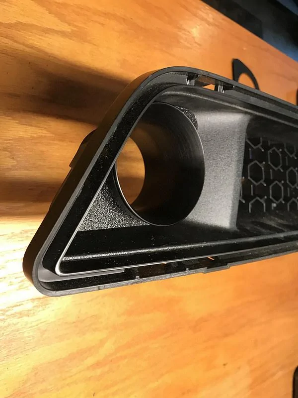

Using JLT fog light bezels.
156365EA-D03B-4C0F-97E0-ED5DB8BEC1A2 by Dave Bridge, on Flickr

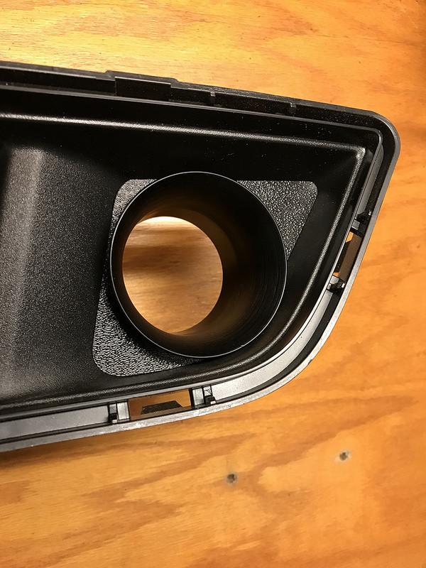

Fitted but not glued.
61EAE156-5ACF-49DC-8BD0-61CCD400C0F5 by Dave Bridge, on Flickr
2E0301EE-103E-4611-940E-66E8C500051B by Dave Bridge, on Flickr

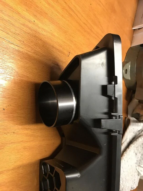

Enough bezel on the rear to add the 2.5” hose.
5FD30819-1827-4B14-91E4-2759D6322BA8 by Dave Bridge, on Flickr
