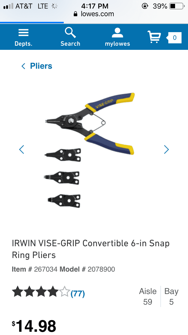

Posted another thread few minutes ago and I used this set from Lowe’s 15 bucks
Has a nose that bends 90* down, was perfect, snapped the ring in with myself gripping and gf pushing down the ring w a flat head. Seated just fine. Didn’t blow off
