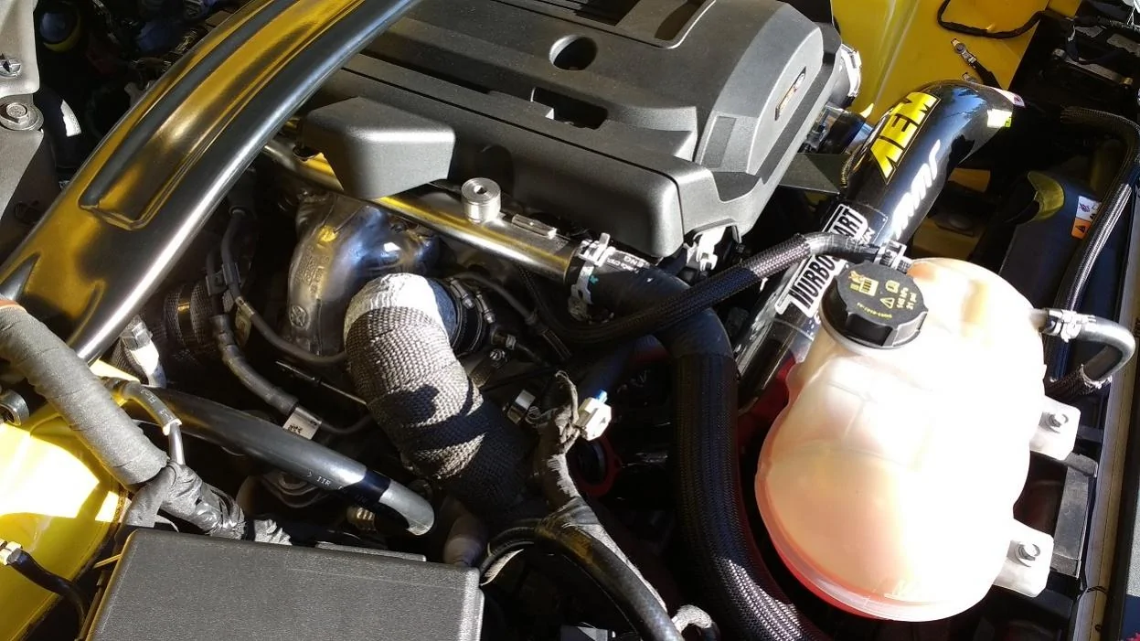

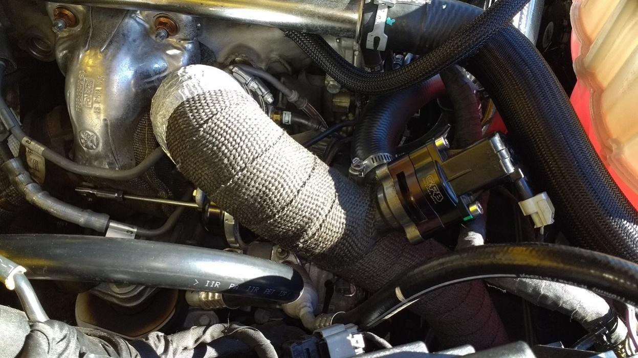

I have received your email. Great car man, you ‘ve done a great job! And you live in a great place. It seems that you managed to combine all three (the stock solenoid, the DV+ and the fantastic little Boomba adapter) because you have a totally different setup (charge pipes and intake tube). In my case, the stock charge pipes and the Airaid Modular Intake Tube (even the stock intake tube) probably will not allow to combine all three. I will try but I doubt that I will make it. I am expecting the DV+ and the Tune+WGA in about 10 days, so I will let you know soon.

[MENTION=32046]trippleyelo[/MENTION] I am uploading on your behalf the photos that you sent me, so that other people can see how you combined the Boomba Racing Adapter, the GFB DV+ and the stock solenoid. Thank you for your contribution! Great car! Please send the video of the sound if you can. And come join our group on Facebook!
Let me remind to the other members that, as per my post above, what [MENTION=32046]trippleyelo[/MENTION] has achieved is probably not possible with the stock intake tube (or the Airaid MIT that I have on my car) and the stock charge pipe, because everything is too tight. But I will report back on that when I will have received my own DV+ in a few days.

Sounds about right I gained 3mpg on a road trip today from Vancouver to Chambers bay wa. Roughly 430 miles just shy of full take off gas with a Vargas 2 turbo . I did have a gfb dv+ and Bomba adaptor stack with no leaking issue the response was amazing boost not wasted and throttle response faster of line and between gears. I would suggest if you have Bomba adaptor in place save some money do my mod..

Heat tape for wrapping headers to keep the turbo from heating my air in charge pipes and intercooler every race car has it in some form bad ass stuff Made of fiberglass you better wear gloves when handling it..
