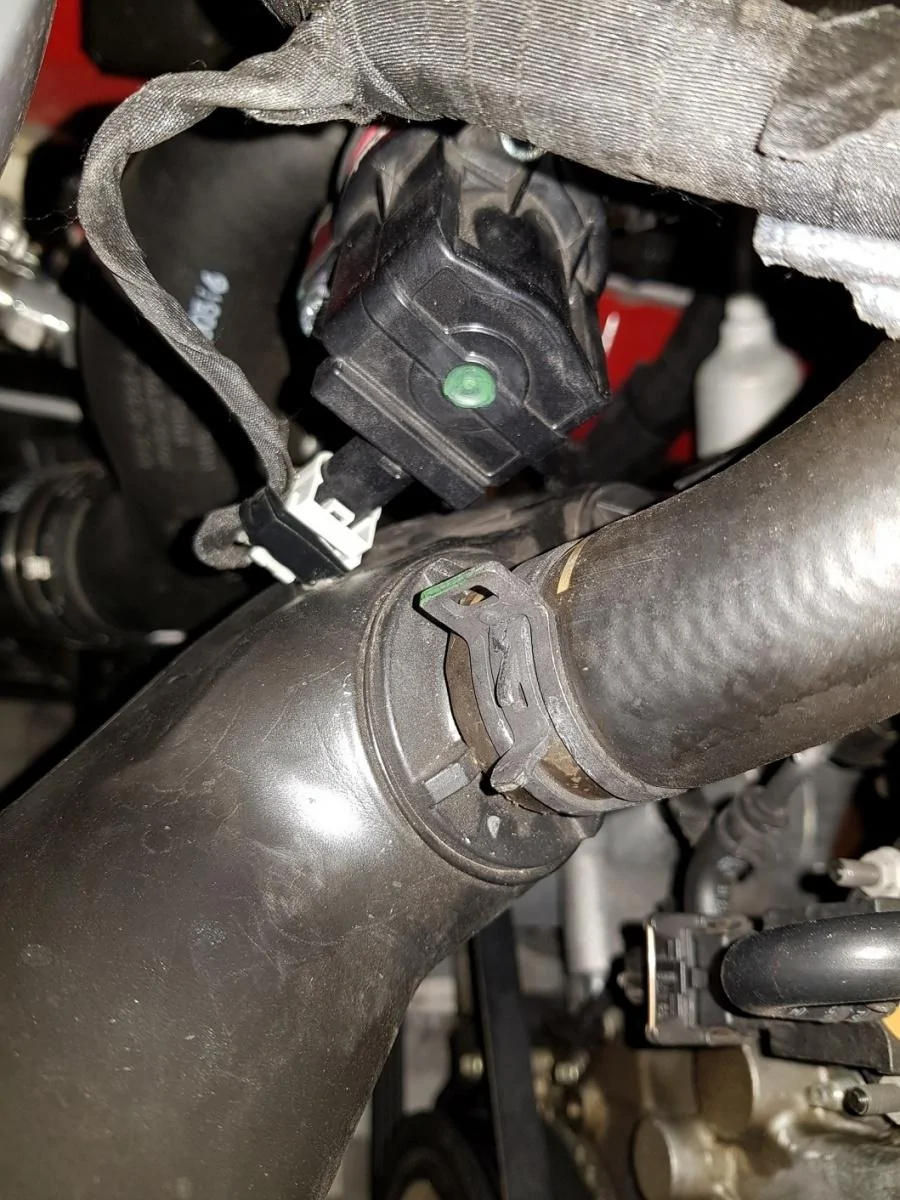

However, if you take a look at the photo below, you will realize that there is no space at all... What you see in the photo is the stock BPV connected to the Boomba Racing adapter. Everything is so tight that the connector rubs against the intake tube.
So it’s either stock BPV & Boomba Racing adapter, or Stock BPV & DV+ with the hose disconnected (if you want sound).
However if you manage to put them all all together in a row, let me know how you did it, so that I do the same thing. :thumbsup:

Can you post a photo once you install them? I am also installing the DV+ in a couple of weeks, but unfortunately I will have to take the Boomba Racing adapter out... :(
So I will have to pull the recirculation hose out, like many people have done, because I want the woshhhh sound. Too bad because I really like my Boomba....

The Boomba Racing adapter gives an excellent sound. It’s one of the greatest little mods that I β€˜ve done on my Mustang. Plus this little aluminum piece looks great in the engine bay. I am about to install the GFB DV+ Upgrade when I receive it in a couple of weeks and I really regret that I will have to remove the Boomba adapter. Unfortunately there is no place to fit everything. I mean I will try, but I don’t think I can manage, everything is already too tight in there (see picture above).
