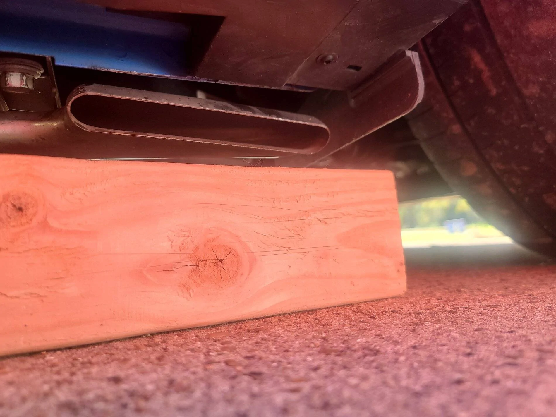

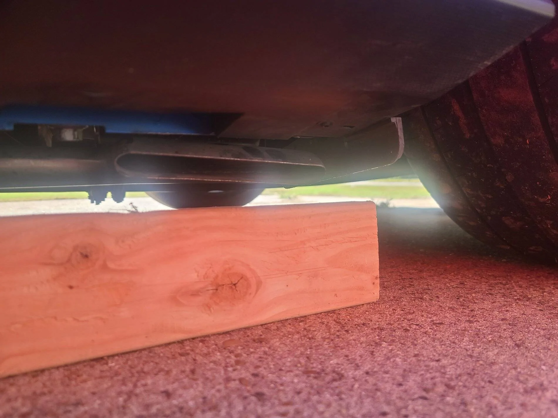

One last question… I have jacking rails, do you think the tips will work with those?
I do not have jacking rails but will be buying some here in the next month or 2 and will post some pics when I get them on

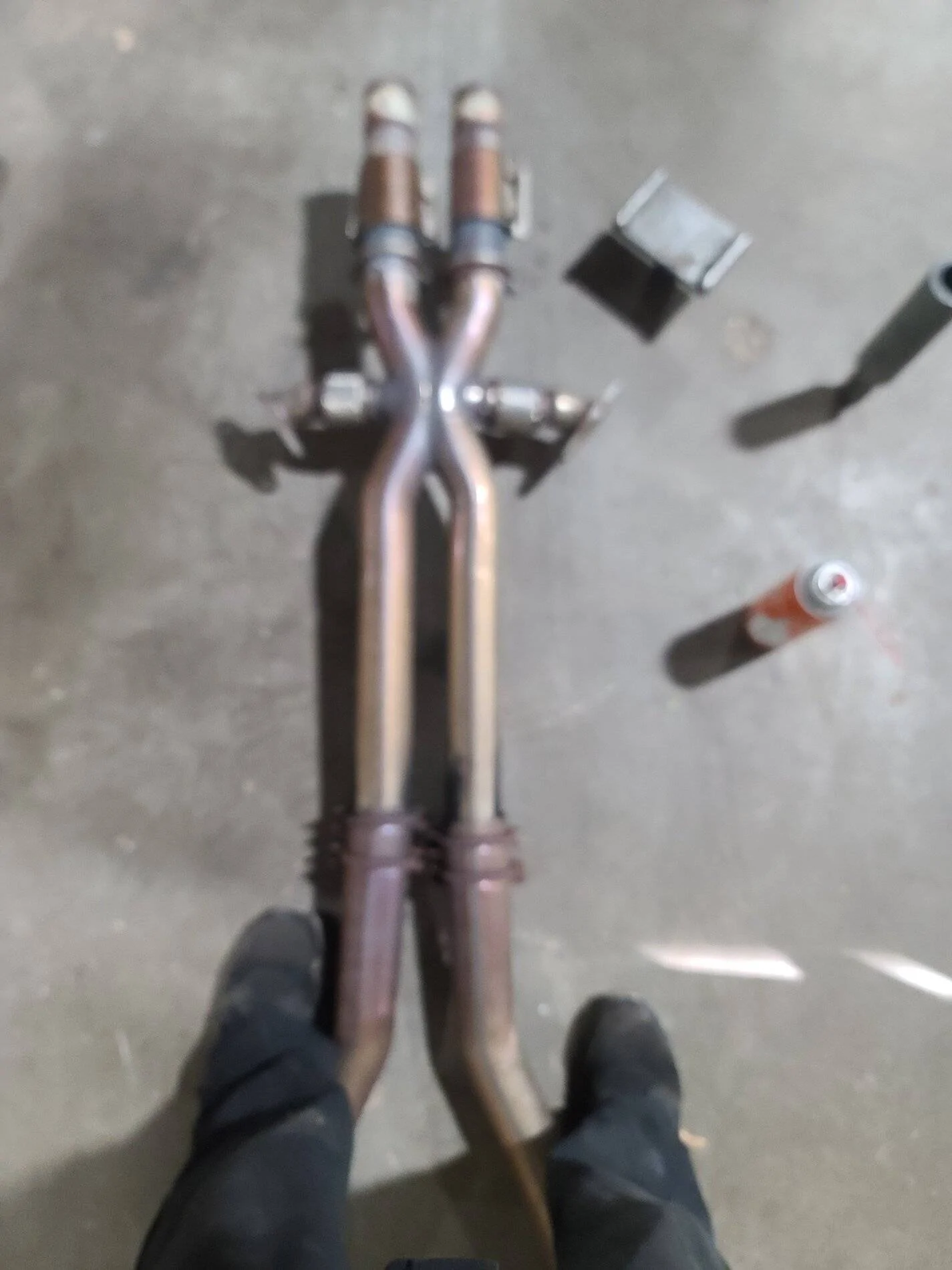

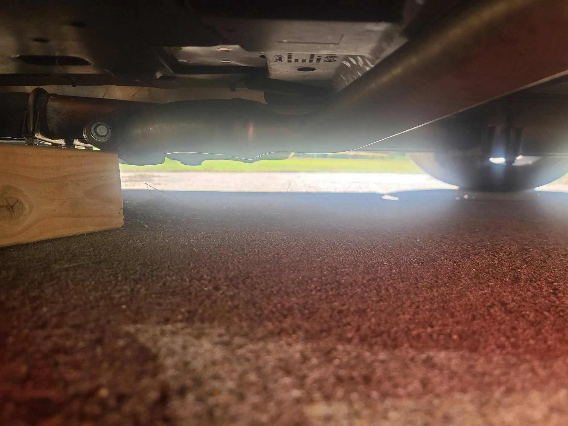

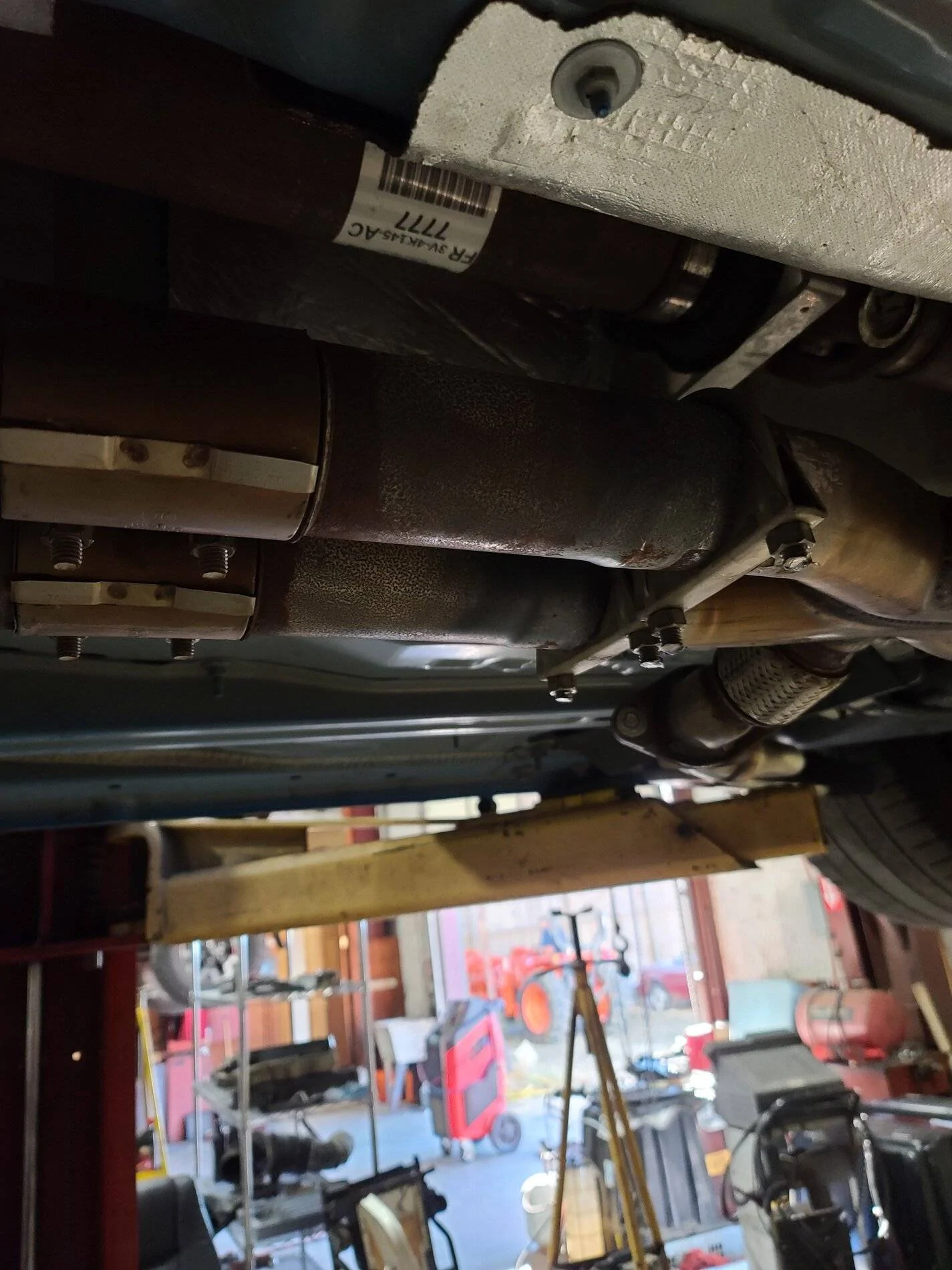

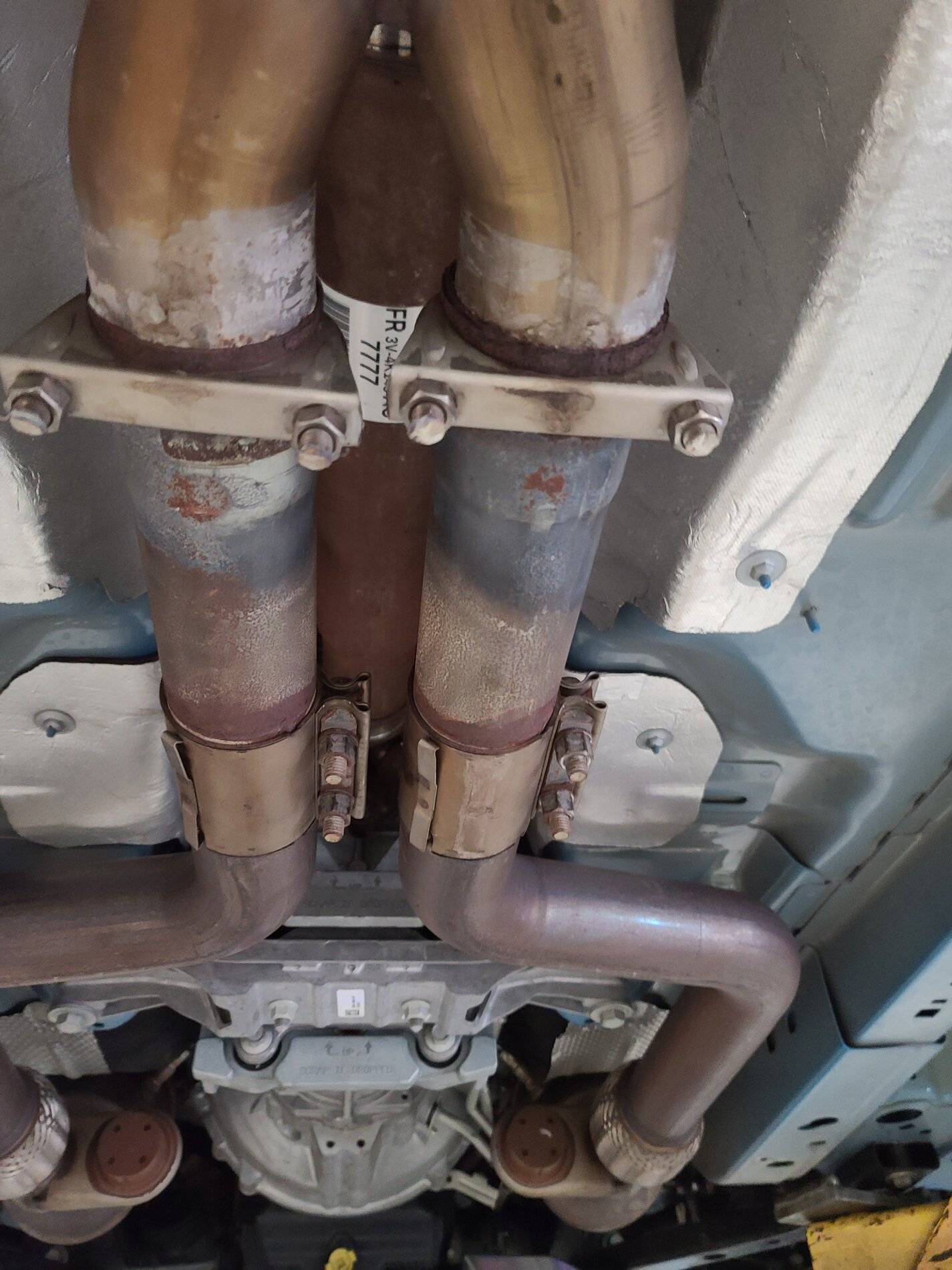

some pictures since I had it up in the air this morning
So it appears to go into the axle pipes section just fine. In front of the x section, are those reducer pipes to fit into the OEM catted pipes?
yes that's all I had to get to make it fit it's mild steel reducers I found at autozone I need to get some stainless steel ones so I can weld it all together and get rid of all the clamps but I'm waiting to get my hellion kit to get installed so I can adjust all the piping for final fit before welding

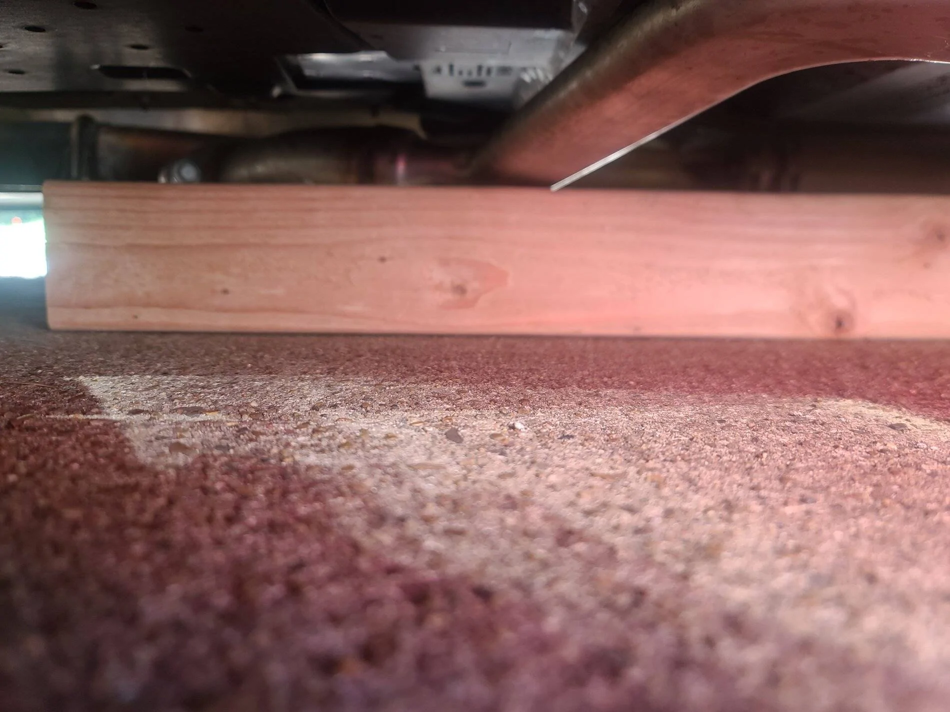

I threw a 2x4 under the car for clearance reference I'm on stock wheels tires and springs

Thank you for posting those, mech94! Very helpful. Can you confirm that they are 2.75" on the back side of the X?
EDIT: just looked a little more closely - looks like you ran the X pipe inside of the over axle pipe and then clamped it down? So then maybe the Ford Racing X pipe is a 2.5"?
I don't know how ford measured the 2.75 for the x pive vs the stock 350 exhaust but I think the 350 exhaust is 2.75 I.D and the xpipe is 2.75 O.D that's why it slid in the axle back
