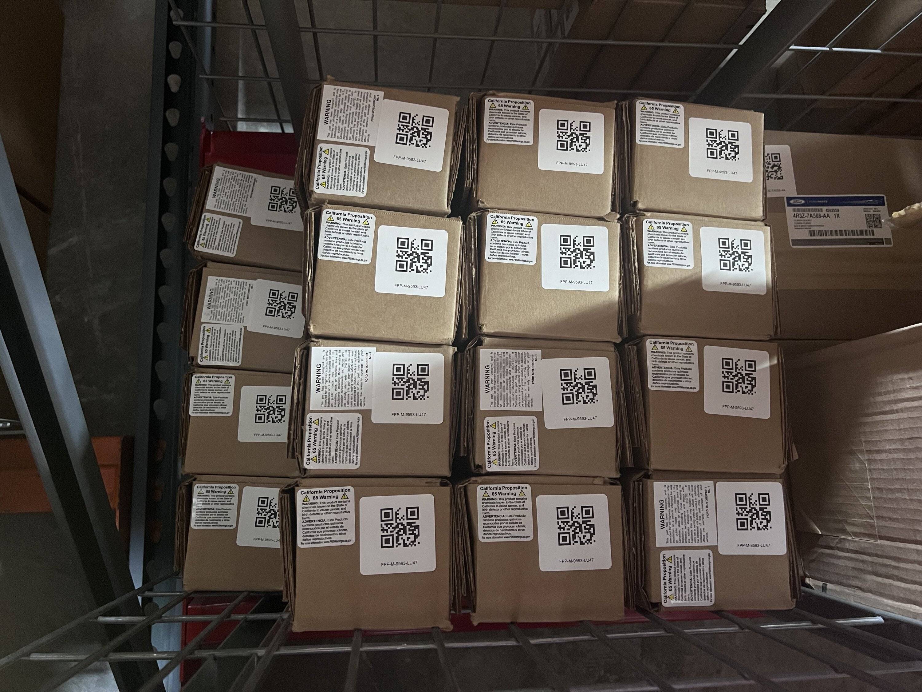

we have plenty of injectors in stock, if your tuner wants 47's , i would go for those

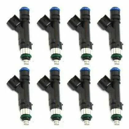

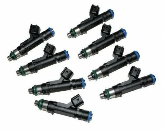

Always listen to your tuner over anyone else when it comes to stuff like this.
We have tons of the 47's in stock along with our LP56's which are the OEM 2020 GT500 injectors. They actually cost less than the 47's and flow more. Most reputable tuners have the data to tune for them so it might be worthwhile reaching out to your tuner and seeing if they're comfortable tuning them. If not 47's work great and we can ship either of them today no problem.
https://www.lethalperformance.com/ford-performance-ev6-47lb-high-impedance-fuel-injector-set.html
https://www.lethalperformance.com/f...mm-high-pressure-fuel-injectors-8-pieces.html
