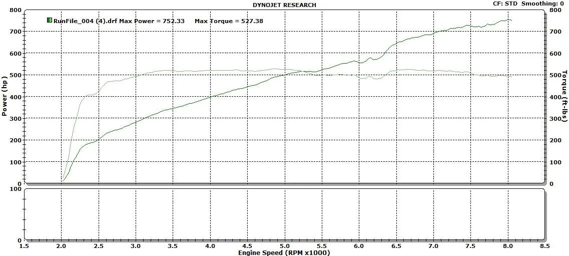

My whipple tune has a similar dip -
Hoping it’s fixed with their latest update .
Here is the dyno graph of mine . whipple tune with 3.75 pulley ,stock exhaust with cats/93 with a can of Octanium
You can see the dip in power between 5000-6000 rpm. On the log it corresponds to a dip in timing (no knock) which I don't see on street logs.

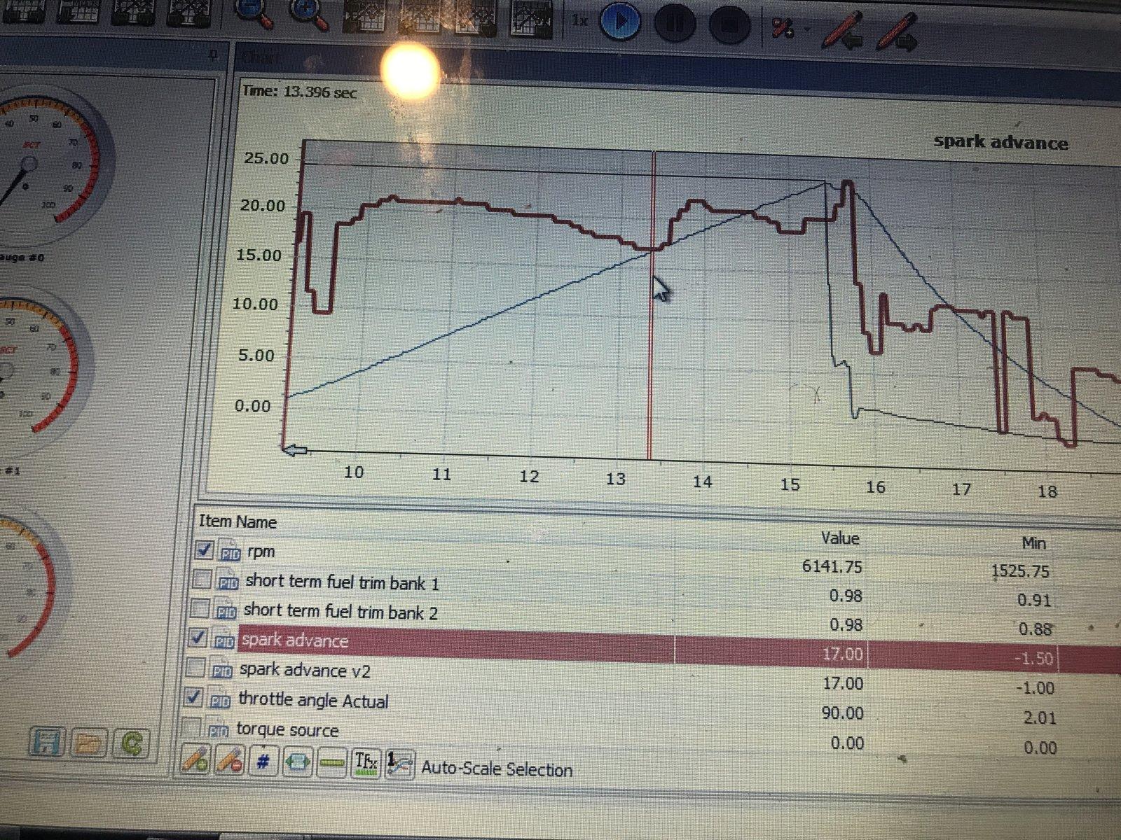

Here is apic of the timing vs rpm log
dip is easier to see on smoothed dyno graph too
