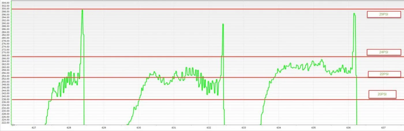

No lifting because it's an automatic. :thumbsup: I wouldn't say I'm losing 2psi through shifting either because it doesn't drop at the shift, it is just constantly bobbling between 20 - 22.5.
MASSIVE derp moment LOL! That thought didn't even cross my mind :headbonk:
That's good feedback. I'm a turbo noob and not really sure what to expect. I'm very familiar with superchargers and would expect that to be much smoother or I would be looking for belt slip, maybe a tensioner issue. With the turbo, I didn't know it should be smoother. For all I knew it might be a normal process of the ECU trying to manage the boost level and the 2.5psi was considered very good.
Your waste gate should be keeping it at the pressure demanded. It shouldn't be so choppy (At least this is my understanding of it. Mine is MUCH smoother in keeping straight boost)
I'm not sure I understand that correctly. Are you saying the spring will just help hold the boost during shifts and without the spring it will be much like the stock BPV just not leak and should be holding at a steady 22.5psi in my case? If so, then in my case, it seems the no spring option would be best since I'm not losing boost during shift.
It'll help during both, but WITH the spring it's even firmer is my understanding. But yes without the spring it should hold 22.5~ better, but since you don't have to worry about shifting nearly as much. But would make a difference when letting off the throttle and then getting back on.

Logically I'd think the opposite should happen with a binding piston spring shouldn't it? Would keep it from returning to sealed, not the other way around. Also not seeing any reason for the DV to rotate as it is a simple up/down movement. Some require free movement to spin, but I don't see why the DV+ would.
I was purely trying to deal with the DV+ to try and the get spike to calm down as it's spiking over 30 PSI.
@jbailer I believe you are probably correct on the wastegate. Mine is still stock/untouched. Could be a loose vacuum connection somewhere, or not operating correctly. What strikes me odd is that the DTC is supposed to trip at 4psi over demand.
The spring sits on top of the plunger with it's function being to reseat the plunger quickly. However, if it's bound up, it would take more pressure to crack the plunger, so the symptoms of boost spikes seems to be inline with what you found to be the culprit.
I could see that if it was bound at full length. But if stuck depressed it'd leak like hell. But I think it's safe to say the DV+ is the cause of the spike.
I'm more worried about the car over-boosting 6 PSI consistently. I'd be willing to bet swapping springs on the DV+ will at least minimize the spikes. The over boost not so much. Seems far too high for stock.

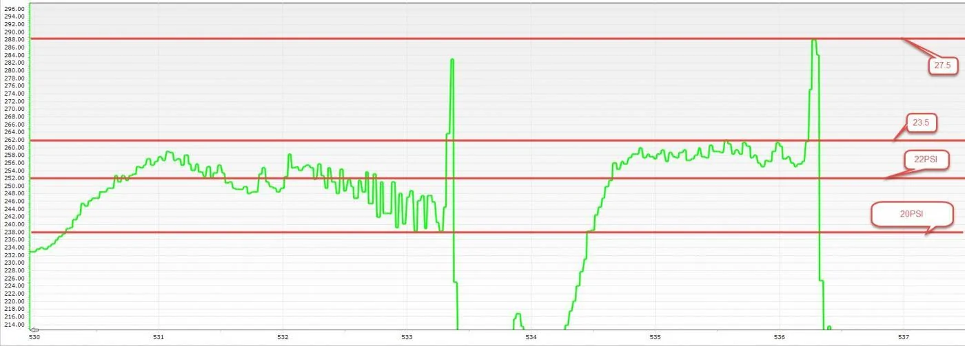

Right after I installed mine, I saw boost spikes up to 27.5. I then had my tune adjusted and have not had a problem since. It holds pressure when it's supposed to, lifts and returns without incident.

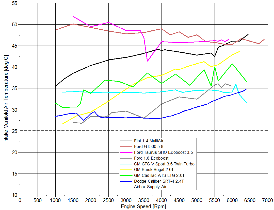

We'll agree to disagree, but I want to leave one last thing to consider.
This is compiled from SAE certification reports. 15-20 degrees C (59-68F) over ambient is pretty common across manufacturers. Dotted line is the supply air temperature, each line represents the manifold air temperatures. It doesn't have the 2.3 Ecoboost on there, but I suspect it is similar.
So when the engine is rated at a particular horsepower using the SAE witness test method, the manifold air temperature usually reflects this heat soak.

So I finally got around to returning back to stock...And who would have guessed...same exact issue. Looks almost identical, although the boost is MUCH more choppy stock. DV+ had a nice smooth line since it didn't have any issues holding boost. It's staying between 22-24 psi, but spiking up to 29 psi still. So much for how "awesome and certified" the stock BPV is. I guess the question is...Is it safe to be spiking 7 psi? I doubt an increase of 32% boost is a good thing for the life of the engine.
