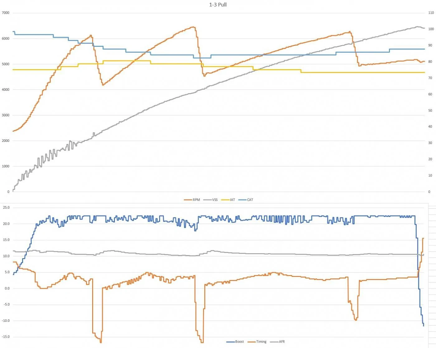

Spring is optional. I'll put mine in without the spring and give an update on how it feels. My stock BPV hold 22psi until around 5000rpm and then tapers off badly.
I have the Ford Performance tune, maybe that's the difference for me? So why would I use the spring or choose to not use it? What does it do? This is a datalog I did and shared in another thread.
Well this brings on some curiosity. How are you losing only 2 PSI through shifts? No lift shifting? Lol.
But take a good look at how "choppy" your boost line is. Constantly moving between 22.5 and 20. Looks like you're leaking to me! Look at third gear. Constantly losing and gaining boost. The stocker doesn't do a good job of holding high boost, it's flimsy plastic (I was amazed when I seen the piston they used).
Look at the smoothness of my boost (Even when it gets a little rough, it's only gaining boost, not losing). Compare it to how your boost is.
Without the spring it'll shift much more like stock, but hold your boost at higher pressure than the stock DV will. IE smoother boost. With the spring it retains more pressure upon shifting.
No lifting because it's an automatic. :thumbsup: I wouldn't say I'm losing 2psi through shifting either because it doesn't drop at the shift, it is just constantly bobbling between 20 - 22.5.
That's good feedback. I'm a turbo noob and not really sure what to expect. I'm very familiar with superchargers and would expect that to be much smoother or I would be looking for belt slip, maybe a tensioner issue. With the turbo, I didn't know it should be smoother. For all I knew it might be a normal process of the ECU trying to manage the boost level and the 2.5psi was considered very good.
I'm not sure I understand that correctly. Are you saying the spring will just help hold the boost during shifts and without the spring it will be much like the stock BPV just not leak and should be holding at a steady 22.5psi in my case? If so, then in my case, it seems the no spring option would be best since I'm not losing boost during shift.
