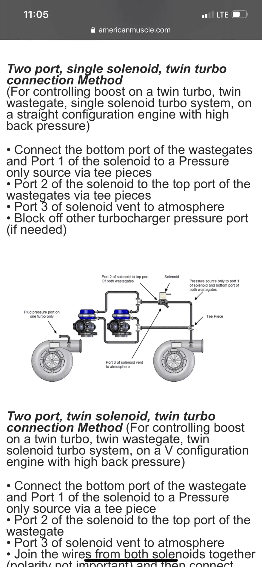

Hey guys,
I was wondering how my fellow twin turbo guys plumbed the boost controller on a 3 port solenoid. I see there’s several options for this here’s what I’m considering
