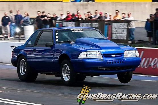

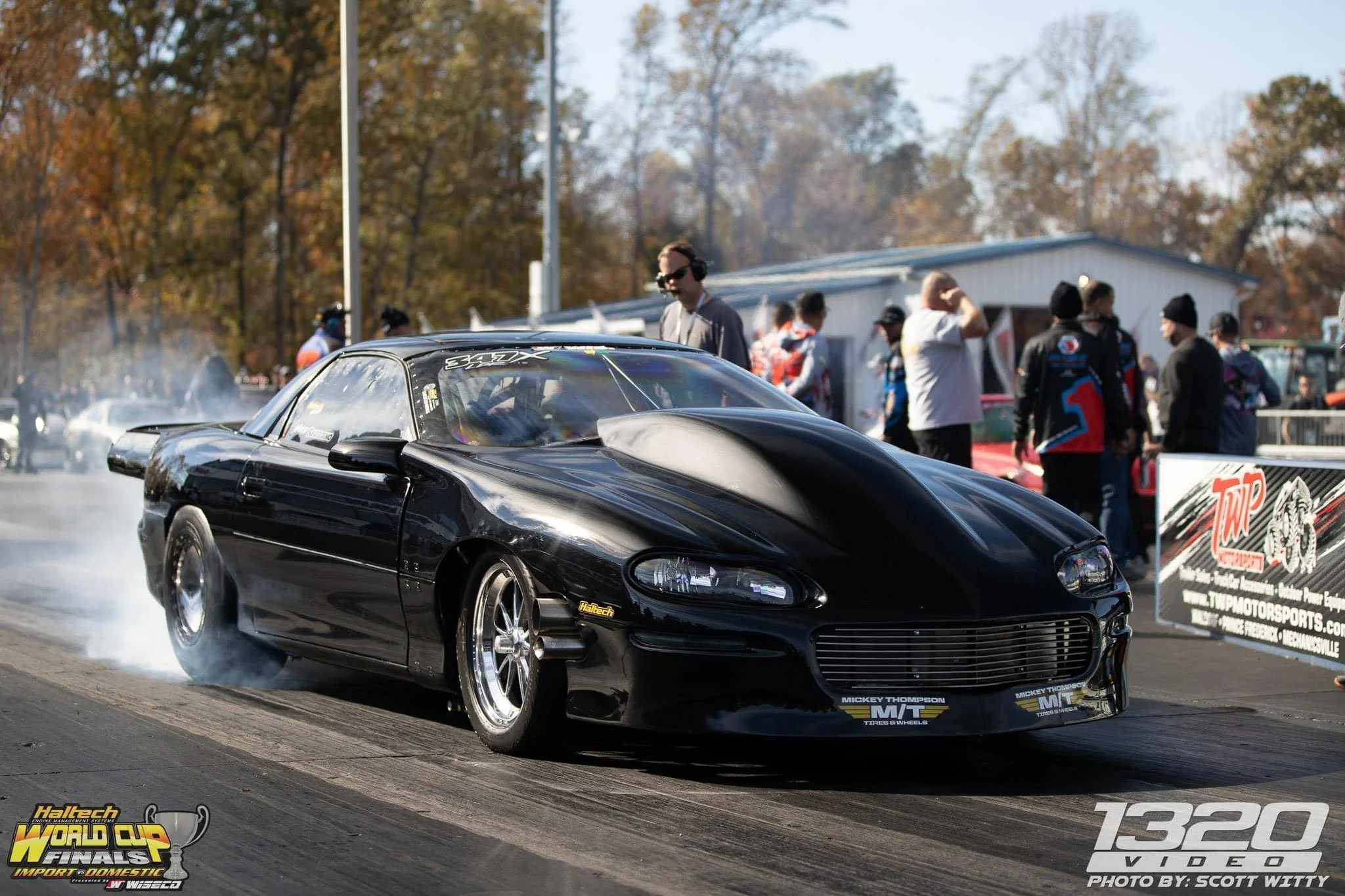

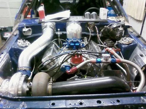

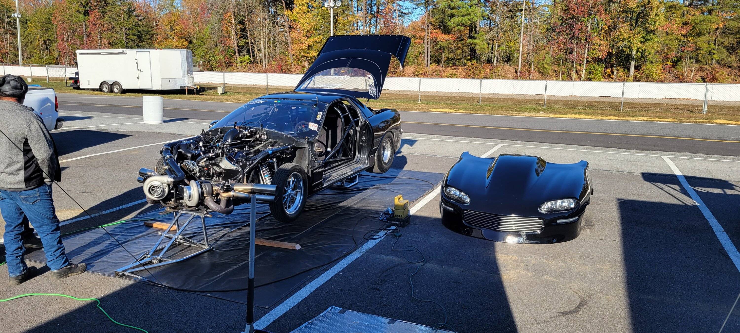

My boost leash shows what dome pressure I am putting on the gates as well as the boost pressure. You will have to play with it as it is not a linear curve. 5 psi on the dome may get you 8psi of boost. Adding an additional 5psi of dome pressure most likely will not result in an additional 5psi of boost. Every combination is different and you will need to determine how much dome pressure is needed to get to your desired boost level. The more boost you want the higher the dome pressure will need to be. Back pressure will become a factor at some point. You may need 30 psi on the dome to see 20psi of boost. I would set the regulator significantly higher than your desired level of boost.

My old fox body... And my buddies current Camaro. Just didn't want you to think I was guessing. Lol
