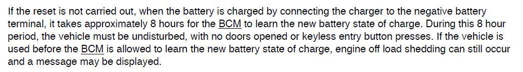

That or just let it sit for 8 hours…resets itself 😉
That will reset the battery State of Charge, but no the battery days in service, which is one of the parameters the BMS uses.
interesting…I have replaced my battery twice (shes 10 yers old next year)never done the reset, just plug in the battery tender and walk away 😉
