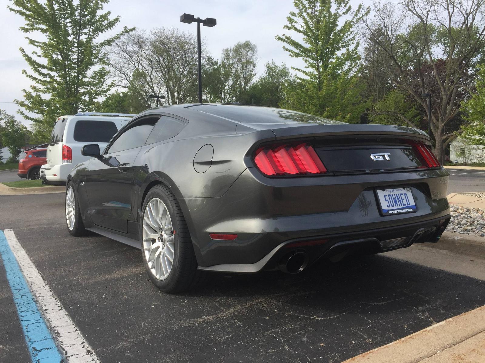

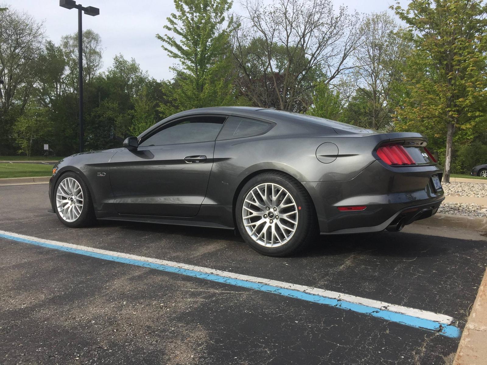

My SP080s seem a little more even front-to-rear, but I seem to recall thinking the same thing when they were first installed, so maybe just a little mileage and settling and you'll be more evened out.
I chose the sp080's because the lesser rear drop would hopefully hide the rear poke from the wheel spacers.
Getting my sp080 installed today with 23/25mm spacers will post my results
FWIW, I'm running the exact same spacer setup, and on PP wheels, factory spec alignment (dialed in really tight) there's almost zero "poke". Looks pretty fantastic!
