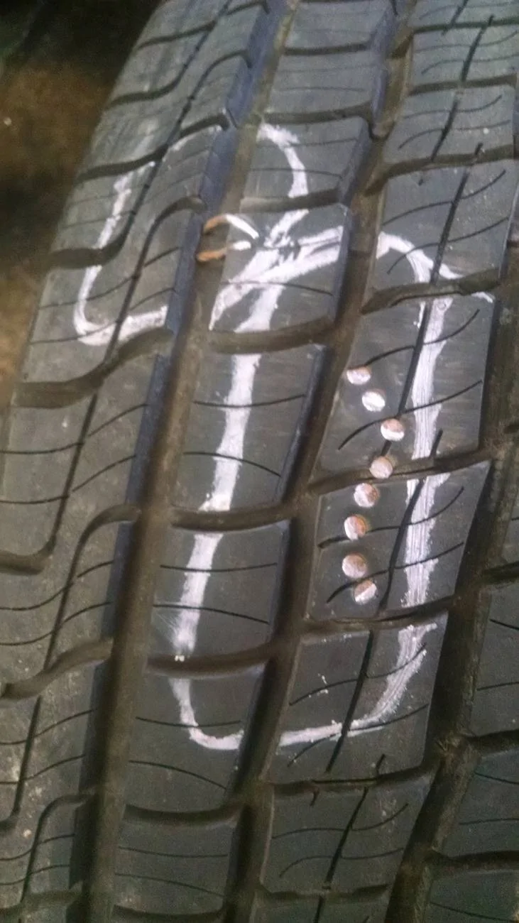

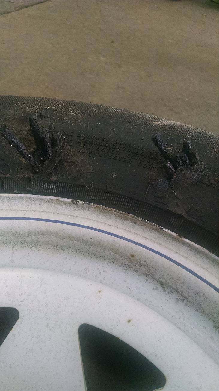

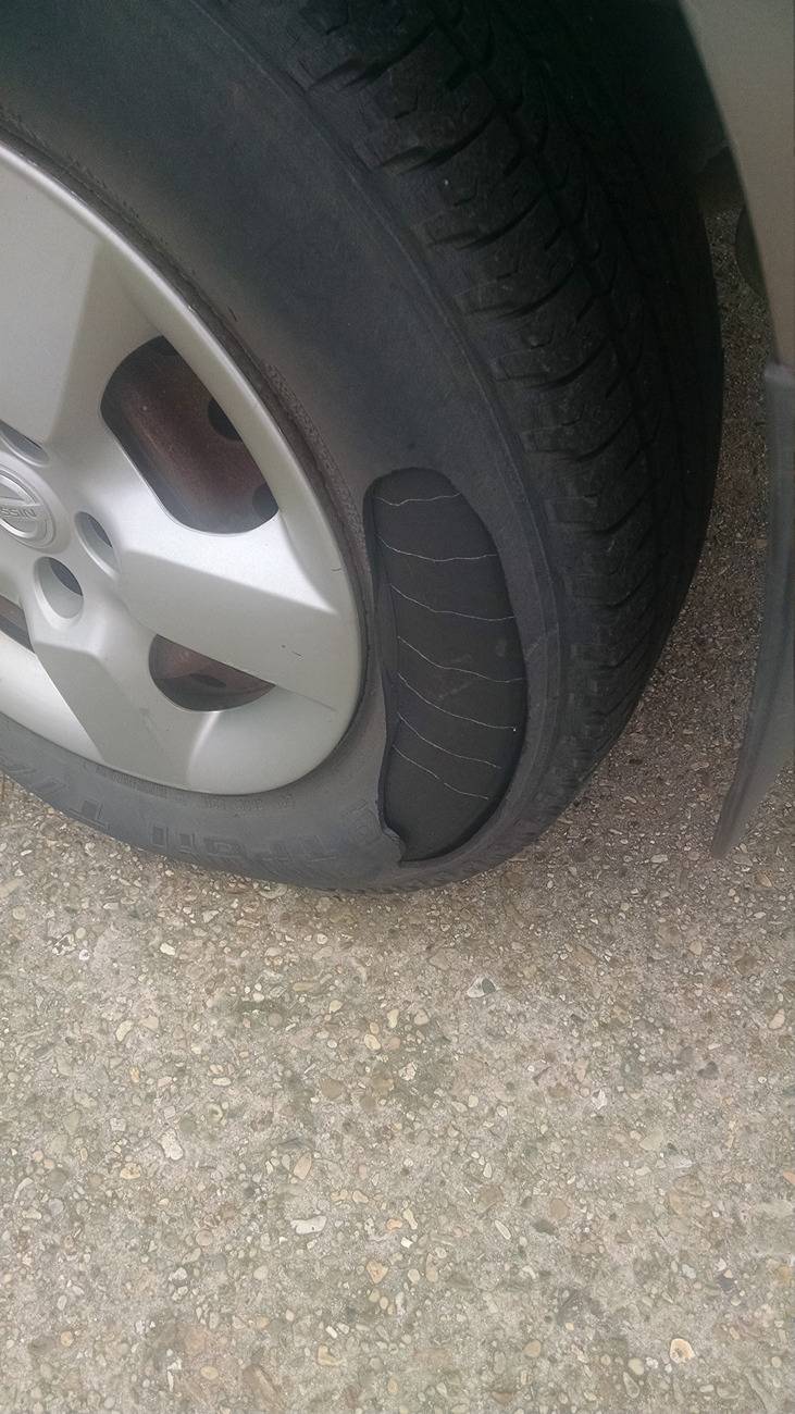

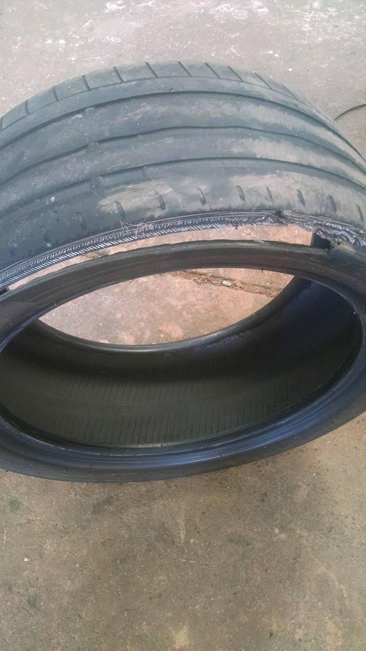

The things you see in the tire business...the last one if my favorite. The customer drove their BMW in on these (they are, after all, run flats) with their two kids in the car. The other rear tire was in the same condition, and had been for at least a week...
