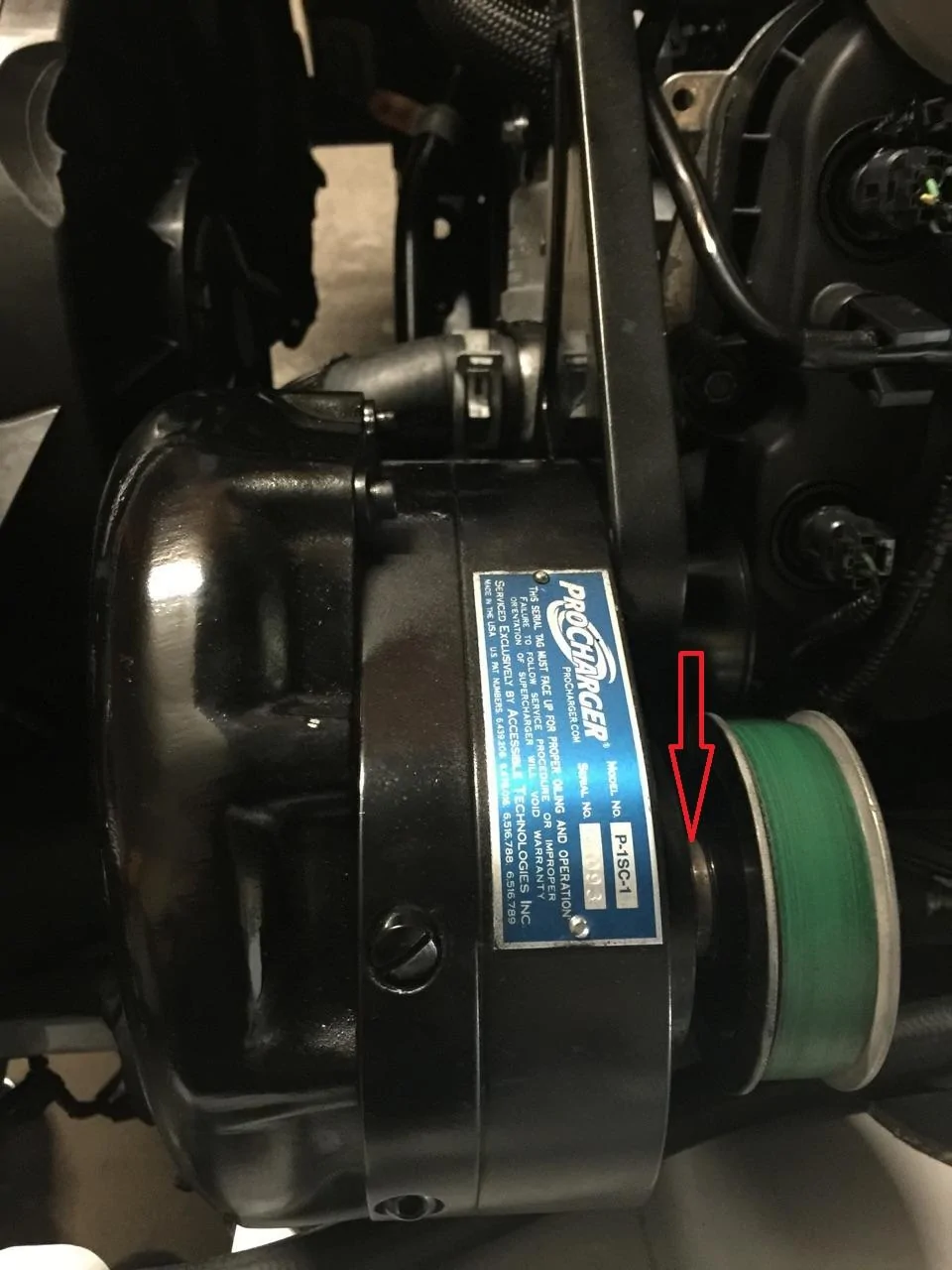

Need some help. Got my ProCharger stage 2 all put on and running, but it either wants to spit the belt, or rip the first rib off the belt. In the pic you can see it riding up the right side of the pulley. The crankshaft and all other pulleys line up great. It’s like the blower needs moved toward the rear of the car a little. How do I go about adjusting it? Or does it need a shim under the blower pulley?

There should be a .130" shim between the drive pulley and head unit.

There was a .150” shim, but I made a .215” shim to get it lined up. Long night googling the world. Lol

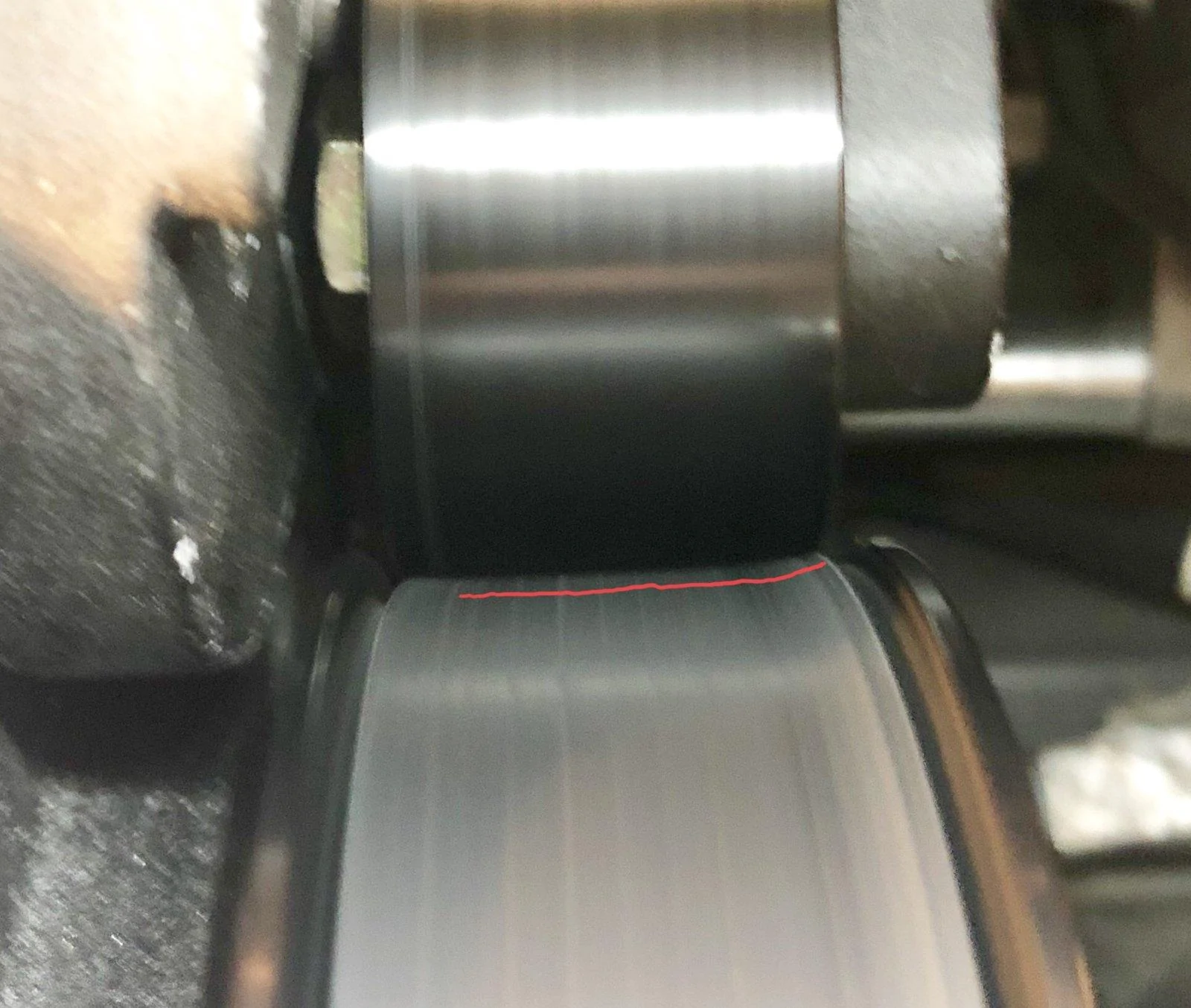

Here is the pic. Yeah .150 sounds right...i had to go to hardware store and all i could find was.130". I had the notorious belt chirp. The shim took care of it.
