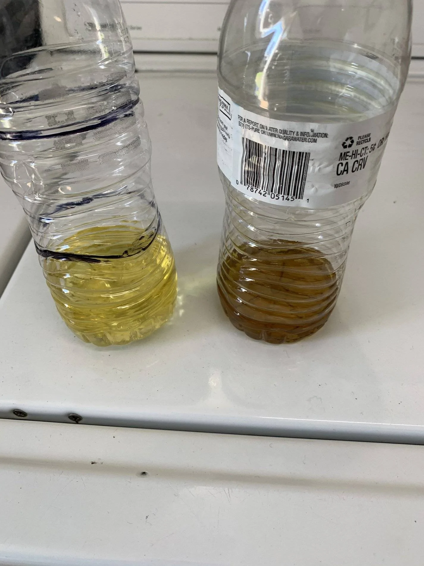

I used the power bleeder, it seemed to work pretty well i dumped a liter and a half in it pretty happy with the results

Well thats true! I pumped 6oz thru each nipple which i think should be enough just by math stands that about liter and a half,
