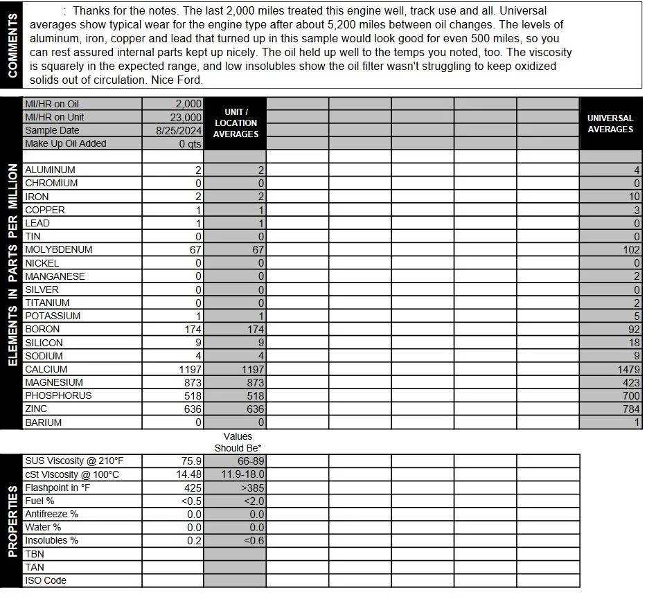

here's a blackstone report with the motorcraft 5w-50 from an hour of time at road america where my oil temps were 260-280. i only 2000 miles on this sample, with about 800 miles of that coming from that weekend alone.
