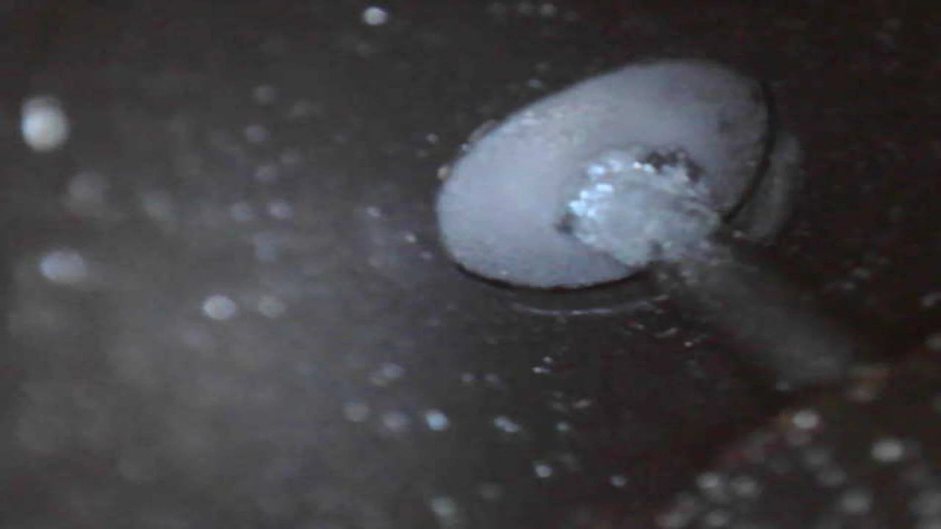

I pulled the intake manifold again and took a look at the valves. Not much change since the last look. There are some deposits, but not to the point where it affects performance. I'll check again at 60,000 miles.
Stock engine, running Mobil One, oil is changed every 5,000 miles. I don't abuse the car, but I don't baby it, either! The picture is typical of what I've found.

It's good you are sharing and documenting this because in a way - it proves that running an EB S550 w/o a CC is perfectly fine, as long as normal maintenance procedures are also being followed.
