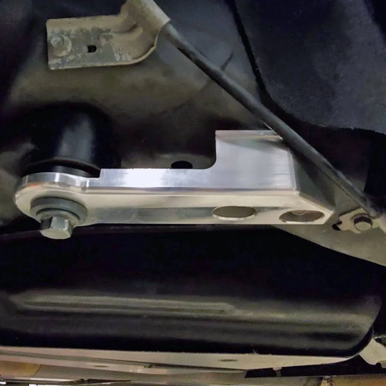

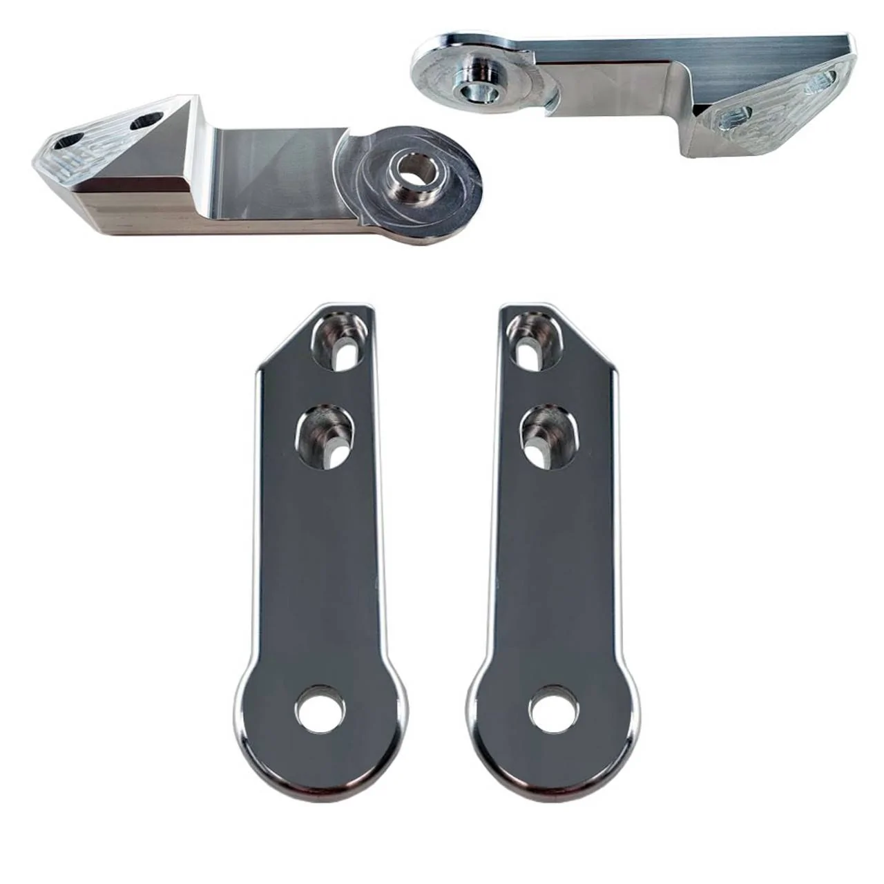

I bought them and tried installing them to use in conjunction with Steeda subframe braces but that won't work because the braces fit with the stock bracket in place. In addition, if you have alignment tubes you'll have to cut them down in order for the UPR brace to fit flush to the chassis as the short tube on the rounded end goes inside the chassis bolt hole. I still have them but they're just sitting in my work bench so I couldn't give you real world experience.
