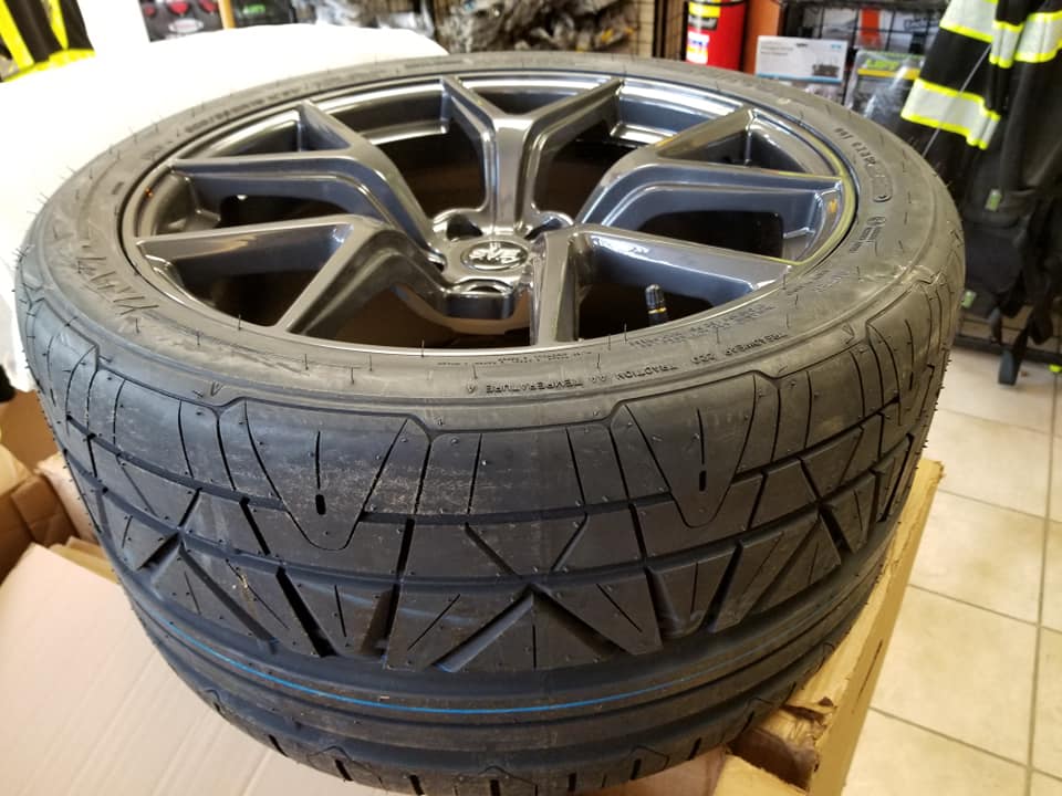

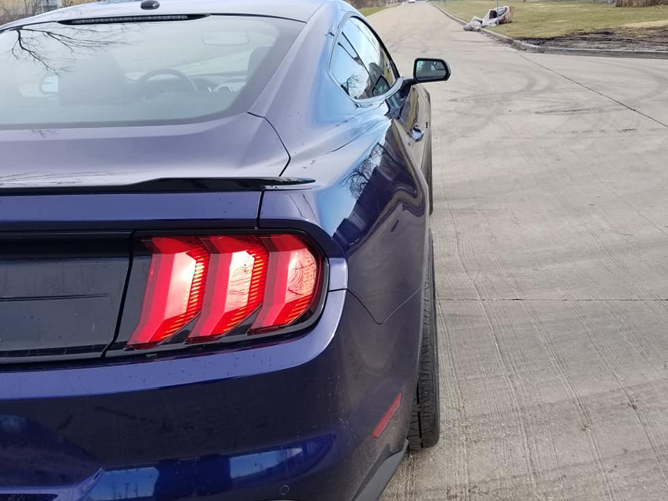

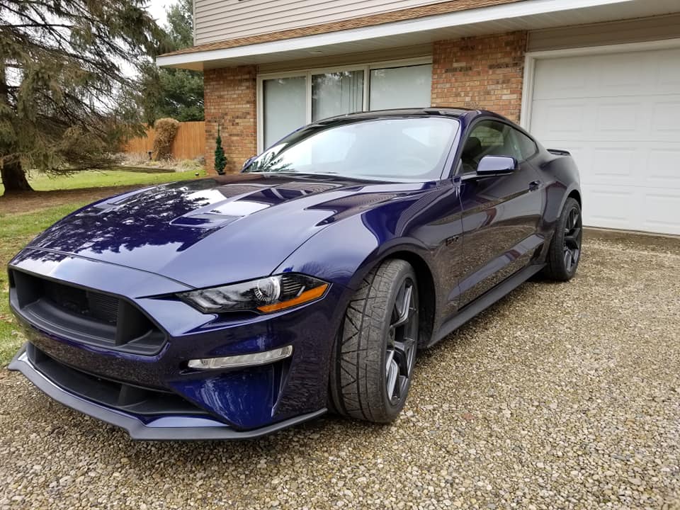

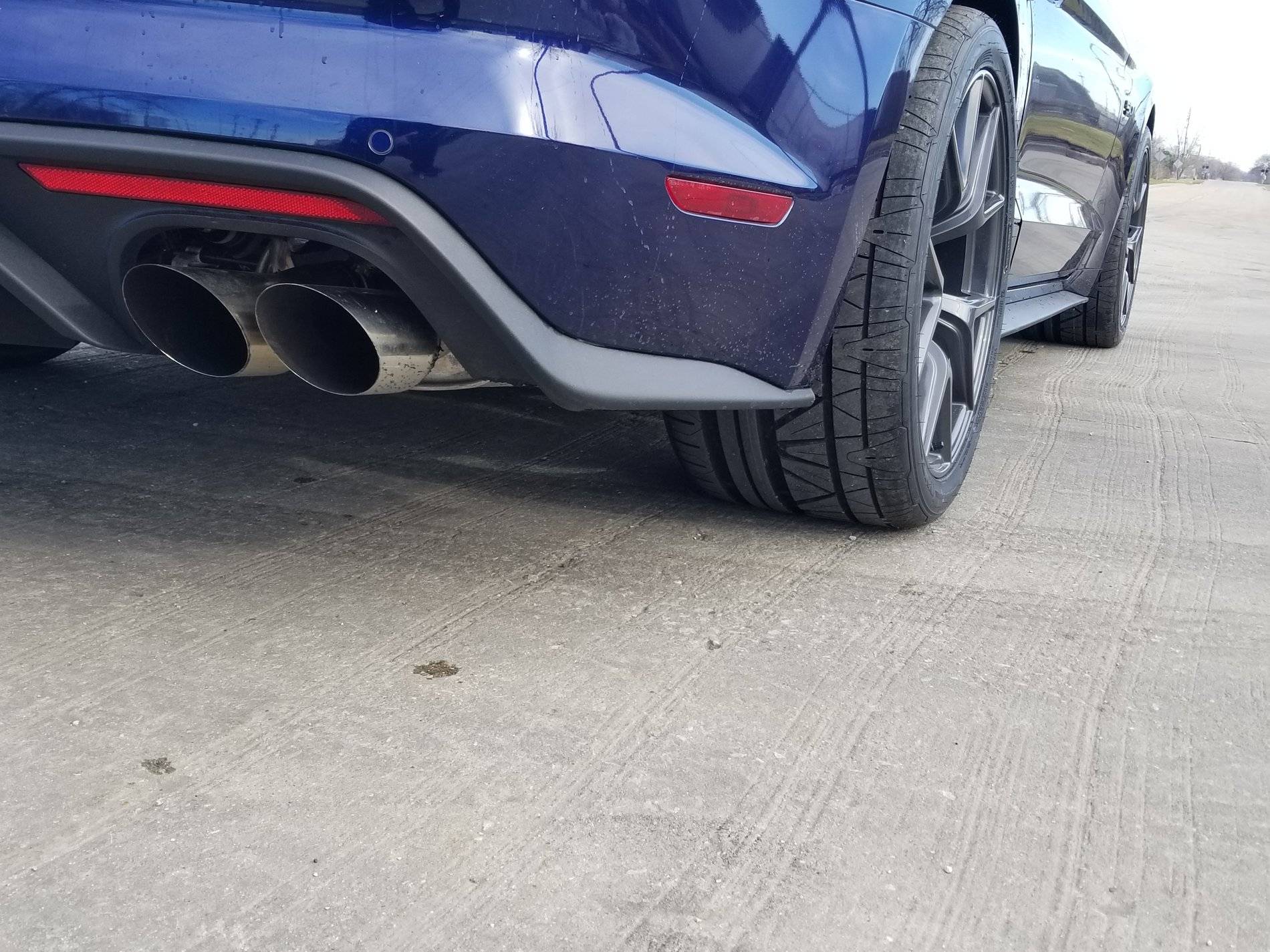

Widest without breaking the bank with special wheels, is really a 325 rear (on 19" wheels) when using 19X11" wheels with 50-56 mm offset. I have 325's on mine.
Thanks alot for the reply. And this would be the same for a 2017 mustang?
