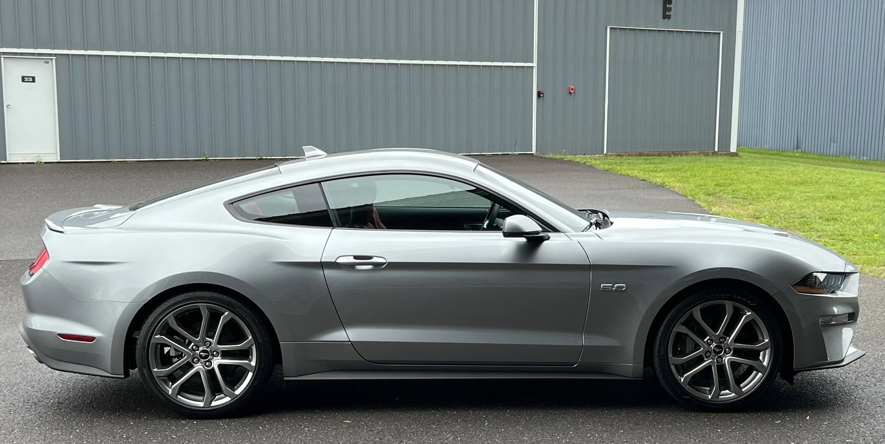

Huge shout out to @tj@steeda and the crew at Steeda. Tim and crew was incredibly helpful with parts selection and one couldn't ask for higher quality components. I just did the rear of my '21 GT with:
  • Adjustable Differential Bushing Insert System
  • SubFrame Alignment Kit
  • SubFrame Bushing Support System
  • Jacking Rails
  • Rear IRS SubFrame Brace
  • Rear Adjustable (1") Anti-Sway Bar
  • Billet Anti-Sway Bar Mounts
  • Adjustable End Links
Took my time on Monday and from start to finish I spent eight hours with my youngest Son helping out. Got the car up on four jack stands, lowered the rear subframe and went at it. Now, for the front end, which I'll knock out in a week or so. I have the 1 3/8" Front Anti-Sway Bar with Billet Mounts and Adjustable Camber Plates. I was planning to use the Ford Performance Springs from their Magneride kit, but I'll order the Steeda Dual Rate Springs instead.
Now, for the results....The difference the above components made is nothing short of incredible; the rear of the car is definitely more planted. I used the 90 Durometer Differential Bushing and although I do hear very slight differential whine after coming off the throttle and slowing down, there's absolutely no vibration....I don't care about the whine.
