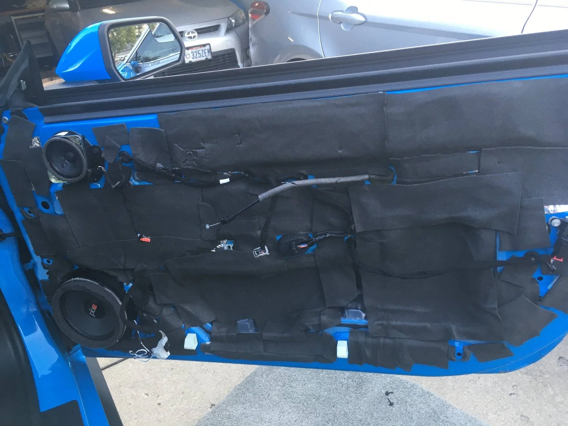

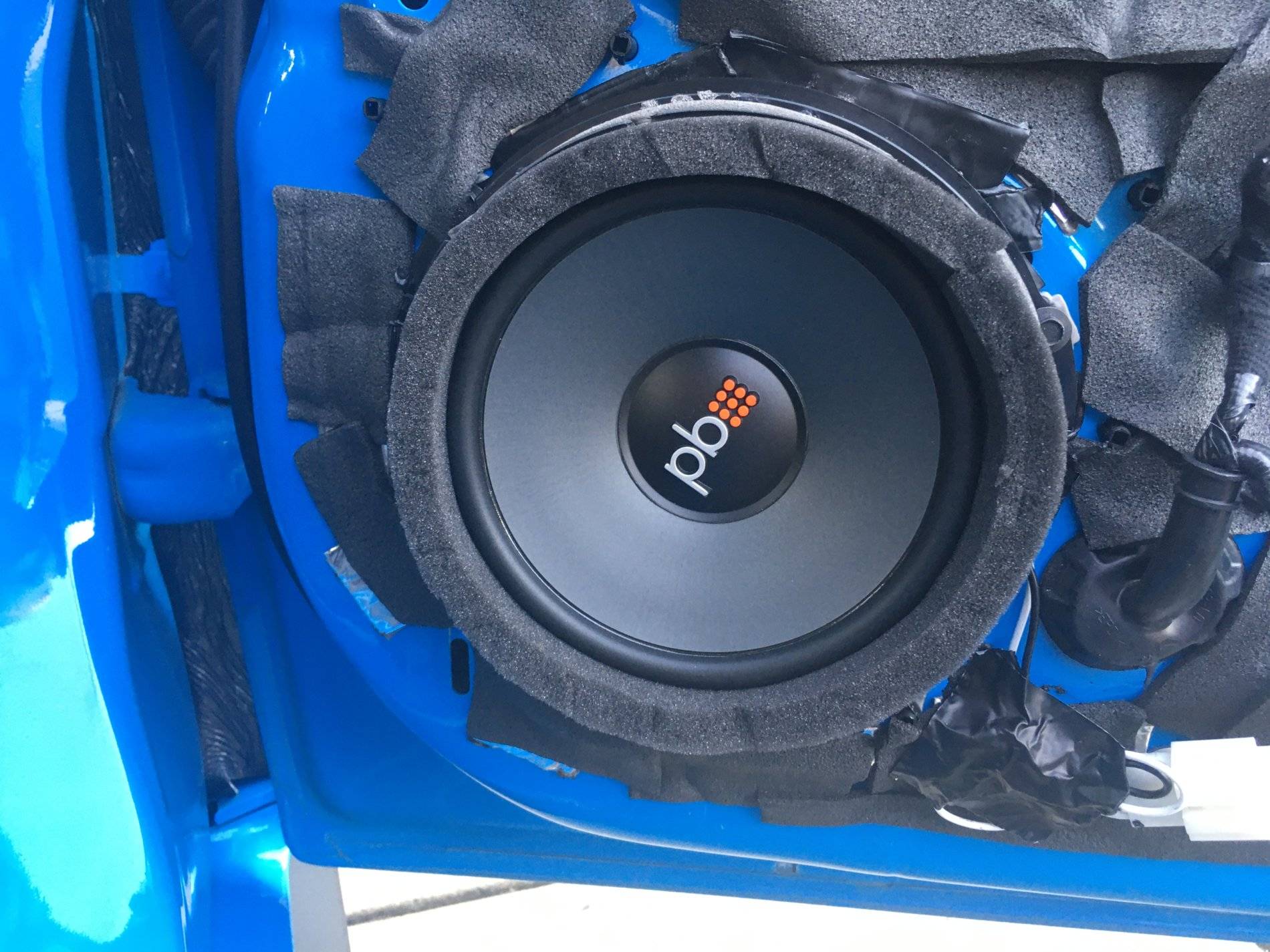

9 speaker. But my car had 4ohm 6.5’s in door.
I put an amp from 12 speaker car in mine, that car had 6.5 2ohm speakers
Only 2ohm replacements I could find and that wasn’t coaxial was powerbass.
Tossed it in my door. Sounds excellent, clean, real clean. Real loud too. No distortion.
Going from crappy 6.5 4ohm to nicer quality 6.5 2ohm it doubled its volume.
I also used stinger foam rings and such.

Ignore my door. It worked Lol. No rattles of any kind.
