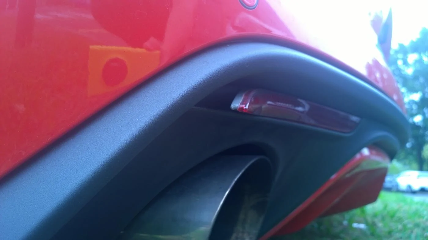

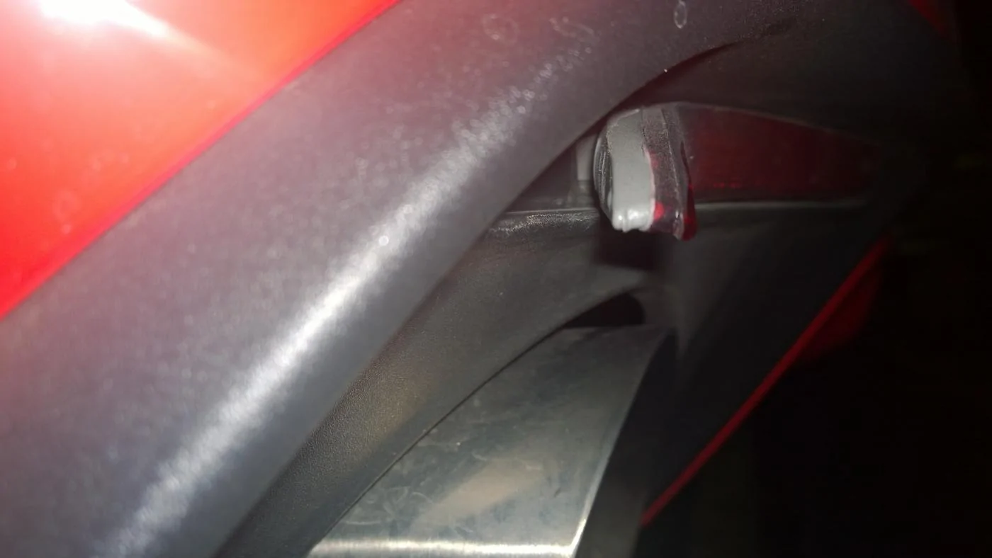

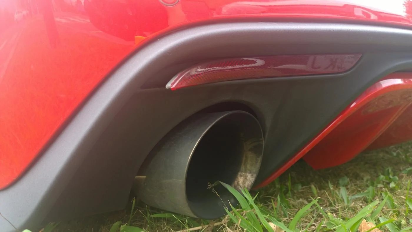

Anyone with this problem? I installed Solo exhaust system about one month ago and yesterday, after a 400km trip, i discovered this:
In the last one you can see how exhaust tips are installed.

Seems to happen with some after market exhaust systems. Too much heat gets to the reflectors and they can't take it.

Thread revival. I am having the same issue with my rear valence reflectors. It seems that they cannot take the extreme heat of the MBRP Race exhausts. My reflectors have melted to the point of distortion, so I will have to replace them and pull the exhaust tips further out.
