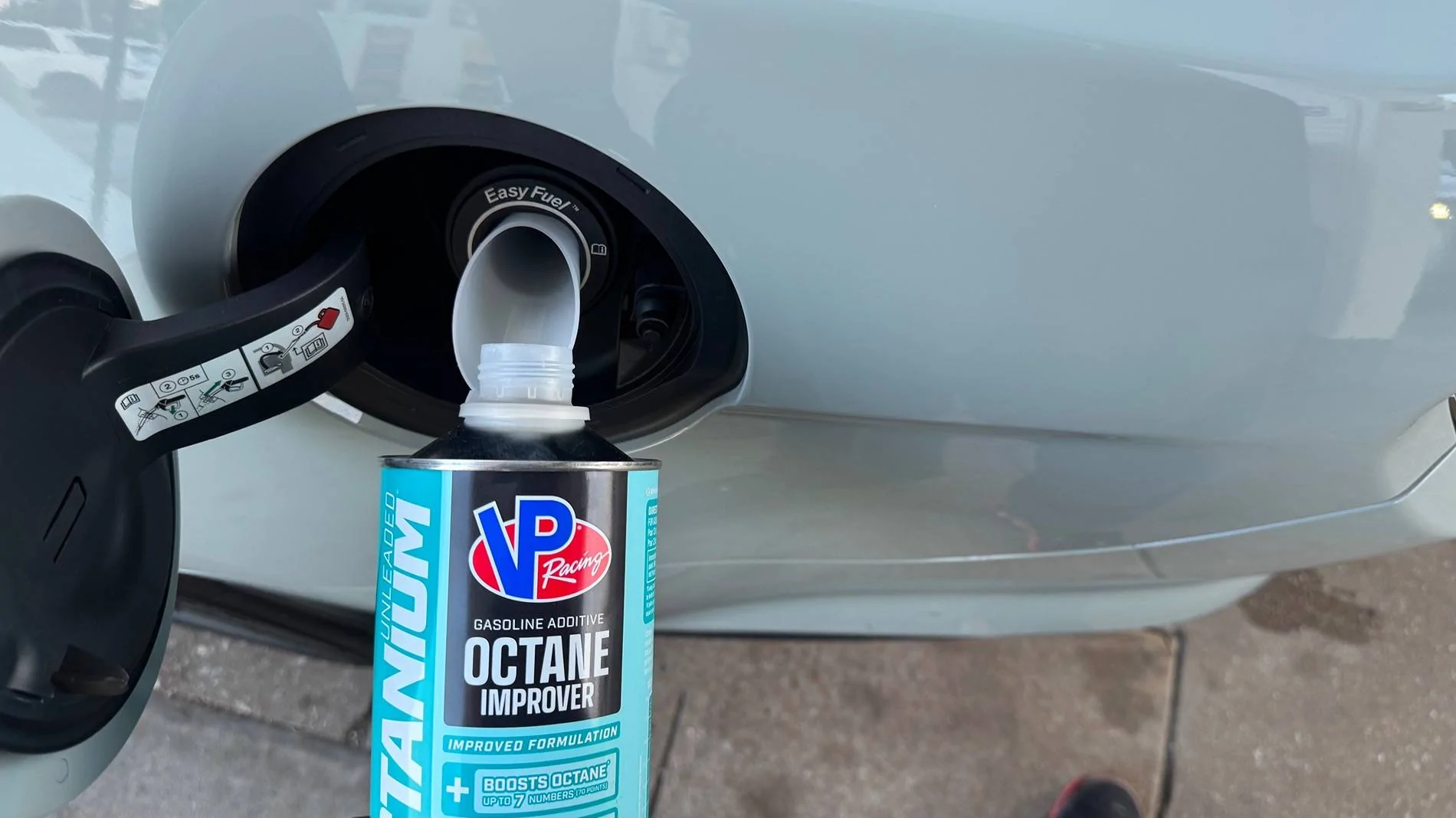

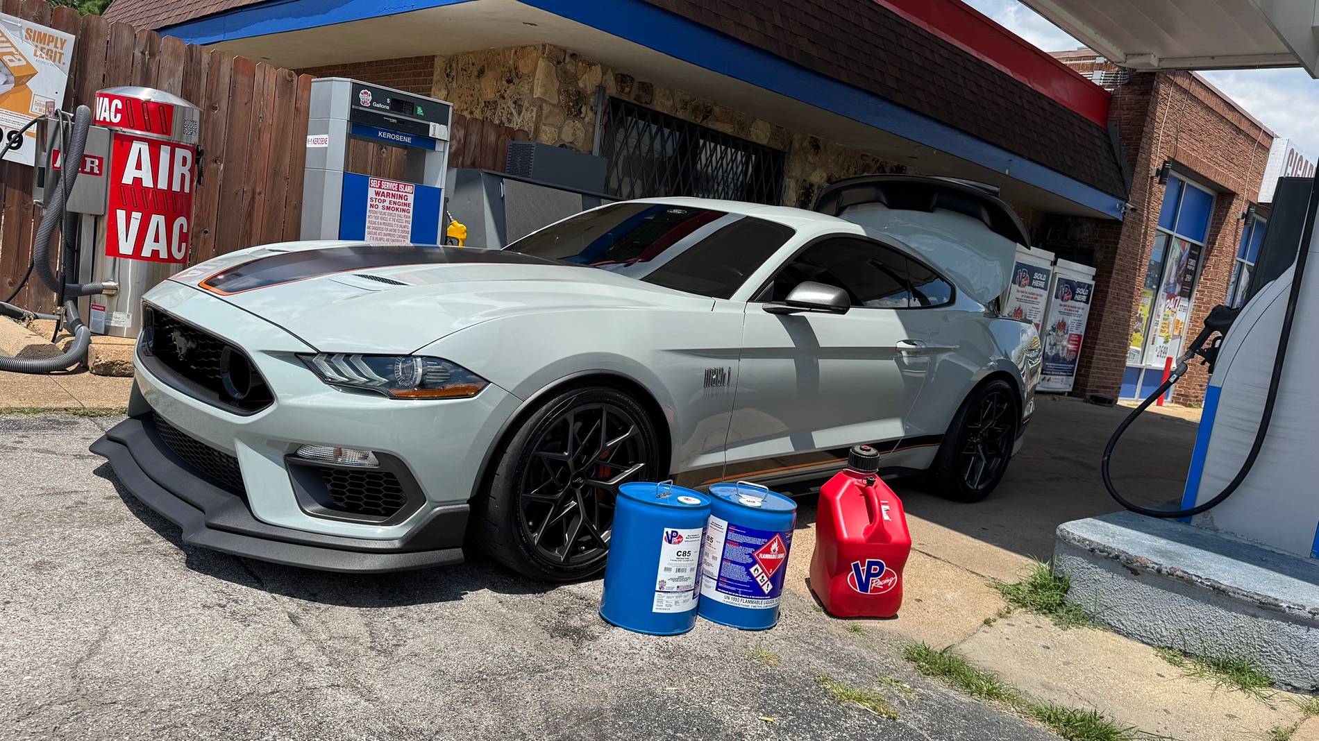

All ways Premium gas. Always keep a can of octane booster from companies like VP Racing just in case.
I’m so anal that is literally took a race jug to the Shell gas station. Filled up 2 gallons what came out the pump (which is whatever the last person pumped, 87).
Put the VP Racing Octane Booster in, then added 10 gallons of 93 before the car went to the shop for the supercharger and dyno tune.
I take every precaution I can think of. Going to E85
