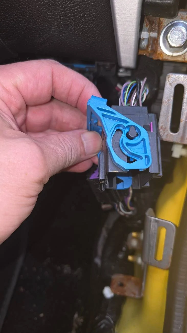

To the right of the BCM there's a big multipin connector...

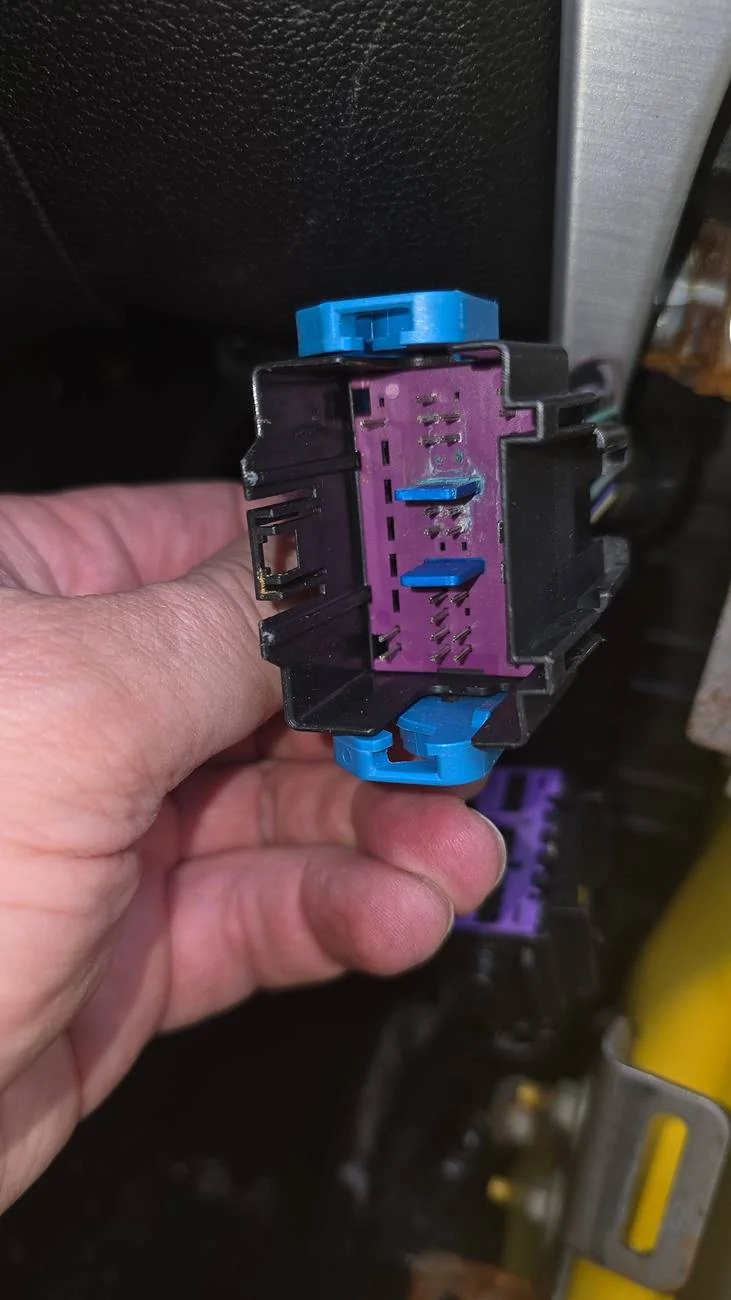

This was right underneath the rusty bracket. When I disconnected it I could see that at least two of the pins had corroded through and snapped off...
I thought about sourcing a new connector block (and still might) but for now I just cleaned up the rest of the pins and sockets as best I could and used a couple of scotch blocks to run bypass wires from one side of the connector to the other.
Reconnected the battery and hey presto, everything is back to normal.
I've taped a plastic bag around that connector to keep it from getting wet again and at some point I'll have a go at locating and fixing the leaky seal.
