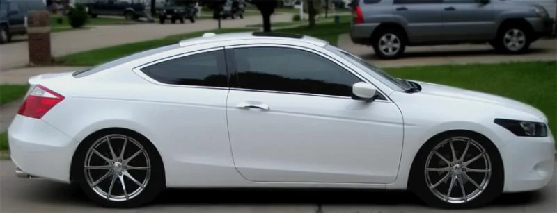

I had the BC coilovers on my 08 Accord. Although they looked nice, the ride was horrible, and after about a year I got some weird squeaking noise from 1 of the rear coils. Only happened if I bounced the trunk up and down with my hands. If I had to do it all over again I wouldn't make the same purchase.
Here's what it looked like though! :D
