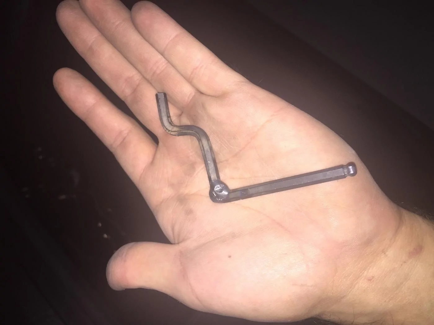

I had a tool welded with 2 90s on it
Works once you take the adjustment knob out, still a bitch though.
